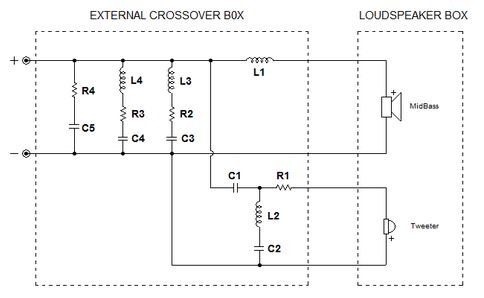

Joe Rasmussen Usher S520 "Current Compatible" Crossover
What I'm getting from this write-up is that what's being touted is the unremarkable result that a constant impedance load (wrt frequency) will have a constant voltage across it irrespective of the source impedance. IOW, it follows Ohm and Kirchoff.
There's a marketing disadvantage, though- reduced sensitivity to amplifier output impedance and drive capability. Why is that a disadvantage since it's a technical advantage? Take the Wilson speakers, for example. The impedance curve swings mightily and dips down to brutally low levels. So the reviewer will note that the Wilson is far more revealing of amplifier differences than Joe's speaker!

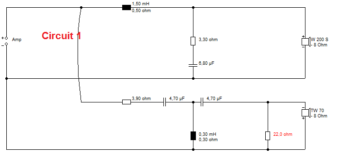

I'm with you on this flat impedance thing, Joe.

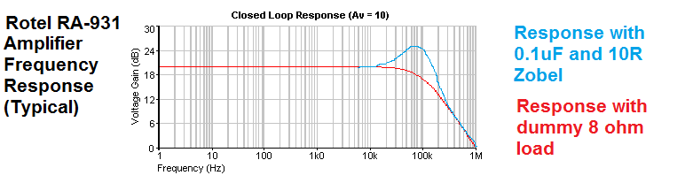

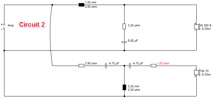

I was shocked how bad this circuit sounded with a regular transistor amp:
And amazed how much better this one sounded:
http://www.diyaudio.com/forums/multi-way/284038-crossover-sounds-better.html
The only real difference is the 22R shunt tweeter circuit has a better, lower ultrasonic impedance, resulting in a much better, cleaner top end. Clearly transistor amps are sensitive to this.

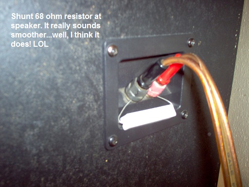

I then speculated that this is why a simple 68R resistor applied before the filter changes the sound for the better.
But truthfully, because I know quite a lot about amplifiers and cables, and their limitations at high frequency, this doesn't surprise me. Every time a class AB amp crosses 0V, there is a blip of distortion released, so even ultrasonics become audible as noise.
Your own approach of adding shunt components before the filter is evidently a useful one. TBH, I never quite understand why you use an overly deep undamped tweeter Fs notch, an LC rather than an LCR. You can overdo it, no? The original Usher design appears to have a rising impedance into the ultrasonics, and this is a bad thing, IMO.

But I'll make a prediction that you can test. If you have a circuit like this that has no shunt path to Earth at high frequency, because coils and drivers go open-circuit, it will sound better with a Zobel of, say 7.5R and 1uF across the speaker terminals, or maybe 22R.
This is part of what Joe is doing. He's also equalising the typical omega 2kHz peak and the bass peak. Less of a worry IMO, but hey, it probably does something.

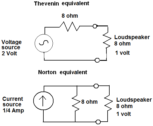

Final thought, it's clear that Thevenin's Theorum is in part what is at play here. Following TT we can circumvent filter Q's because if a response is for example a 2nd order Butterworth and enforcing rules of TT, it can lock in the Q because of the simple fact, the response curve of a 2nd order filter is not violated. It's always a Butterworth. Same goes for crossovers, the behaviour is the same.
As Morris Swift, one of the "serious guys" down here has asked "what is happening to the Qe of the driver?"
A very good question. The electrical Q is eroded proportionally by the same change percentage wise as the DCR of the VC. Yet it can be circumvented and still be compatible with T-S because SoundEasy's maths is based solidly on that work.
But Steve, what you did was lowering the tweeter sensitivity wrt the rest of the system. Of course you heard a difference, duh!
There's no need to invoke a very unlikely 'transistor amps are sensitive to this' - it is a change in the speaker tonal response and you would hear it with ANY amplifier that has a reasonable flat response.
(Clearly if the amp falls off at 10kHz there's not much coming out of the tweeter and not much you can do at the tweeter).

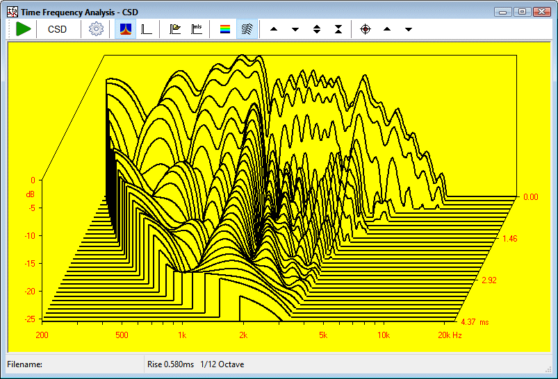

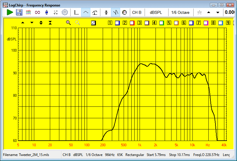

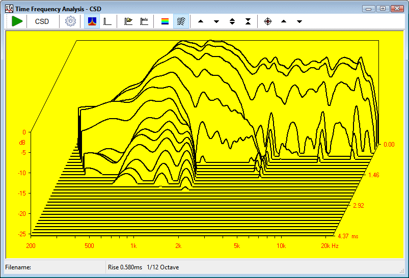

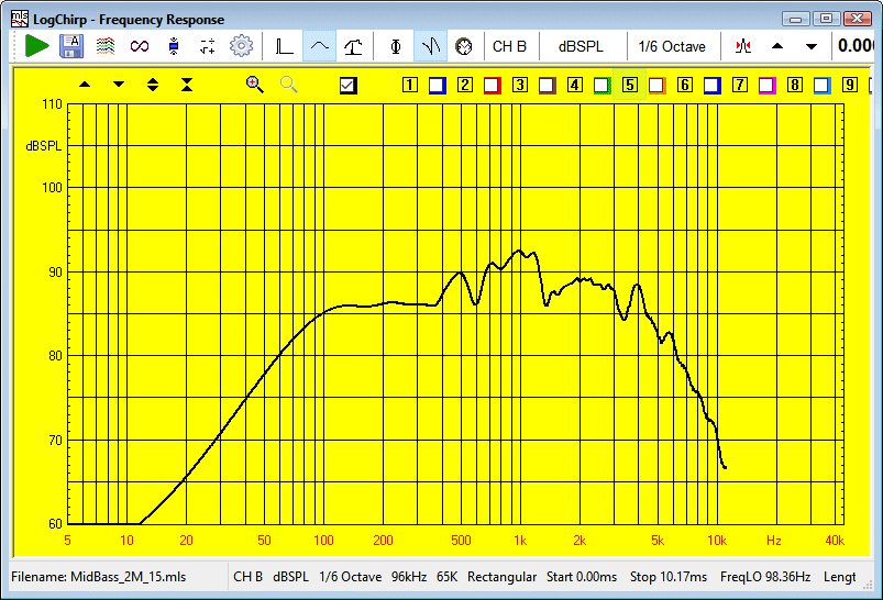

Could you post the raw driver responses, and CSD's of the post-modified system if you have them?
Thanks,
Erik
Yes, certainly, but RAW drivers only.
Below are all taken at two Metres and 15 degrees off axis.
MidBass:
As expected for a small driver on a small baffle, diffraction loss is quite high in frequency and then emphasised by a peak around 1Khz and 1.5KHz trough.
MidBass CSD:
Tweeter:
Tweeter CSD:
