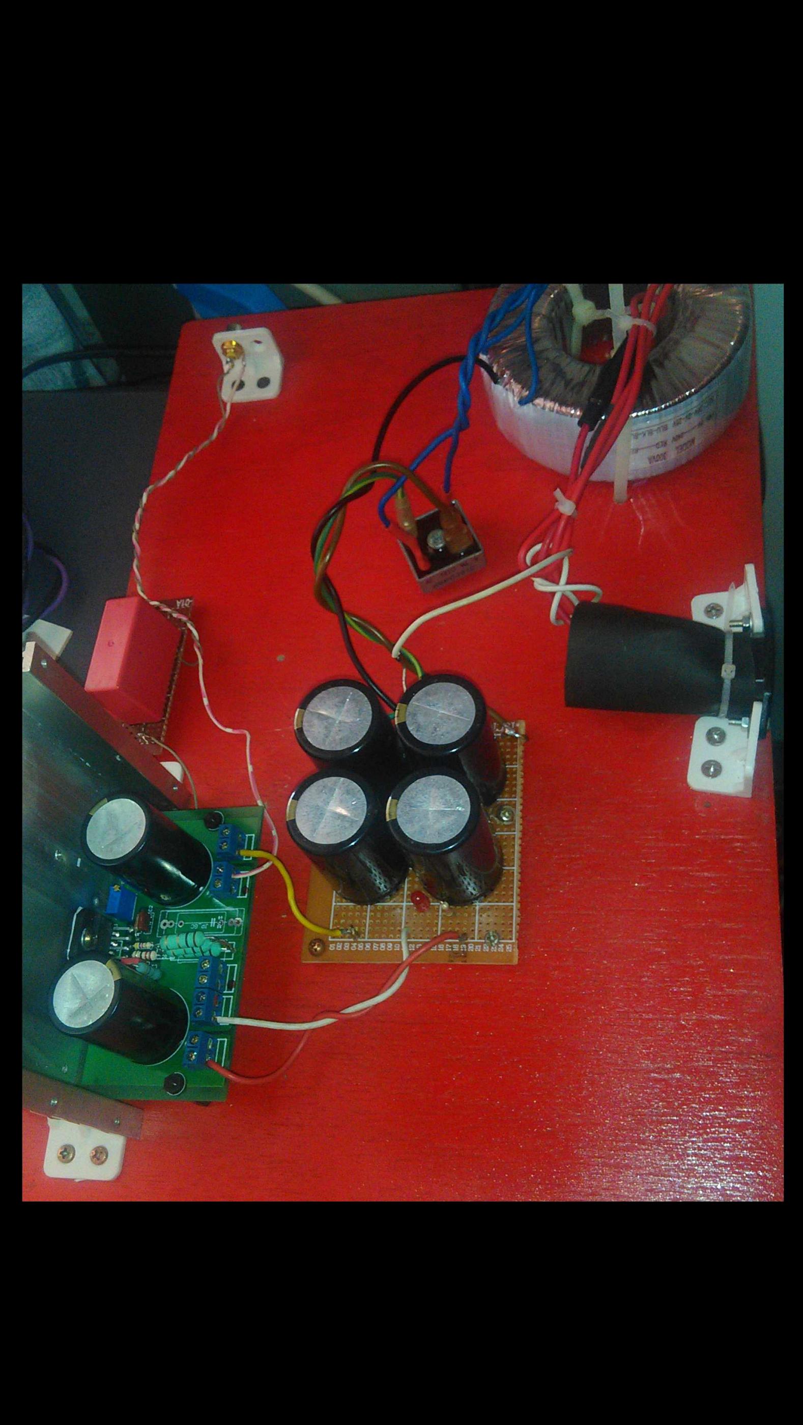

Hi Joe, I have just built a dead bug version of your amp and is just about to fire it up. Before I do that I want to know if there is a way to protect the amp from releasing magic smoke should the speaker cables are accidentally disconnected from the amp? (I think you have answered a similar question but for the life of me I can't remember where I read it). IIRC, I can put a high wattage power resistor across the output terminals, so the amp sees it as a load?

Can I use fast blow fuse to protect speaker. Will a 500 ma fuse do for my speaker rated for 30W and a +/- 34 V on the amp ?
If you modify a 'standard' dc protection circuit so just the fast shutoff section on 'power down' disconnects the output relay, that'll do the job okay - could possibly change it to switch the amp's output to a power resistor as a 'standby' or 'mute' option
Why you're getting the problem in the first place needs some further investigation - I'd suggest you look at the raw power supply grounding scheme ...
On the early versions of the gain clones, it was found that the power supply caps next to the amp chip were included as the primary ground connection and the raw supply was fed to the amp board using separate ground wires for each '+' and '-' rail (4 wires from raw supply) that also meant that the single bridge and centre tapped secondary winding will possibly need to be altered.
Something else you may want to have a look at, it seems there's a white wire going from the input mains socket to the raw power supply, presumably connected to the black centre tap on the transformer secondary? (It looks like it's connected to the brown '+'ire from the block bridge in the photo)
You may find that if you actually connect this to the 0 volt on the amp's ground point, the amp will behave itself a bit better - possibly 'float' the amp's ground points from the chassis ground via a thermistor, or resistor, cap, diode circuit or other method - often brings improvements ...
Speaker fuse won't be much help to protect the driver from o/p dc offset voltages on amplifier 'shut-down' - just too slow to blow and possibly cause audible sound degradation on transients and/or loud passages with the Alpair 12P driver
Incidently, where did the pcb come from - it looks to be a specific design for Joe's current o/p circuit?
If nothing else, this maybe food for thought ...

The white wire is connected to ac mains ground. the other end is connected to the zero volt line and the transformer centre tap via a 20 R thermistor.
I think I will just place a switch at the amp output to open the speaker circuit before I switch off the ac mains ,
it is rather strange that I also experience a similar hum from another current amp with Lm 1875 !!
the hum occurs even when I short the input pins <

Yes. the pcb is specifically designed for Joe circuit. I bought from a fellow member who has some spares.

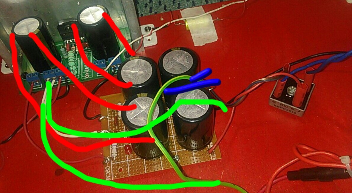

All over the writings of both the lm3875 and the 3886, there's the same problem of amp 'hum' mentioned and nearly all of it's related to the power supply ground system - with this version of Joe's, you've made it more complicated than his circuit diagram by adding the extra capacitors next to the amp chip and this has created 2 sources of energy for the amp plus 2 separate places for the return power to go to after doing it's job of moving the voice coil, ie the ground of the caps next to the amp, and the ground connected to the raw supply caps - this is why it's clear that the capacitors are actually in the path of the power signal and hence, have a direct effect on the sound of any amp - this one's no different except you have 2, instead of 1.
I suggest you have a look at the Peter Daniels 'gainclone' website for a better explanation on how the ground system for these chip amps is so critical to their behaviour and why Joe has emphasized this in the circuit layout
Now, interestingly, the Brian GT power supply doesn't use the 4 wire method of connecting the power supply to the amps pcb BUT does concentrate all the ground connections on the main ground point on the amp itself - so you don't necessarily need to rebuild the whole raw power supply but possibly just need to alter the way your ground wires are connected -
I think this will solve your 'hum' problem okay but not so sure about the 'shutoff' voltage offset - I vaguely remember the '75 chip is more prone to this than the '86, but not sure what the answer is - pretty sure this has happened before so it probably isn't anything new.

Oh yes, meant to add - try reducing the caps size next to the amp chips - maybe try some of the 100uF Nichicon BPs (the green ones) or maybe those 'non-electro' ones

Good points made by jameshillj. The ground layout is critical to the amount of hum produced. A 4 wire PSU could work here. A star ground (green dot on schematic post#1) without charging currents passing though it is required.
Also look at where you have connected the input GND. You could connect it directly to the 33k resistor. And, the input wires should be twisted all the way to the PCB.
Did you try measuring the offset? And, how high is it during power down? You can see that the DC-TRIM is connected to the negative rail. At what rail voltages does the speaker cone excursion occur?

James and Mark. thanks for the good suggestions. I will implement changes to the ground.
The other interesting thing is that the hum is intermittent.
I can trim the output dc offset to between 20 to 30 mv ---measure without the load and connected to the pre .
