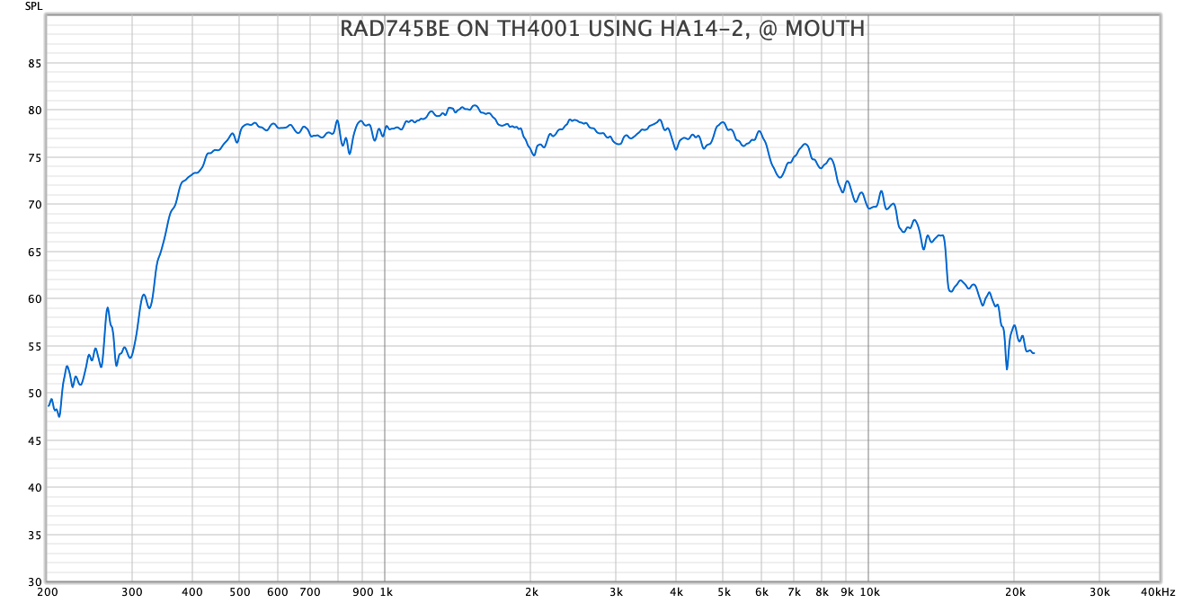

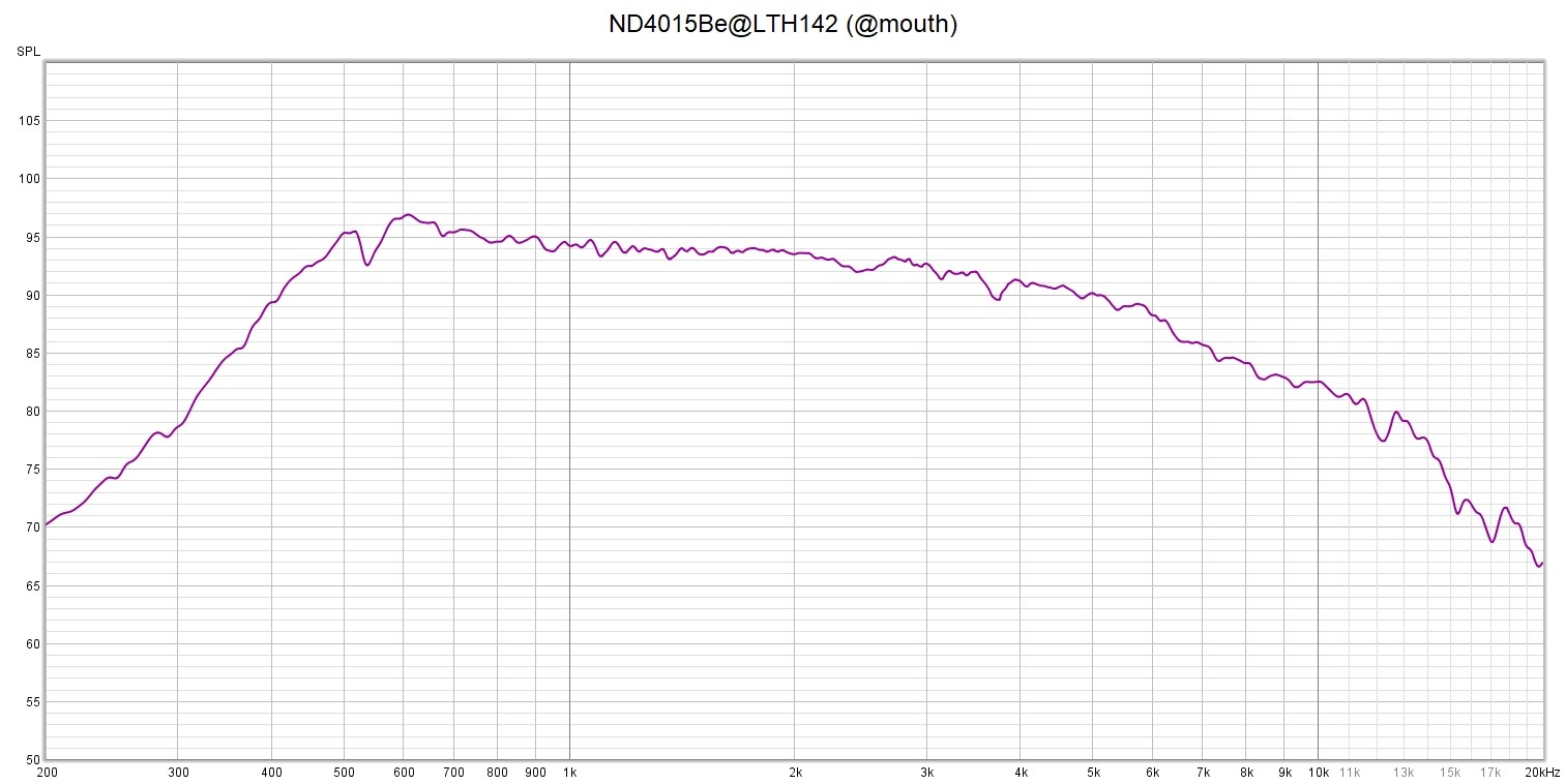

The HA14-2 adaptor helps the Radian quite a bit. Here is the measured response of this 3 inch Be diaphragm driver on the same TH4001 at throat mouth. (SPL is arbitrary).
Comparing these curves I note:
The Radian with the composite throat adaptor extends flat to 500 Hz and is down 5 dB at 400 Hz. Better response than I got using the "stubby" throat adaptor but not quite as nice as the results posted by docali where one can see the 18s ND4015Be extend flat to 400 Hz.

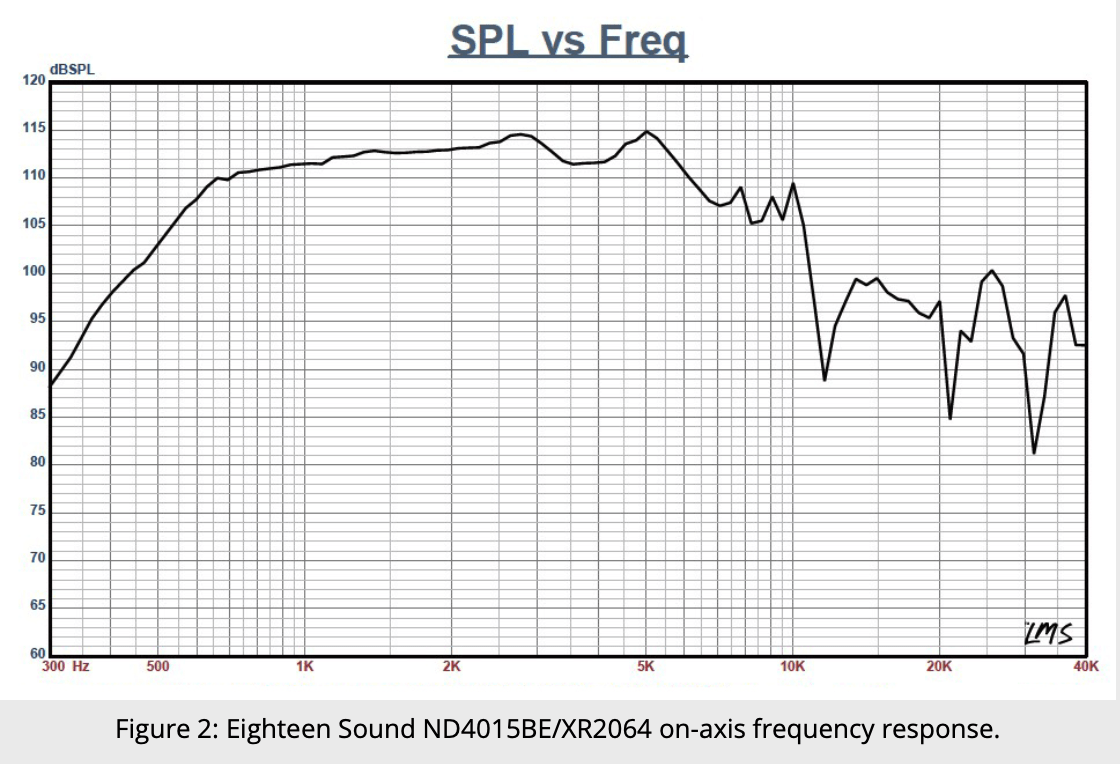

The 18s ND4015Be shows a notch at 10 kHz. This is clearly seen also on Vance Dickason's measurements. Would this be the larger diaphragm breaking up? The smaller Radian 745Be is smooth at 10kHz, exhibits a small notch at 15kHz and a more severe one at 20kHz (comparable to the ND4015Be's). For this reason, when crossed at 700 Hz or higher, I continue to like the 3 inch diaphragm Radian in a two way design. I would love to hear the larger drivers though...
This is definitely no break up. These occur around 26kHz. HF measurements are a bit arbitrary from my experience. The mic a little bit at a different position and you get a slightly different fr curve. Also I found that it is more difficult to measure large mouth horns in the near field. Here you can see how the ND4015Be performs in the LTH142 horn:
Just show me another large format cd that performs like this ;-)
Btw, the notch between 500Hz and 600Hz is because of the mouth area of this tractrix like horn is too small. This is the case for most tractrix horns.

I believe you and appreciate the engineering behind such a driver. Still, trying to understand what the curves show. Your measured curve using the TH4001 and the one (from VD) below using a different horn show a similar dip at 11-12 kHz. Would you attribute this to the driver? the matching between the driver and the horn? Or (as you imply) interference due to microphone placement within a large mouth horn? (I could see this btw)
edit: I just recalled that Vance measured the version of the driver that has a 2 inch throat. Docali I believe your version has the 1.5 inch throat correct? This might account for some measured differences.
What was done in VC magazine is imo one of the worst scenarios you could do for a driver as it was measured in an 2" XR2064 horn and with an 1.5" to 2" conical adapter which opens up very fast.
To be clear, there is only one version of this driver - it is a 1.5" driver! There is no 2" driver! I bought it together with two adapters: 1.5" to 1.4" and 1.5" to 2". So the version that Vance used must have had the adapter attached which is quite short and conical and this goes into the diffraction horn. No wonder about the strange curves. I have measured the ND4015Be in several different horns and it always performs way better compared to the VC measurements. I would even call it one of the very best large format drivers ever made.

Ah, this helps clear things up, thank you! It really looks like some drivers are not shown in their best light when fitted to adaptors and horns that are poor matches...

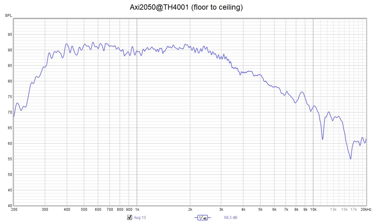

I had planned to experiment with TH4001 and a 300 Hz JMLC horn. Waiting for the athosaudio TH4001 at the moment. The approach and drivers will be a little different but I am curious about your subjective impressions on the two horns types. If you had to pick one which one would it be?Filtering and EQ for TH4001

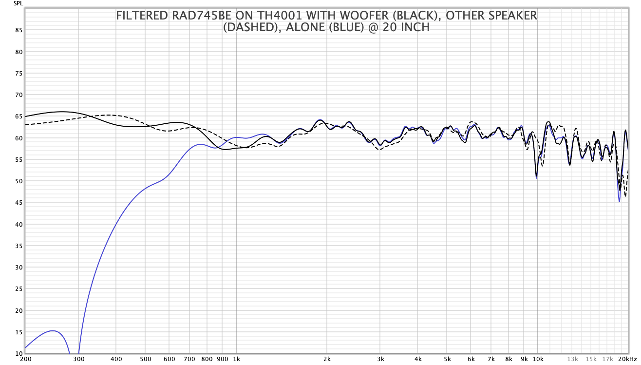

Caveat: Output from the Radian driver is limited above 15 kHz. I personally find that a response covering 30 Hz to 15 kHz satisfies me, but this is personal taste.
Shaping the response of the Radian 745Be + HA14-2 + TH4001 horn combination in a two-way design is straightforward. The efficiency of the Radian driver in the 10 to 15 kHz range is sufficiently high to match that of a good woofer, allowing the use of passive EQ. This can be done many ways (the TAD filter is out there somewhere), but as a starting point below is an example circuit that requires only 5 components. This is for the 16 ohm version of the diaphragm-coil.
In series:
In parallel with the driver:
- An attenuation resistor on the amplifier side, Ra = 4.7 ohm for my woofer-enclosure. Adjust to taste.
- An RC EQ filter, Req = 50 ohm and Ceq = 0.77 uF in parallel. This attentuates the midrange below 10kHz or thereabouts for flatness.
- Filter Capacitor on the driver side, C = 1.2 uF.
- Filter Inductor L = 10.9 mH.
Using the REW alignment tool, I could achieved a smooth transition at 700 Hz by reversing the phase on one of the drivers and positioning the horn mouth 3 inches (75 mm) in front of the baffle.
Below shows the response measured at 20 inch in front of the speaker, mid-height between woofer and horn motors, after time windowing to reduce reflections. The black curve is horn+woofer, the dashed curve the other speaker (to show matching) and the blue curve the CD-horn alone. The depression above 1 kHz is, I believe, an artifact of measuring close and below the axis of the horn. The response can be tilted, moved up and down by adjusting Ra, Req and C.

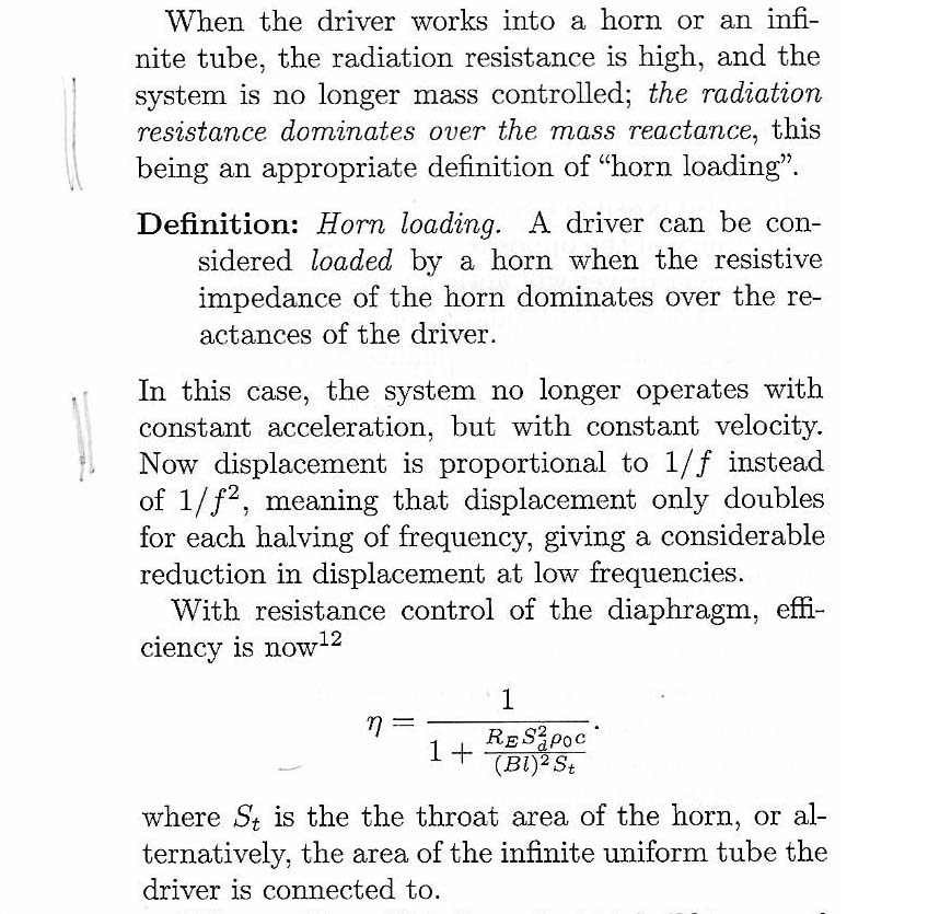

The throat adapter needs to match the flare rate of the horn to maintain loading and reduce any impedance change that could cause a reflection. Alot of BEM simulations were done to see how sensitive particular horns were to the adapters.
Loading does change the behaviour of the driver as shown in @docali graphs and for a good reason. I've attached an explanation from the Kolbrek-Dunker horn book High Quality Horn Loudspeaker Systems . Its a fantastic book and covers theory behind the horns discussed in this thread. The theory agrees with the BEM simulations and the measurements of prototypes.
