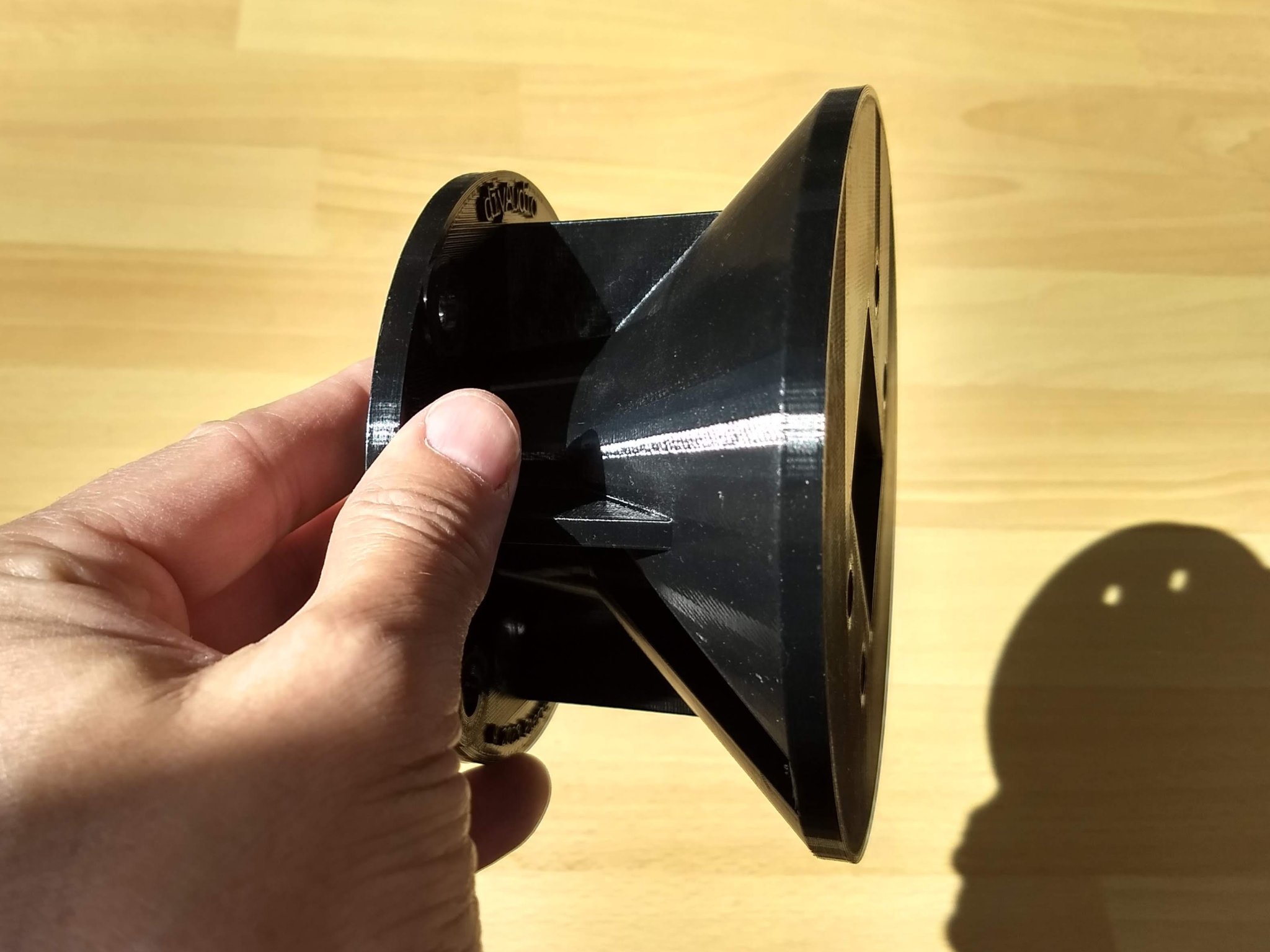

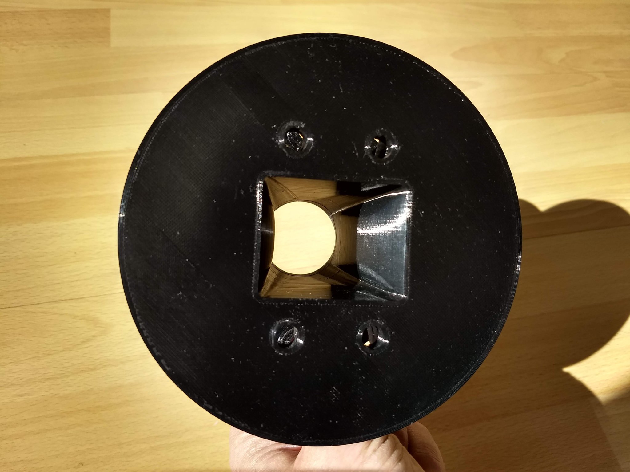

Your adapter print quality is beautiful. What printer are you using?
I have a Creality CR10V3 with DD extruder. Its a pain to get dialed in with other filament types.

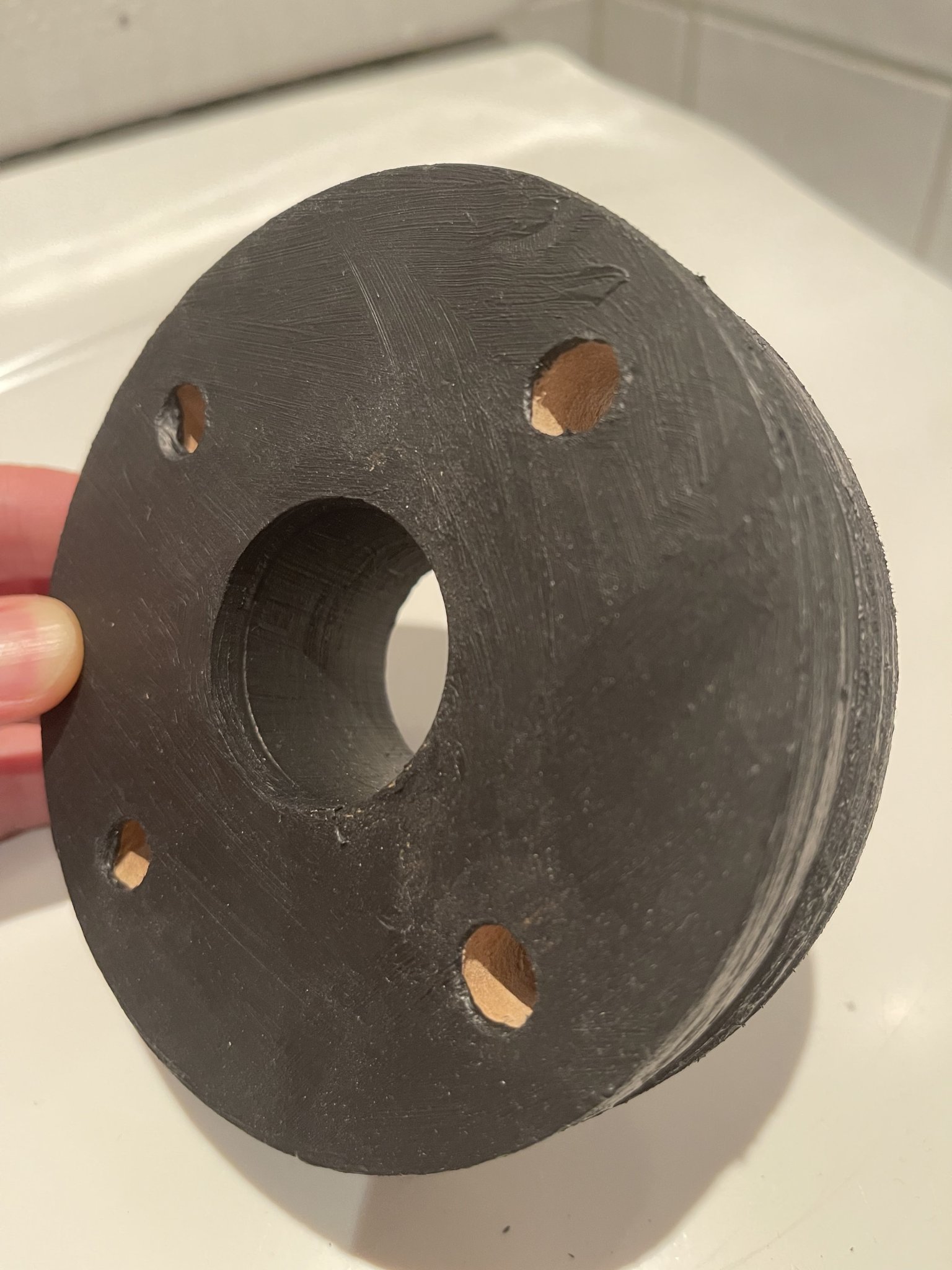

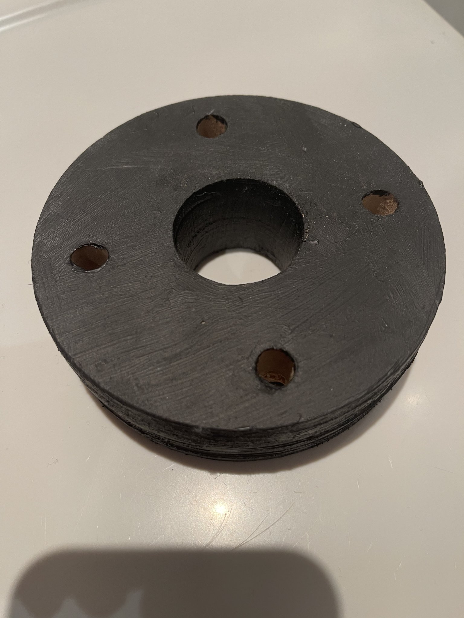

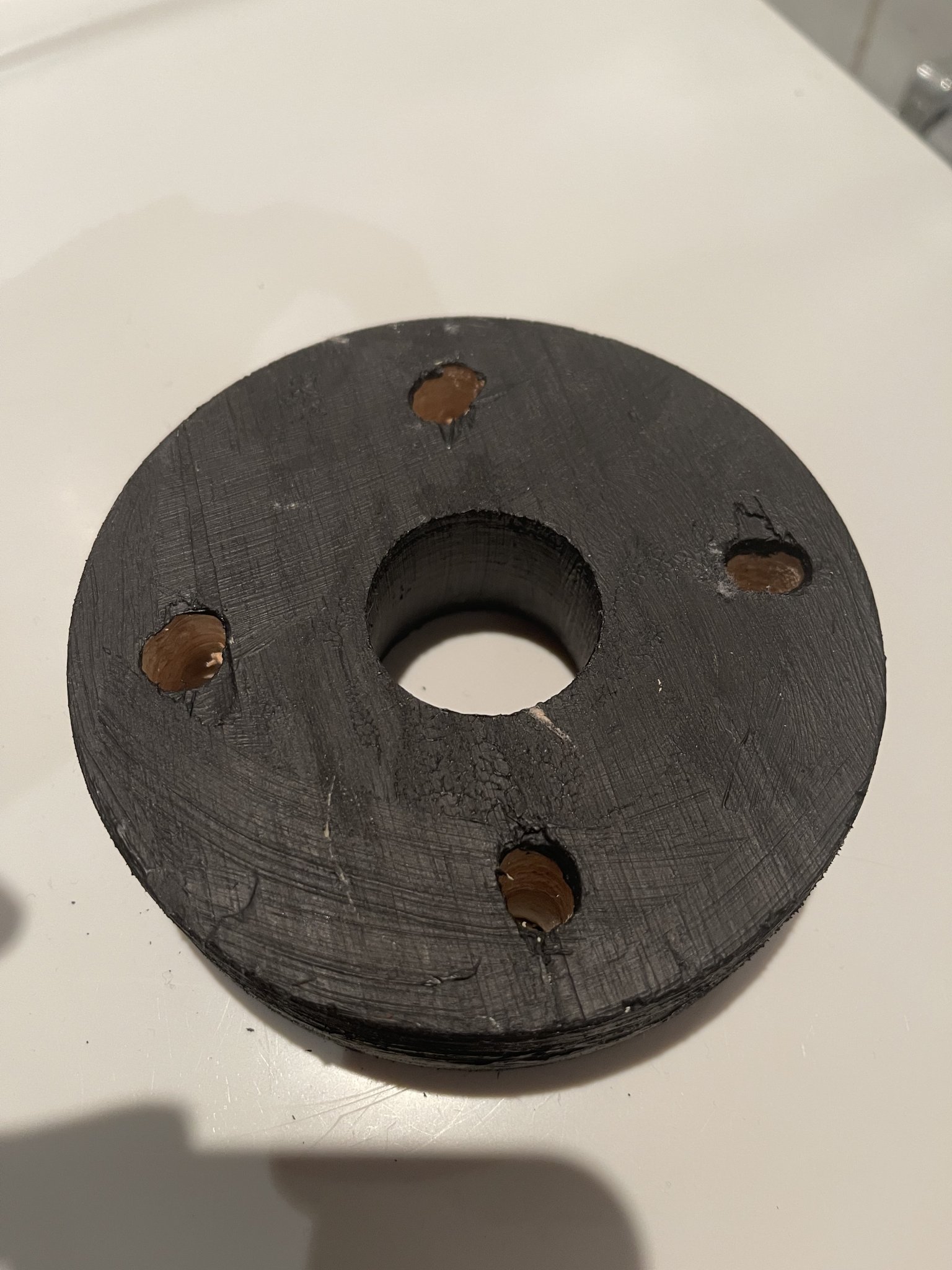

When I made my adapters, I noticed from plastic ebay adapters I had previously, that the weights can become quite substancial with compression drivers. I can see it bending! This is why I opted for mdf and not printing. It required some elbow grease with a file and some pretty wonky drill bits, but I am satisfied. If I keep the old Yamaha horns, I might smooth it with some wood paste
and grind some more.
I support each compression driver and horns independently. Particularly with the drivers I am using adapter failure is not an option.
