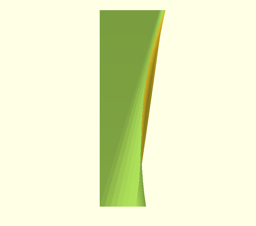

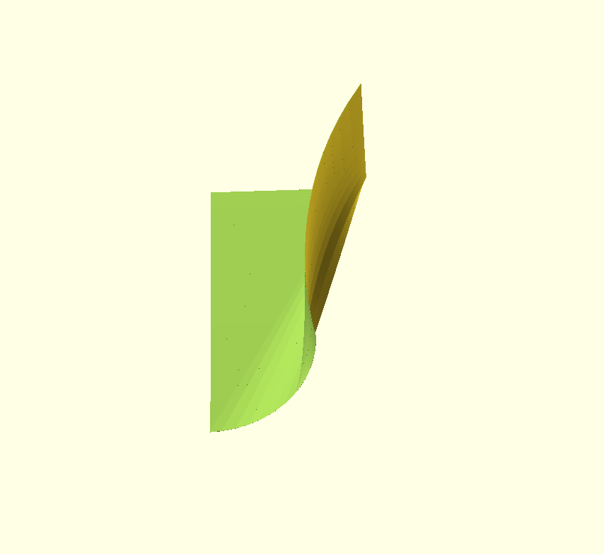

It's all there, although granted it can be hard to visualize in 3D. I also stop and think and stare in blank space trying to picture in my head what is going on.
Point 1 is met with profiles of posts #90 and #127 (Prototype #1). A cross section at distance x would show straight vertical walls. The exit wavefront is spherical-ish...
Point 2 is not met by those two profiles. One solution that satisfies #2 is walls that are straight vertical only at the adapter exit distance x, as shown in #168.

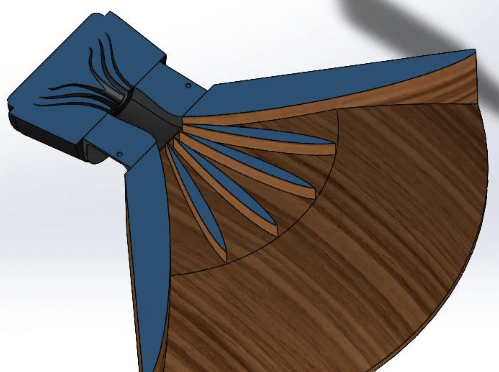

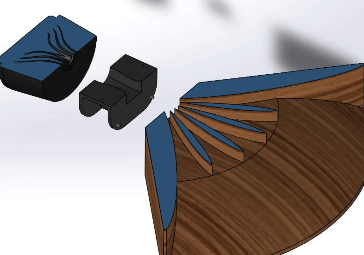

Here is a first concept for a throat adaptor expansion aiming to produce a more "cylindrical" shaped wavefront at its rectangular output, as it seems that this would be beneficial to the TAD TH-4001 and Yuichi A-290 bi-radial horns. It is nice that a 1.4" size driver provides ample length for phase transition. The use of "bumps" as shown is not quite optimal (e.g. small diffraction at the edge of the "bumps"). Still I would expect this expansion to work well, better than my Custom prototype #1, which is already better than the off-the-shelf options I have tried.
There is obvious similarity to some transitioning waveguides that are out there. I wonder if anyone has seen this concept applied in throat adaptors before?
Joseph Crowe has a very similar design;
https://josephcrowe.com/products/custom-yuichi-a-290-biradial-cad-model-make-any-size

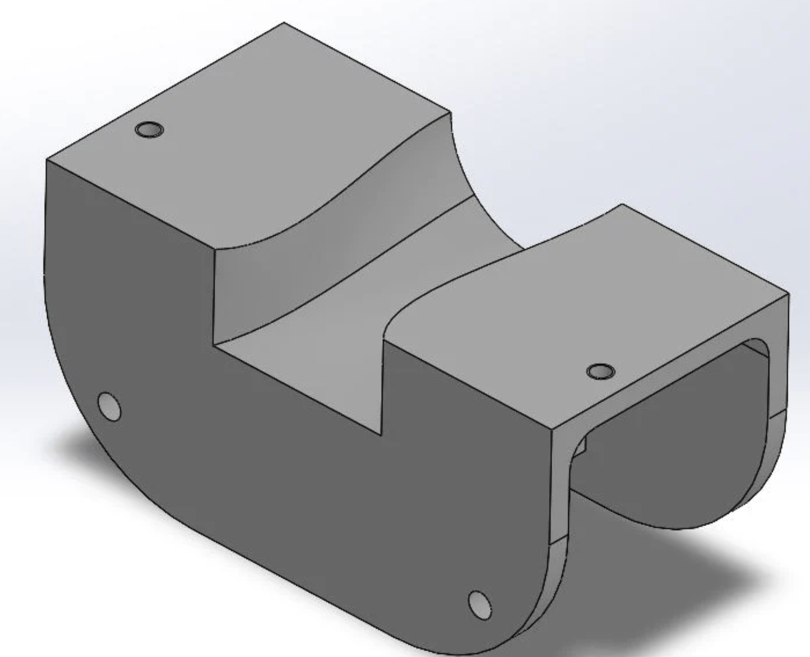

A quick update... Prototype #2 (spherical to cylindrical) printed well, and is waiting for my return home to test and measure. A sheet view of a quarter of the throat is shown below: entrance at Botton, exit at the Top, side wall to the right, green is inside, and yellow is outside. One can see the exterior of the side wall (yellow) bulging deeper inside the throat in comparison to the arc following the corner of the rectangular exit. In this instance, the software computed 35 side wall arcs from entrance to exit, and equalized their lengths so they are all the same.
Now, Marco's posts in Pano's thread have led me to consider prioritizing flare rate profile in the next adaptor prototype (#3), which is still on the drawing board.

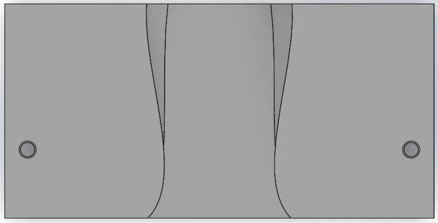

I think these views show it pretty well;
Anyway I think this design is a very good idea from both you and Crowe to overcome the sharp angle transitioning from driver to horn!
