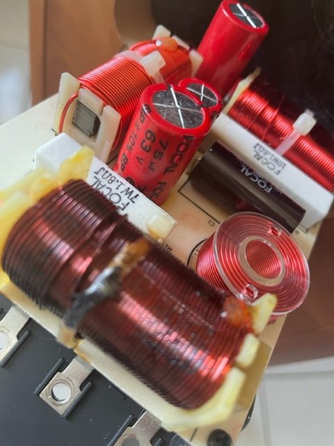

Hello everybody,
I am new on this forum.... Lynn says it is almost impossible to destroy an inductor but you will find attached a picture of inductor L4 from one of my Chorus 726S. The vernish has melted... JMLab gave my the inductance and DCR of the inductor and I am looking for it but it seems to be difficlut. I will try again using diyAudio: thank you for this!
