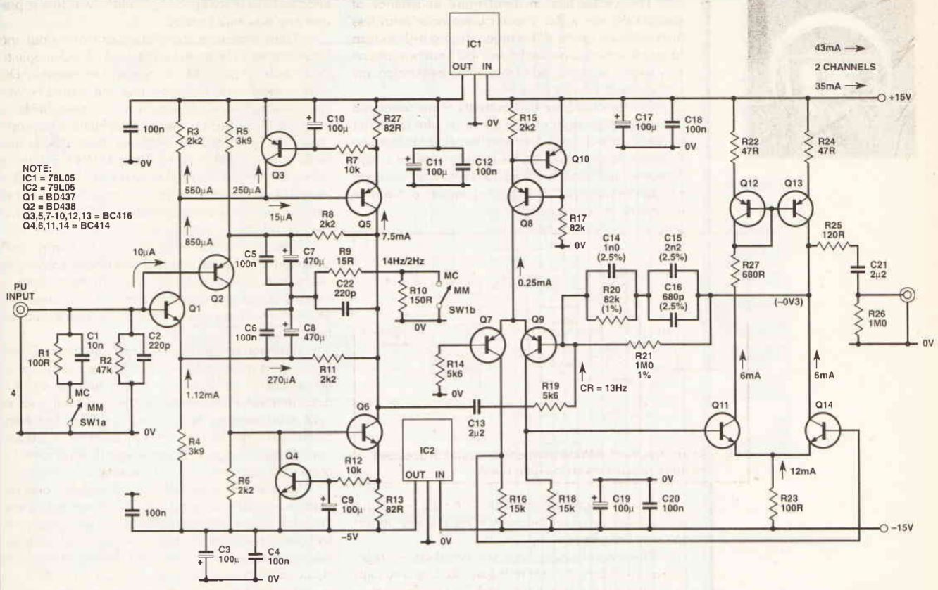

Yes the sensitivities should read ... 3.7mV (mm), 340uV (mc).
The gain numbers are correct .
I have recently encountered this in the thread started by... Anthony.taylor1967...( Gain resistors on JLH phono ) over in analogue source.
Just looked at the overload voltages and the typos persist they should read .... 67mV (mm) , 6mV (mc) .

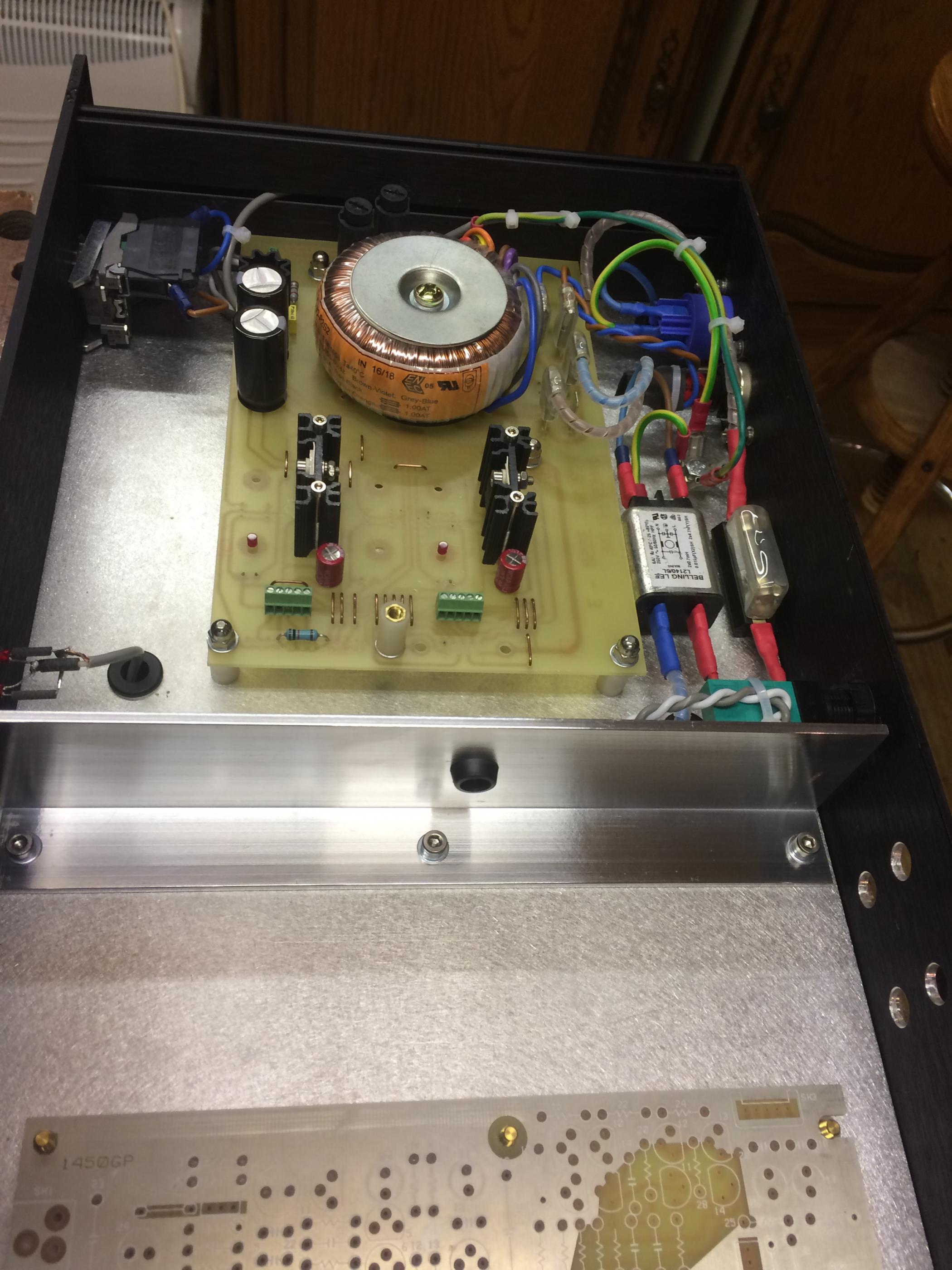

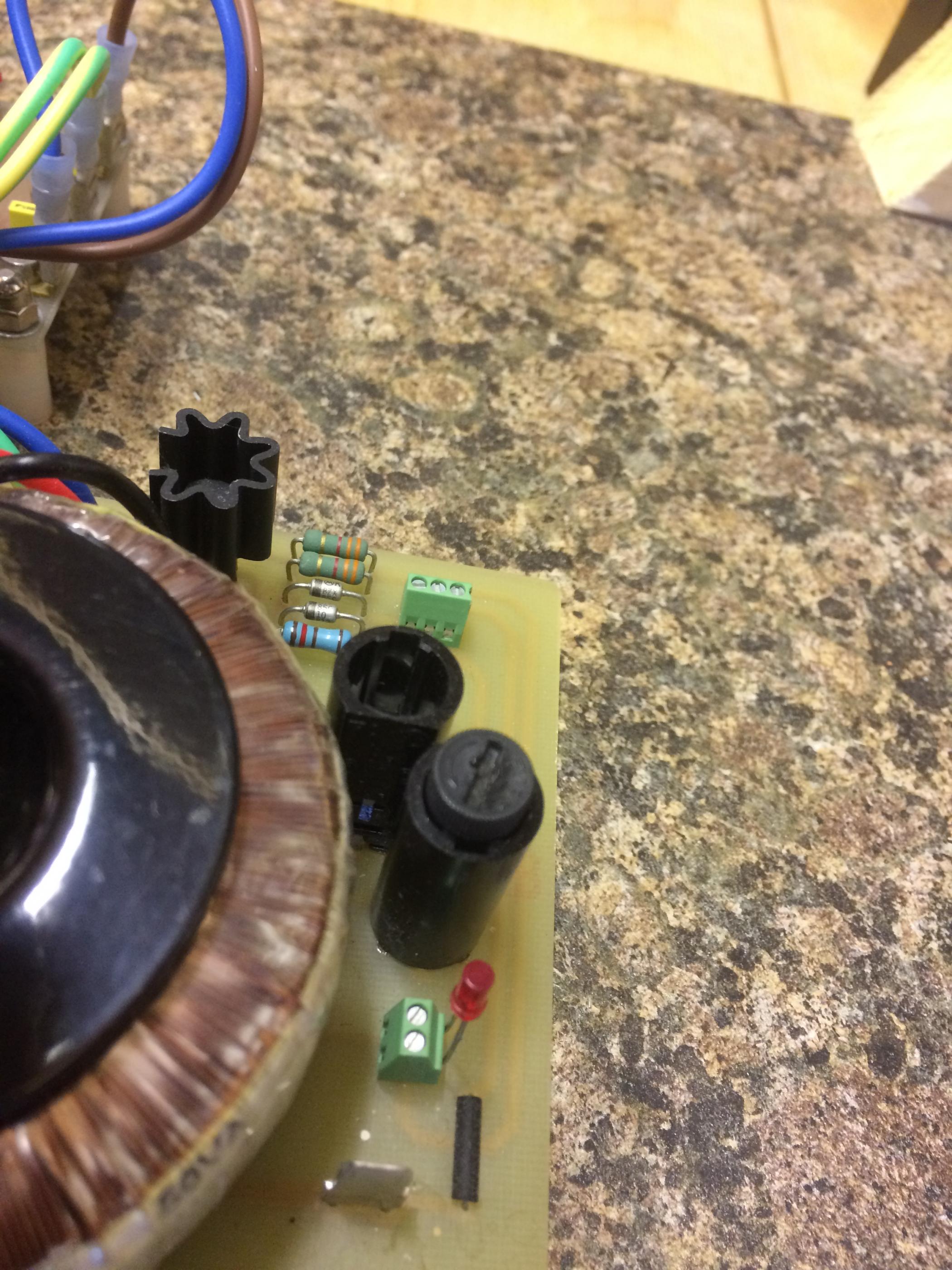

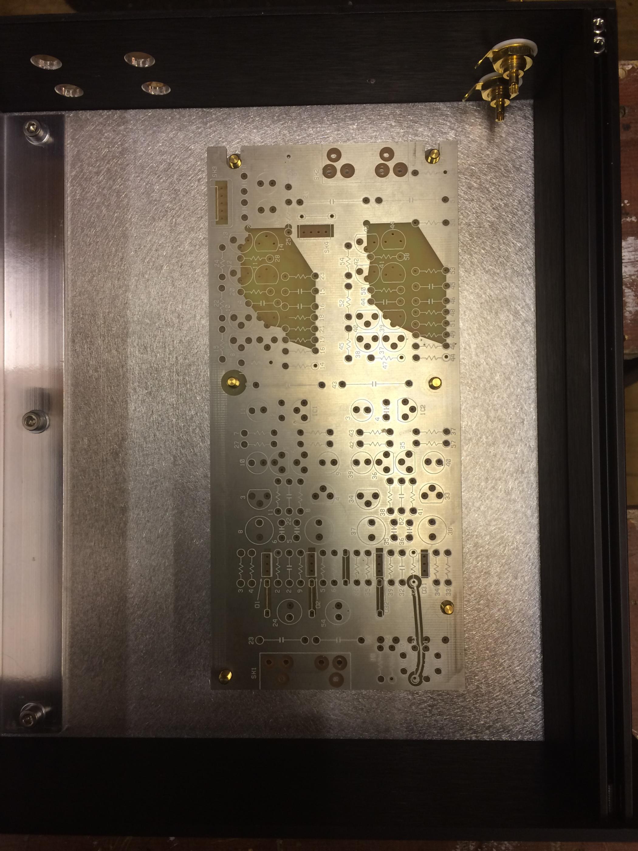

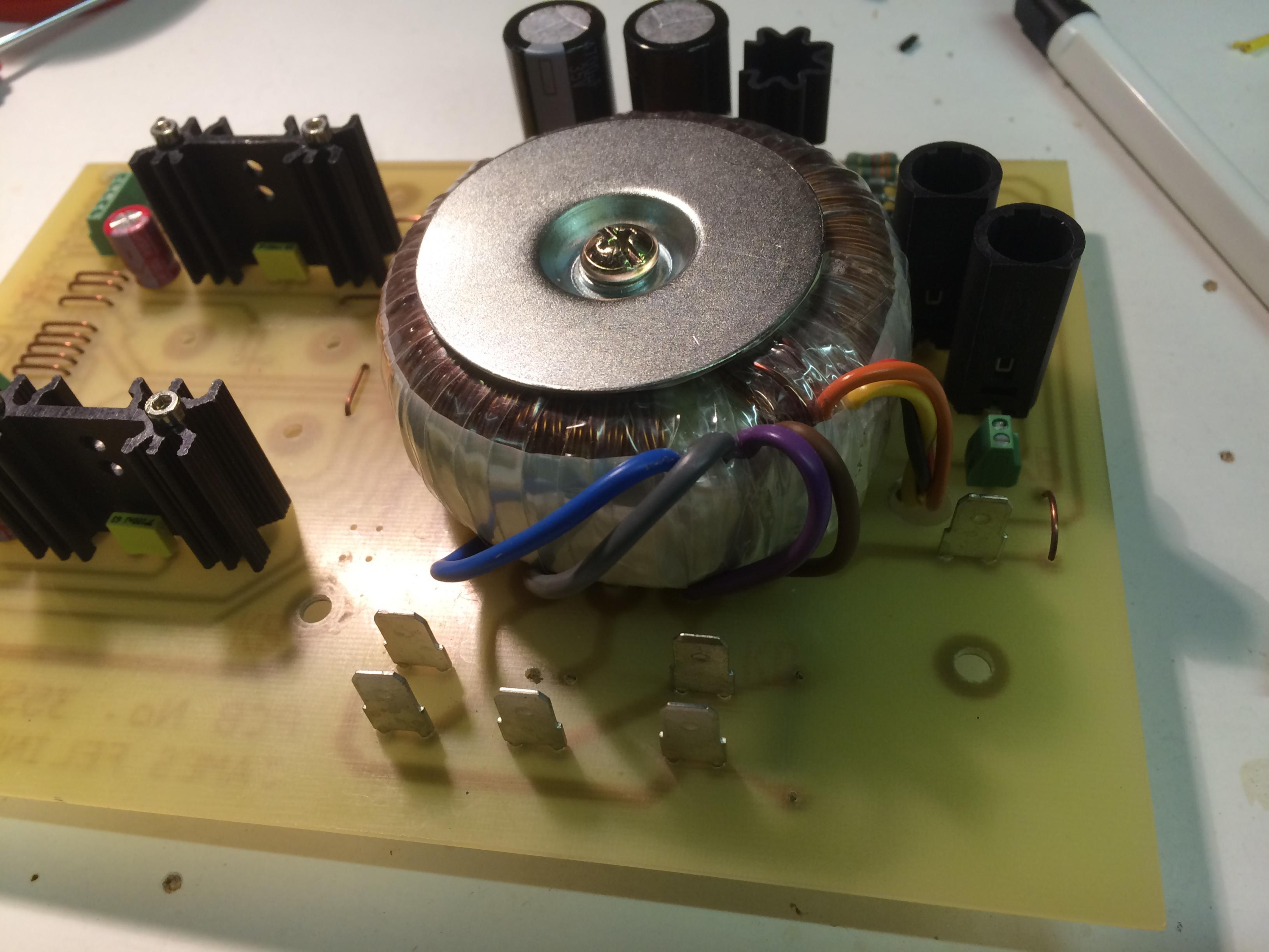

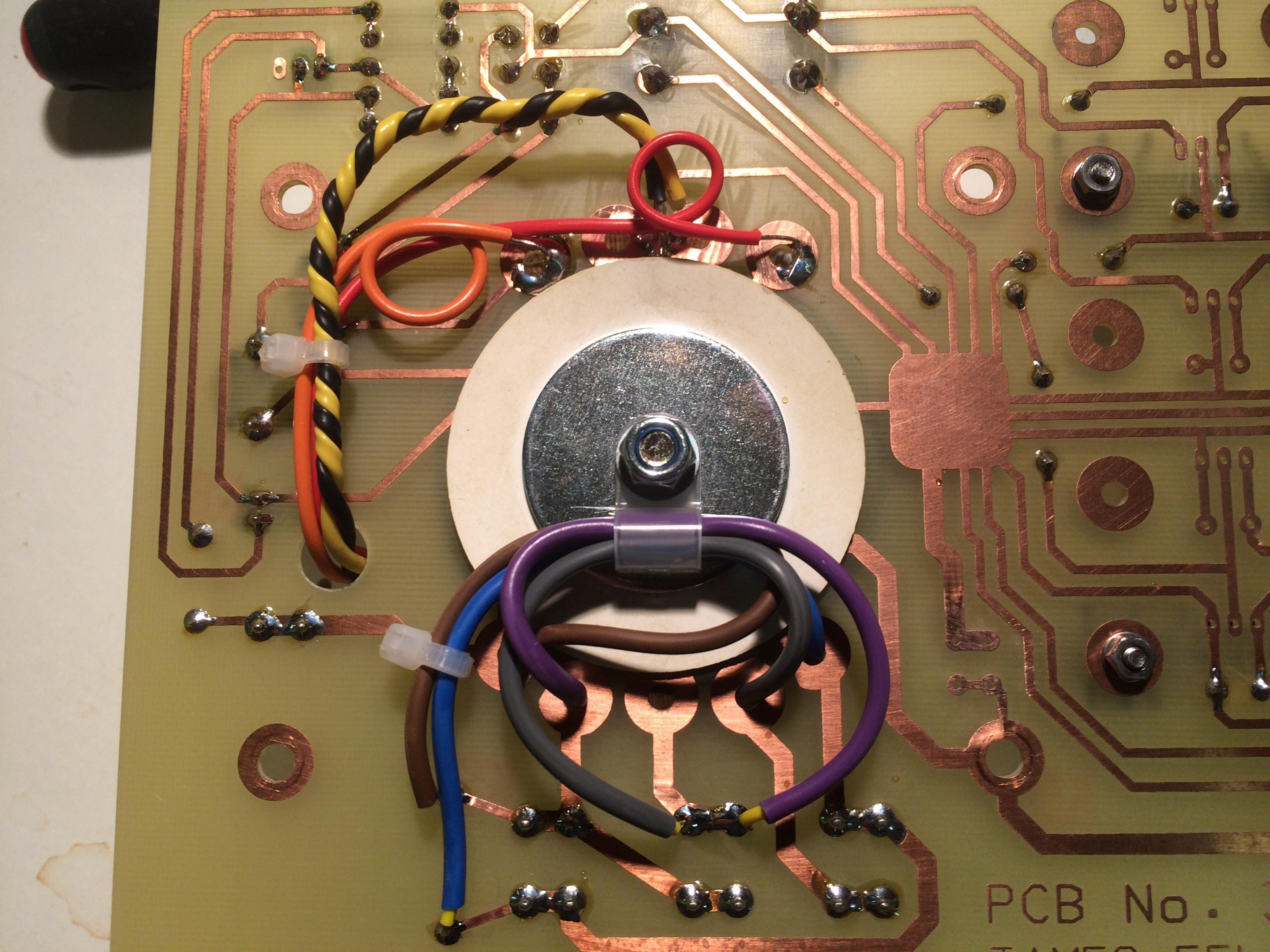

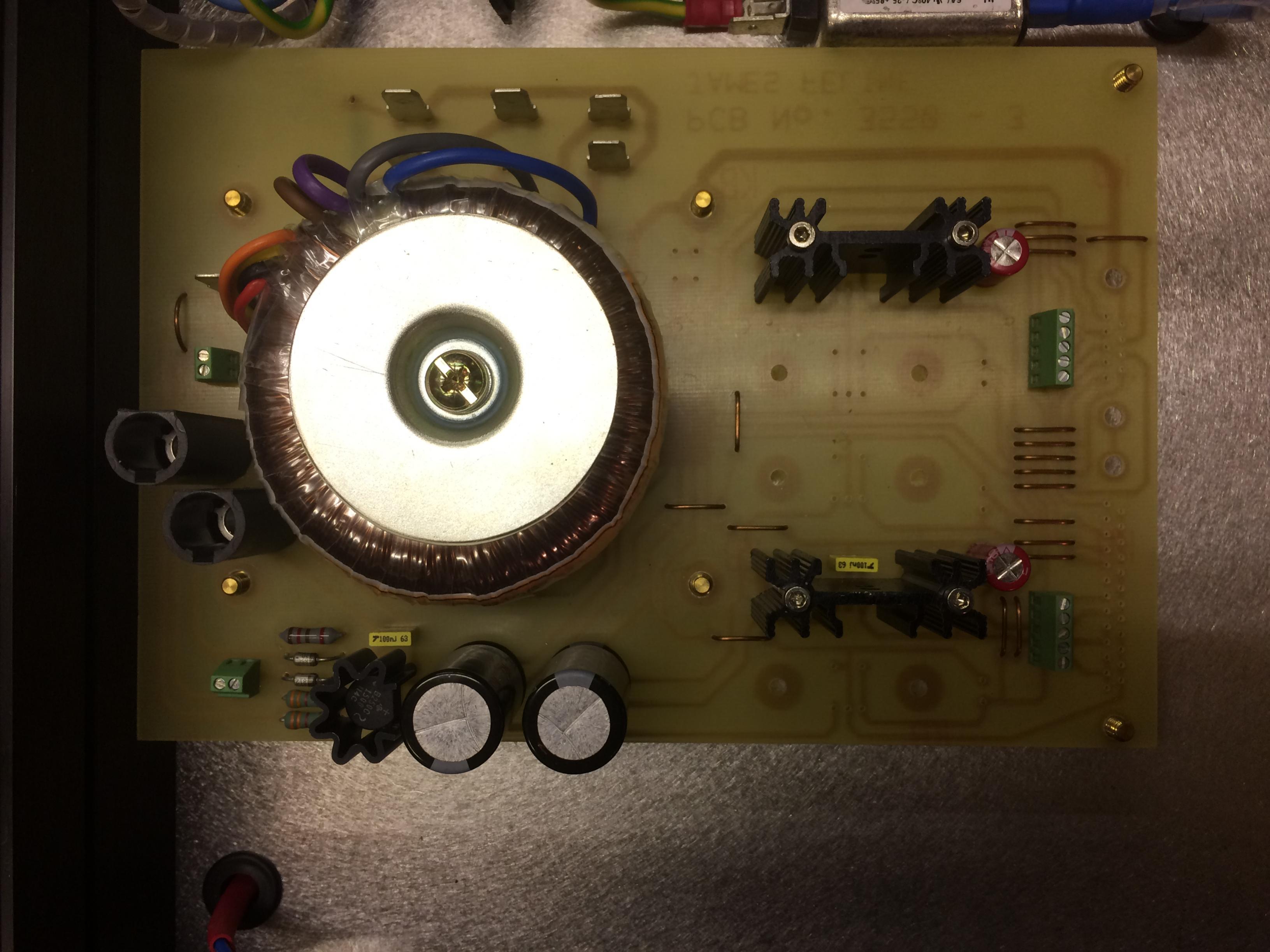

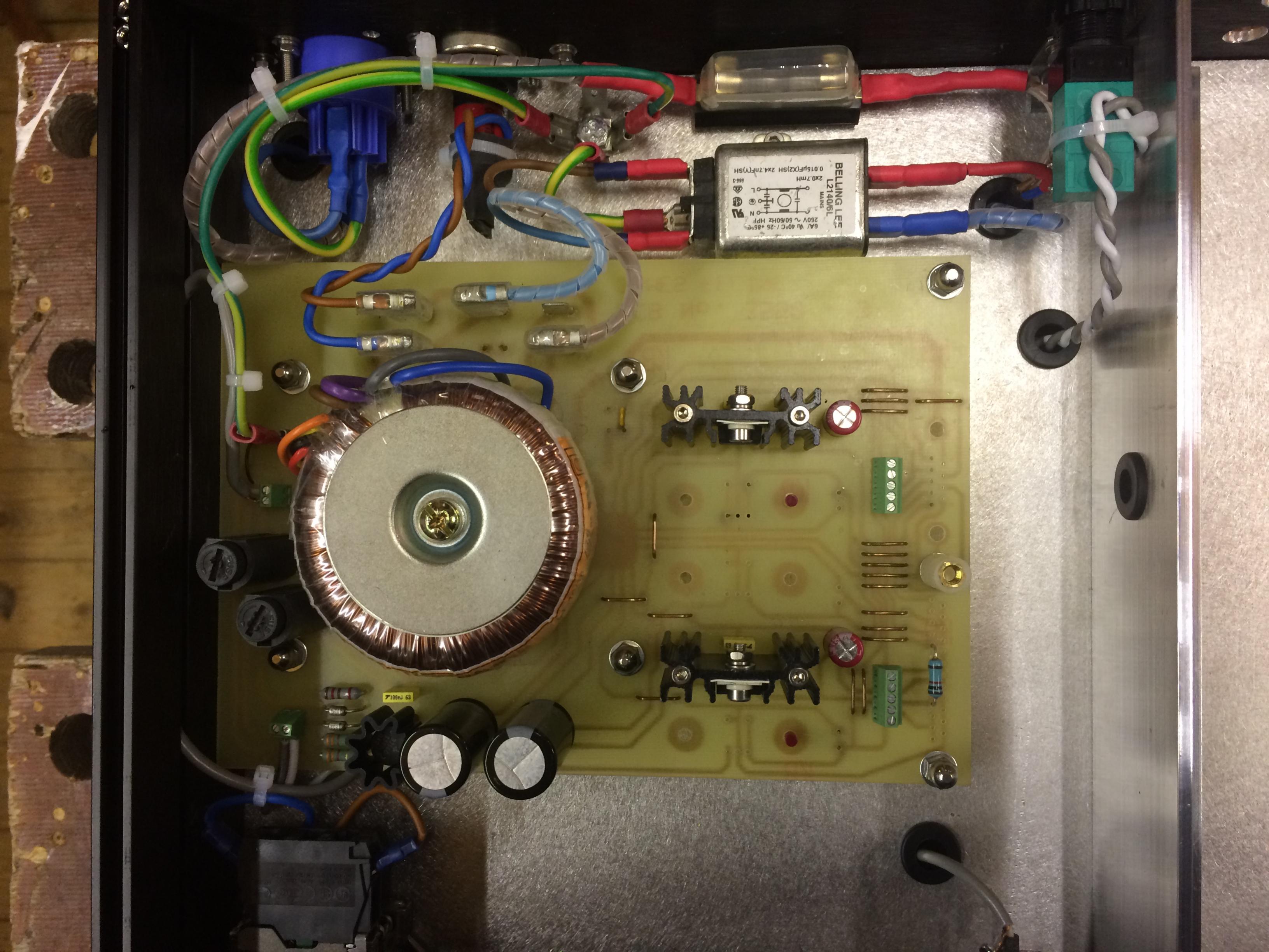

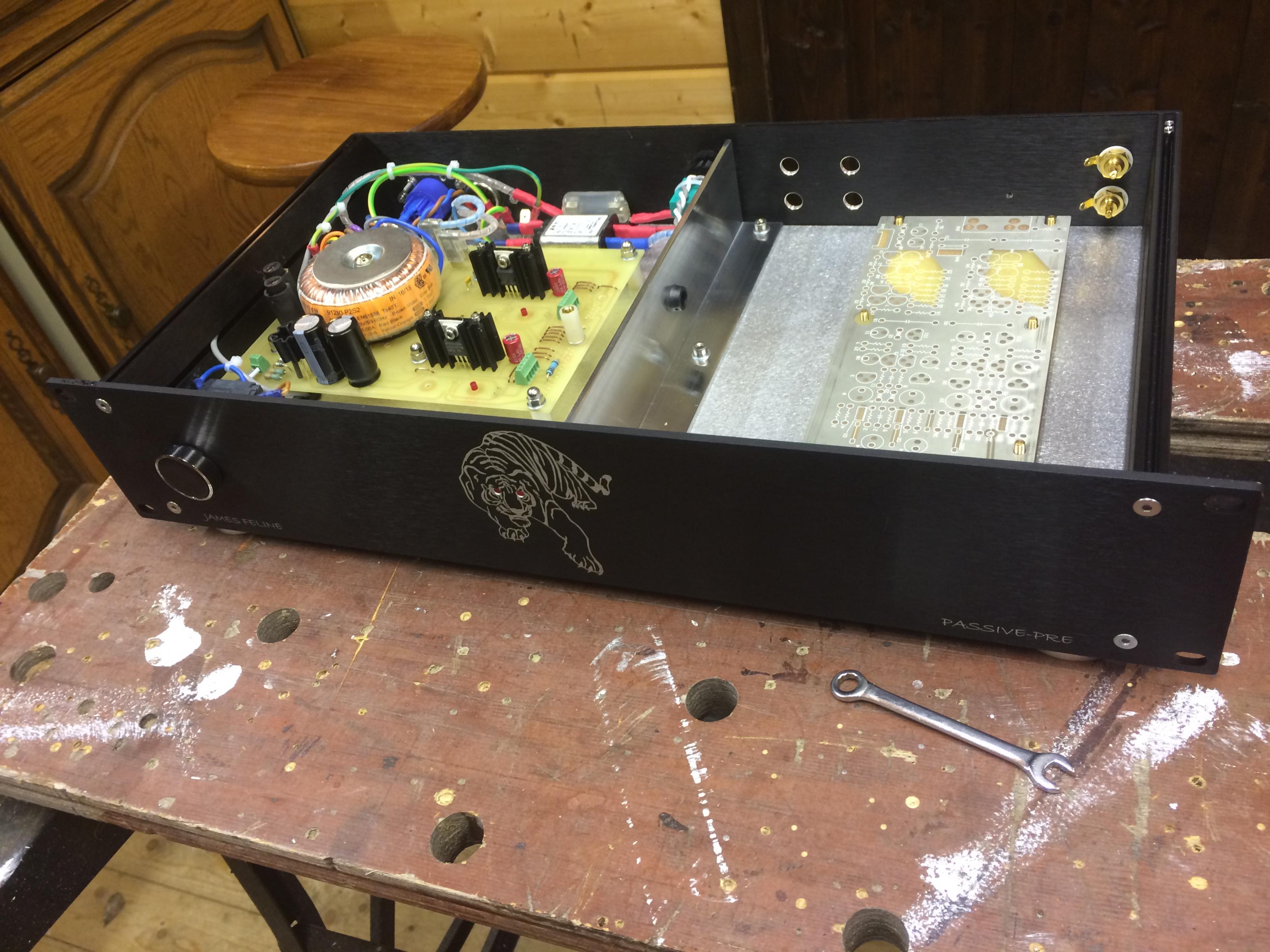

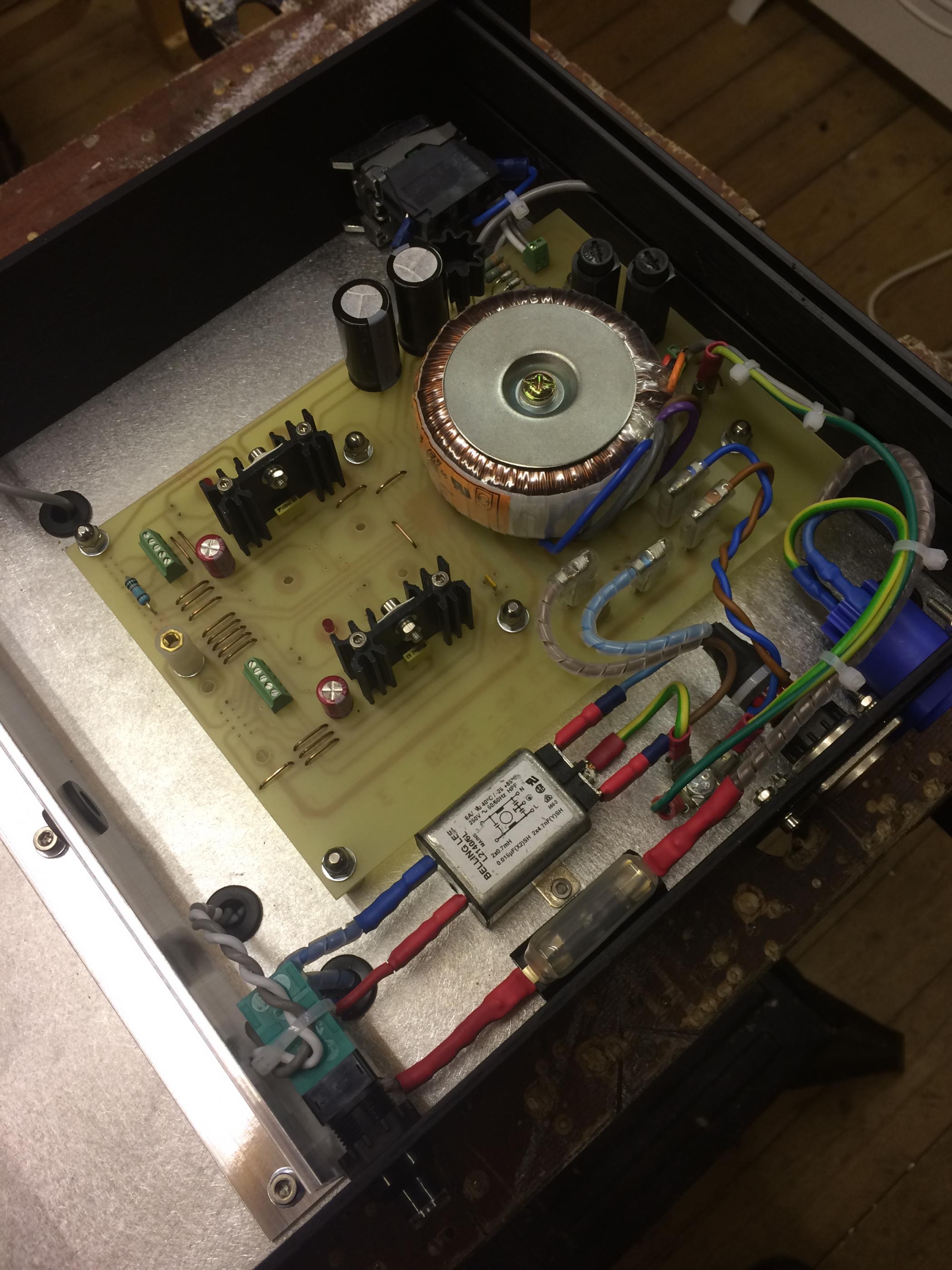

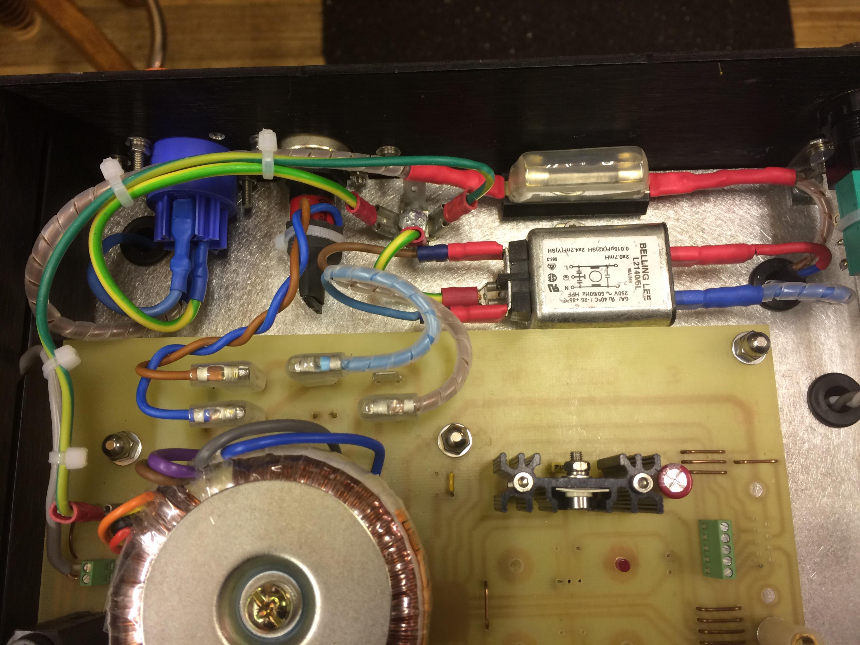

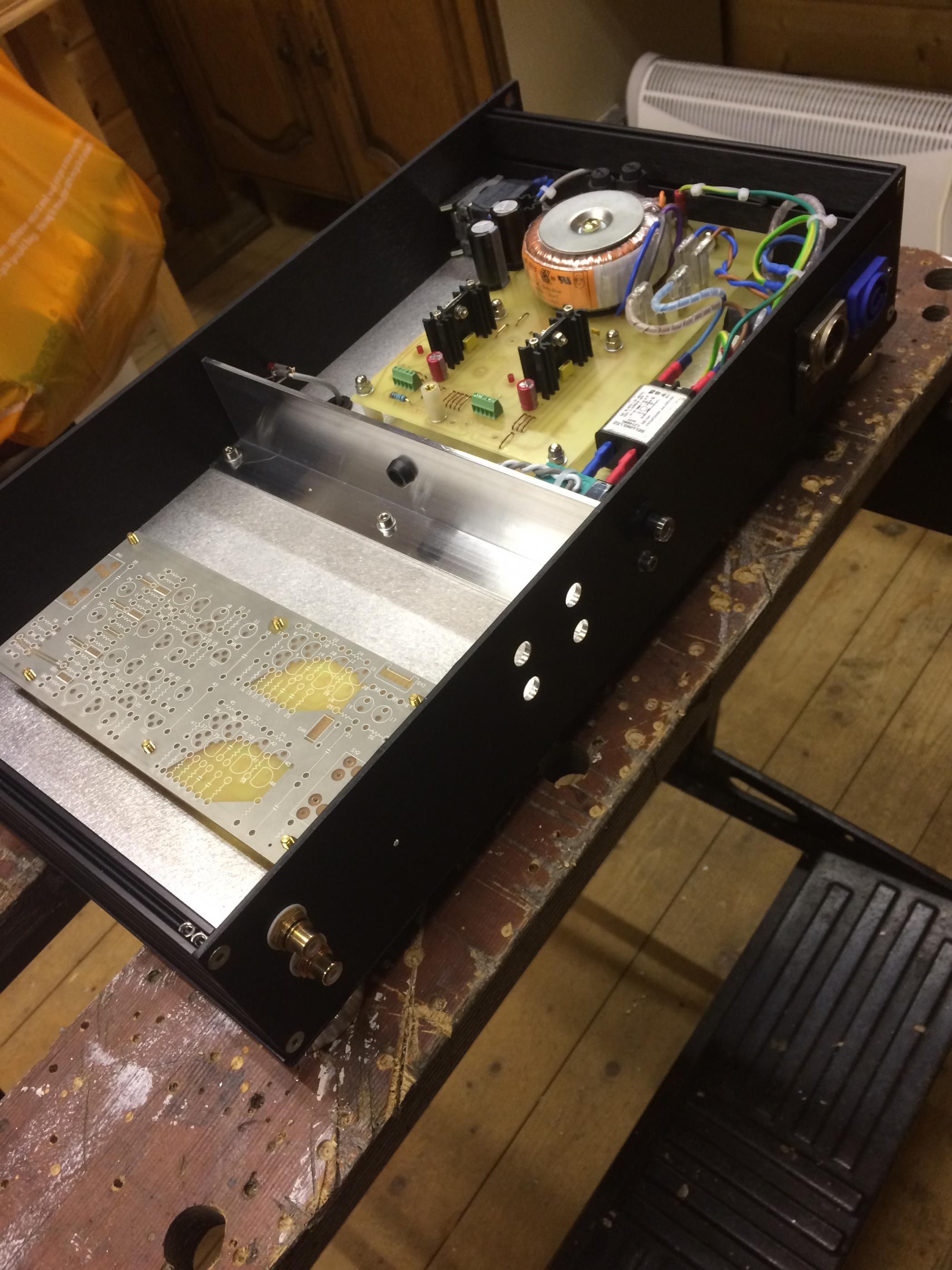

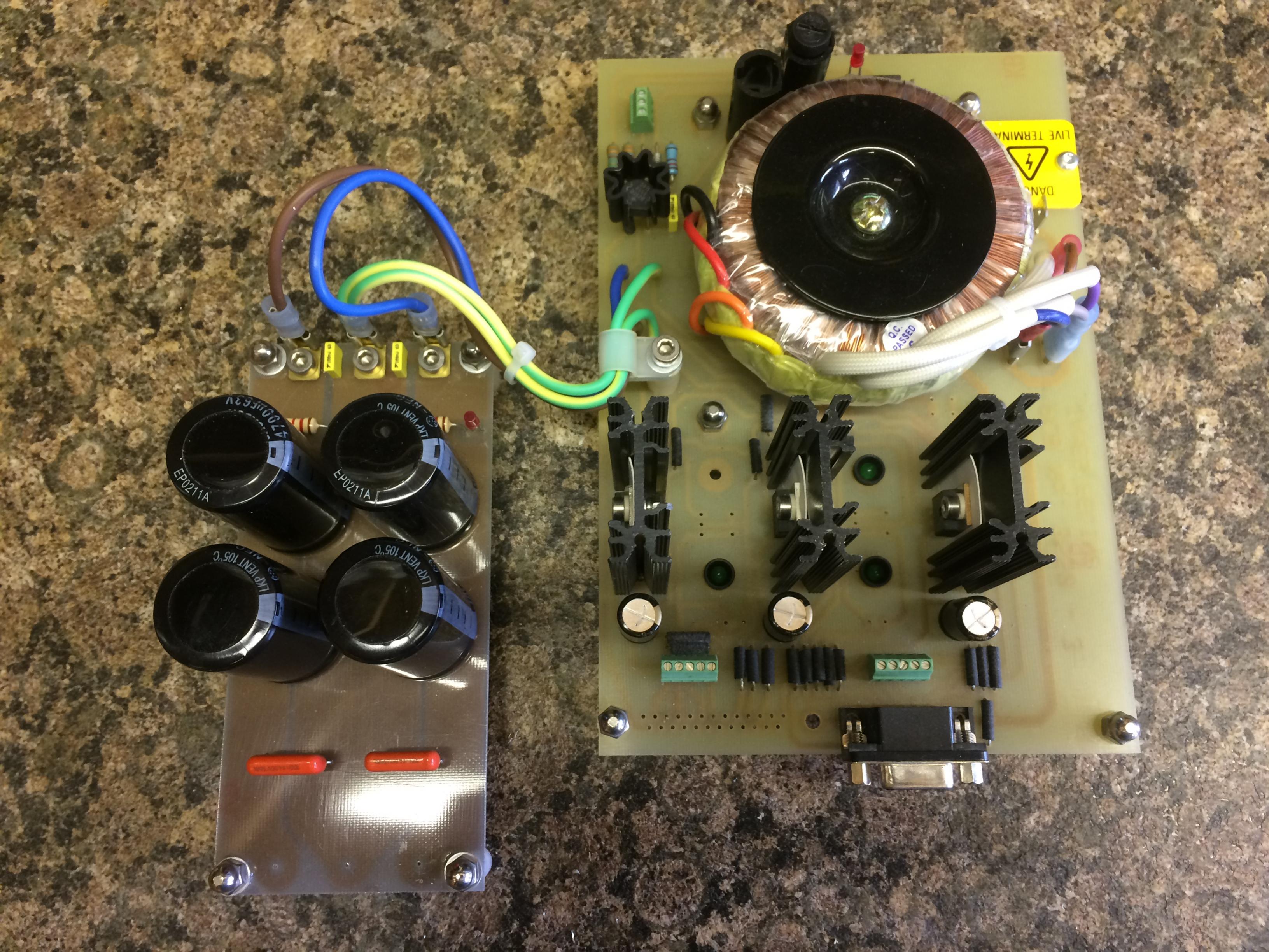

little update .. mounted the power transformer today onto the PCB, for some reason took me ages to find the best fit and configuration of fitment that I was happy with, I did not want loads of flying leads all over the place .... so on the whole am happy with this for now ..

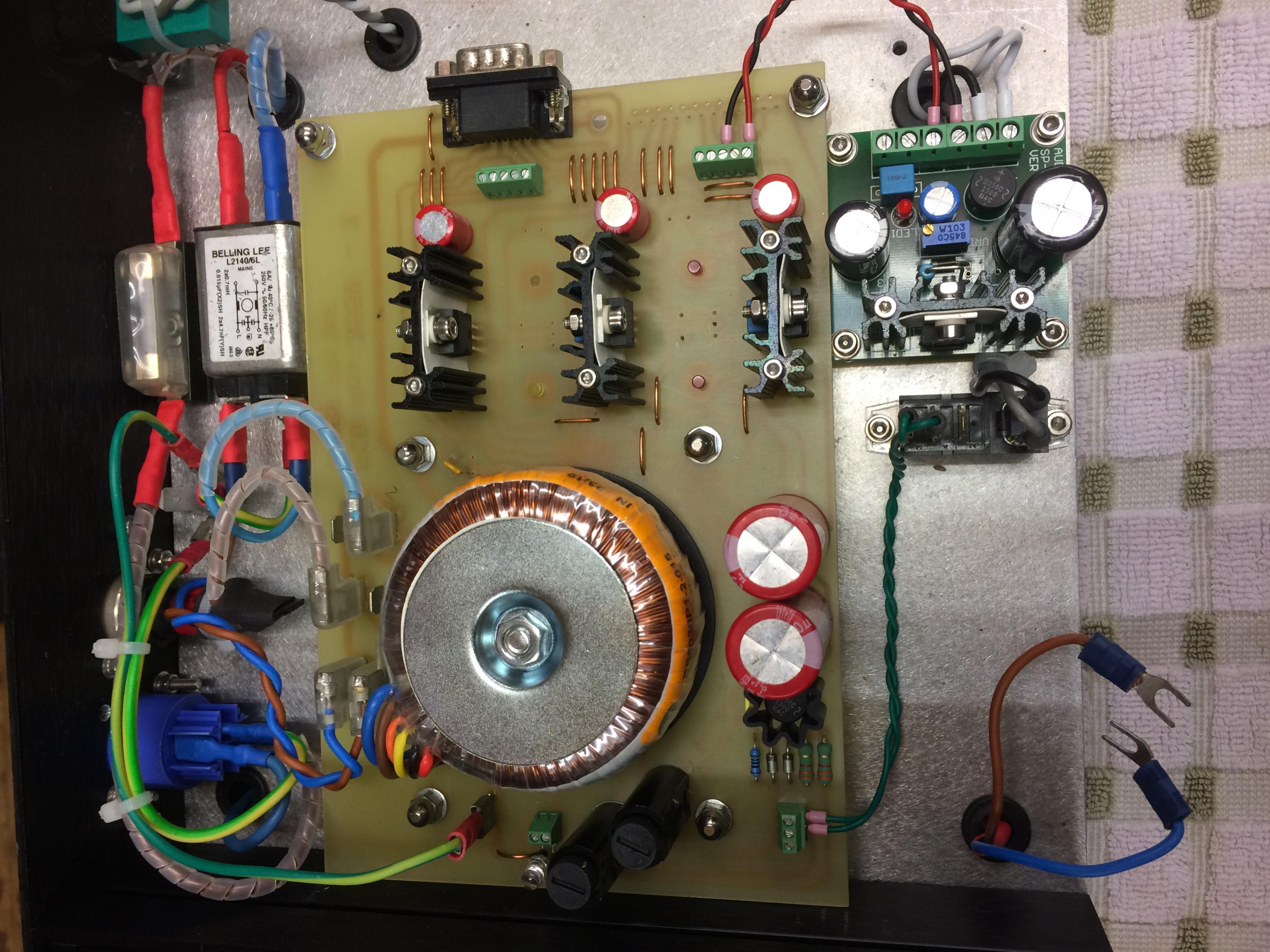

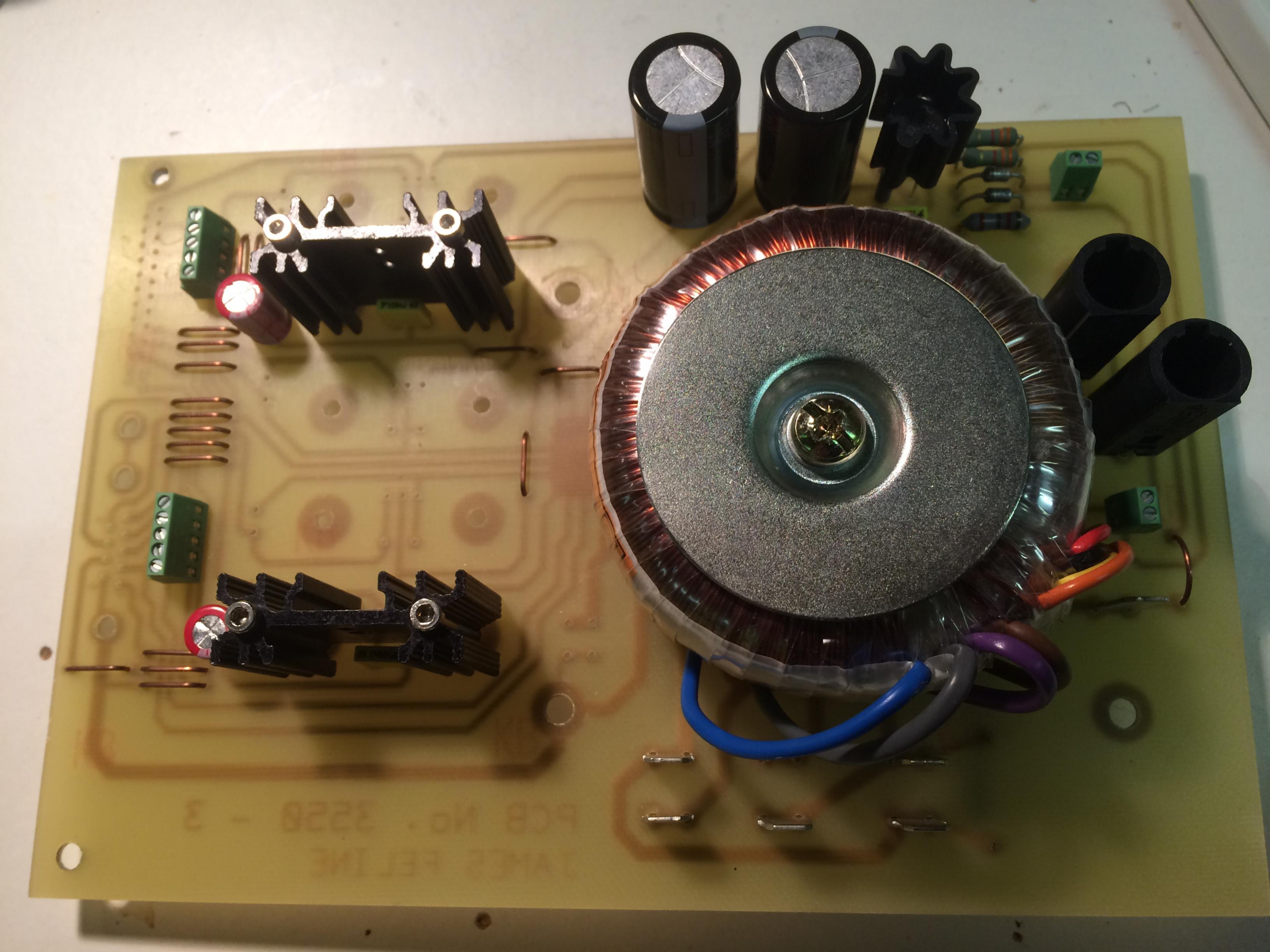

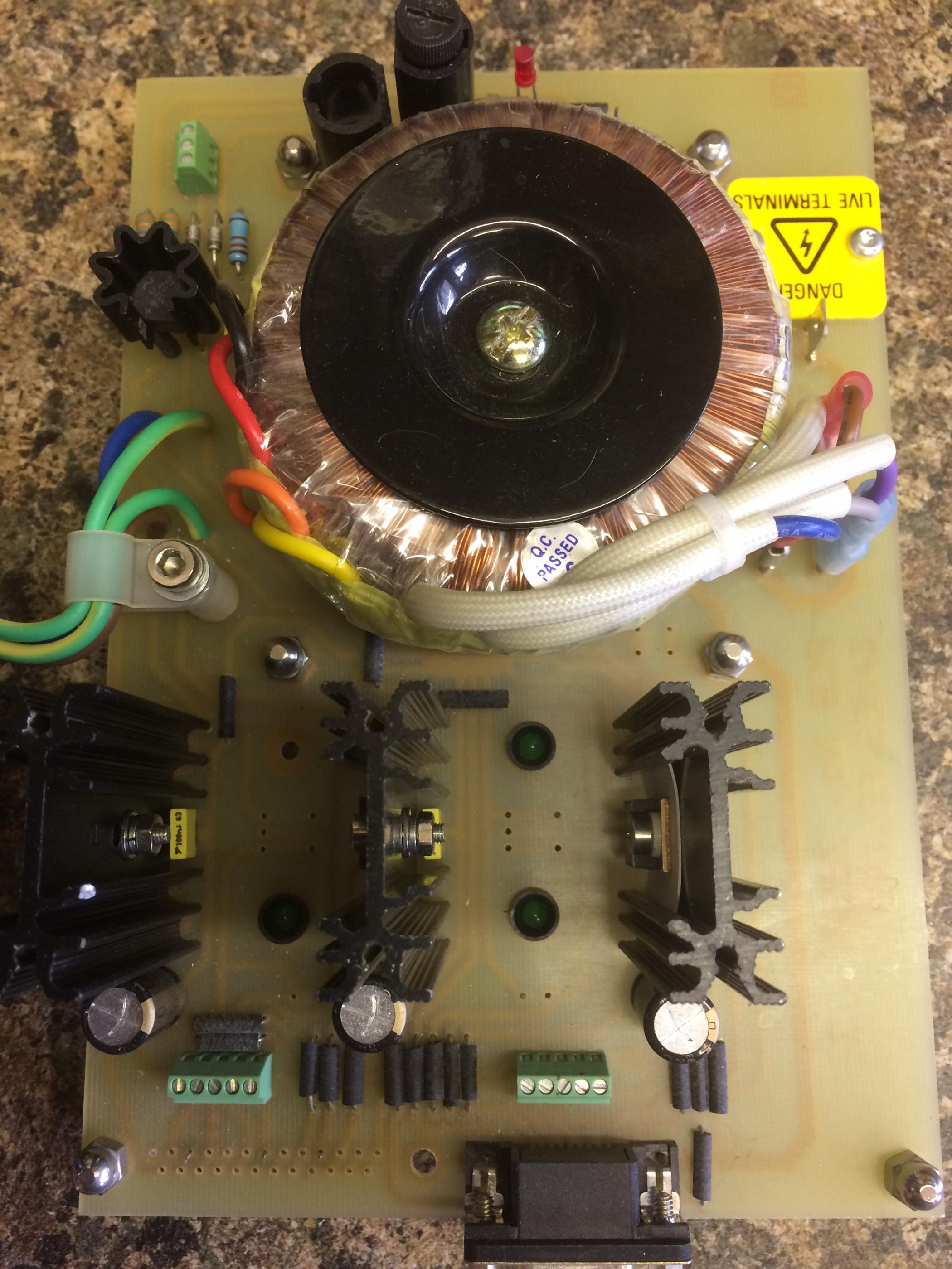

This was the psu I was going to use but was to big for the case .. so decided to put this on the shelf for the Class A head phone amplifier for a later date .. pics just for info

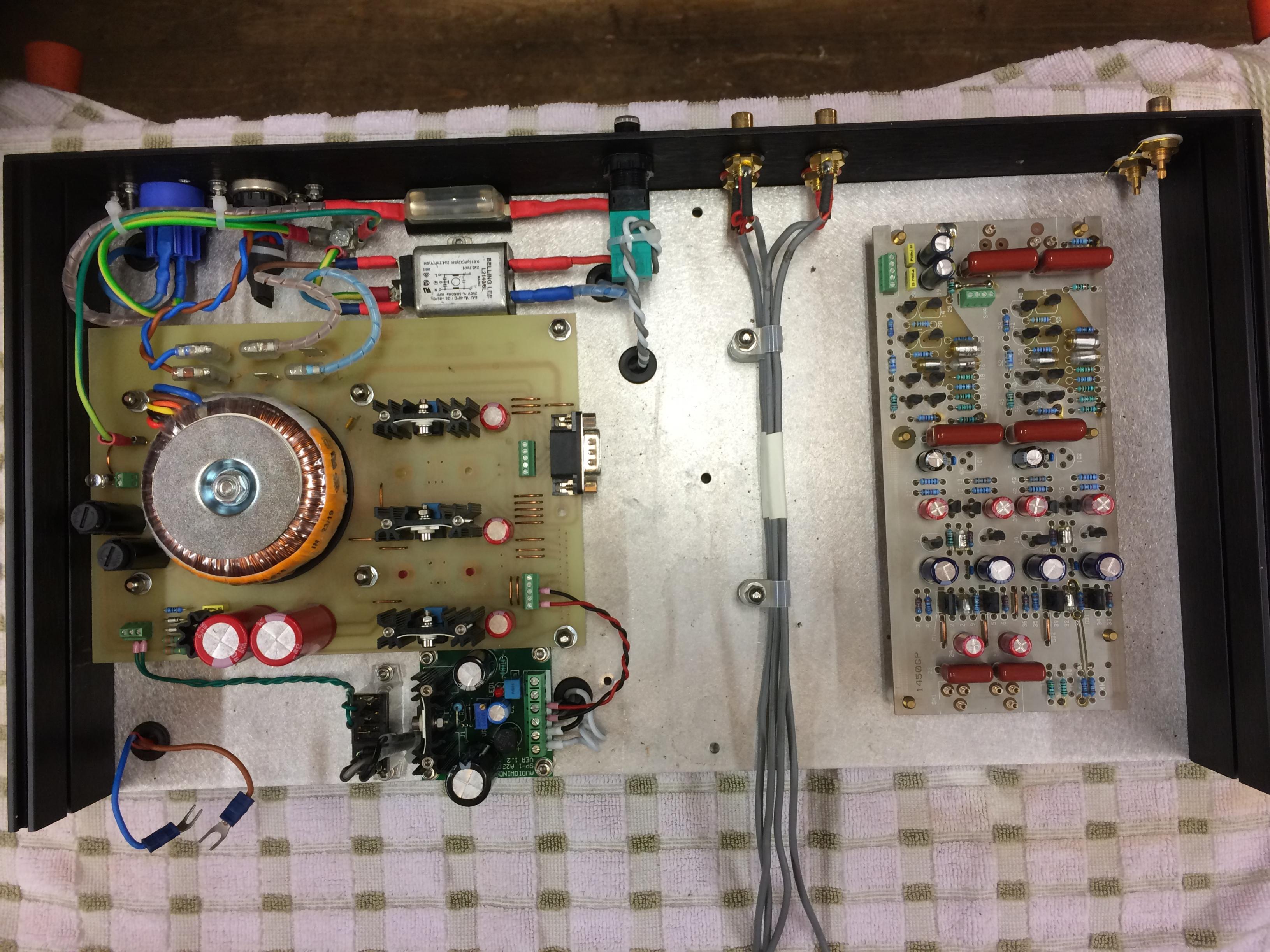

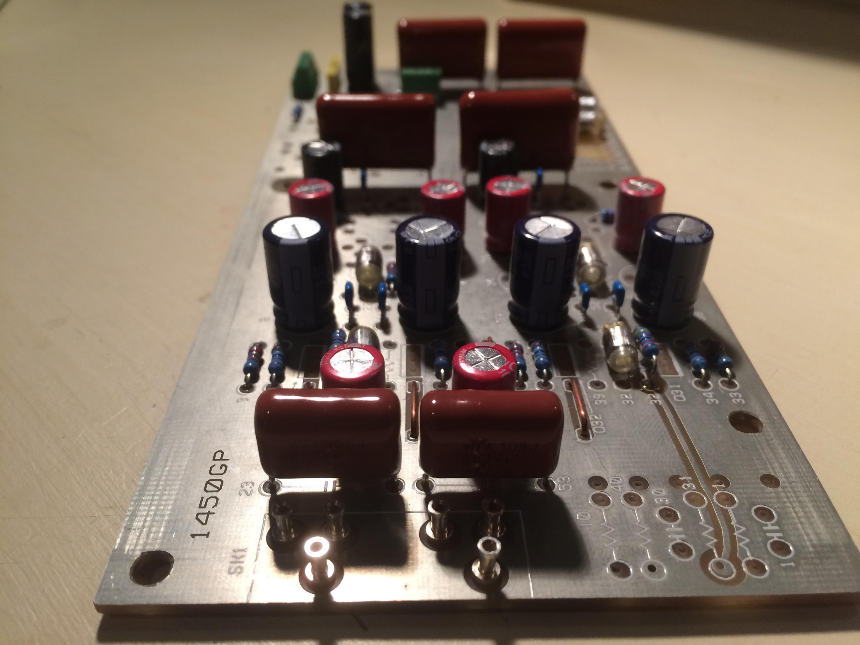

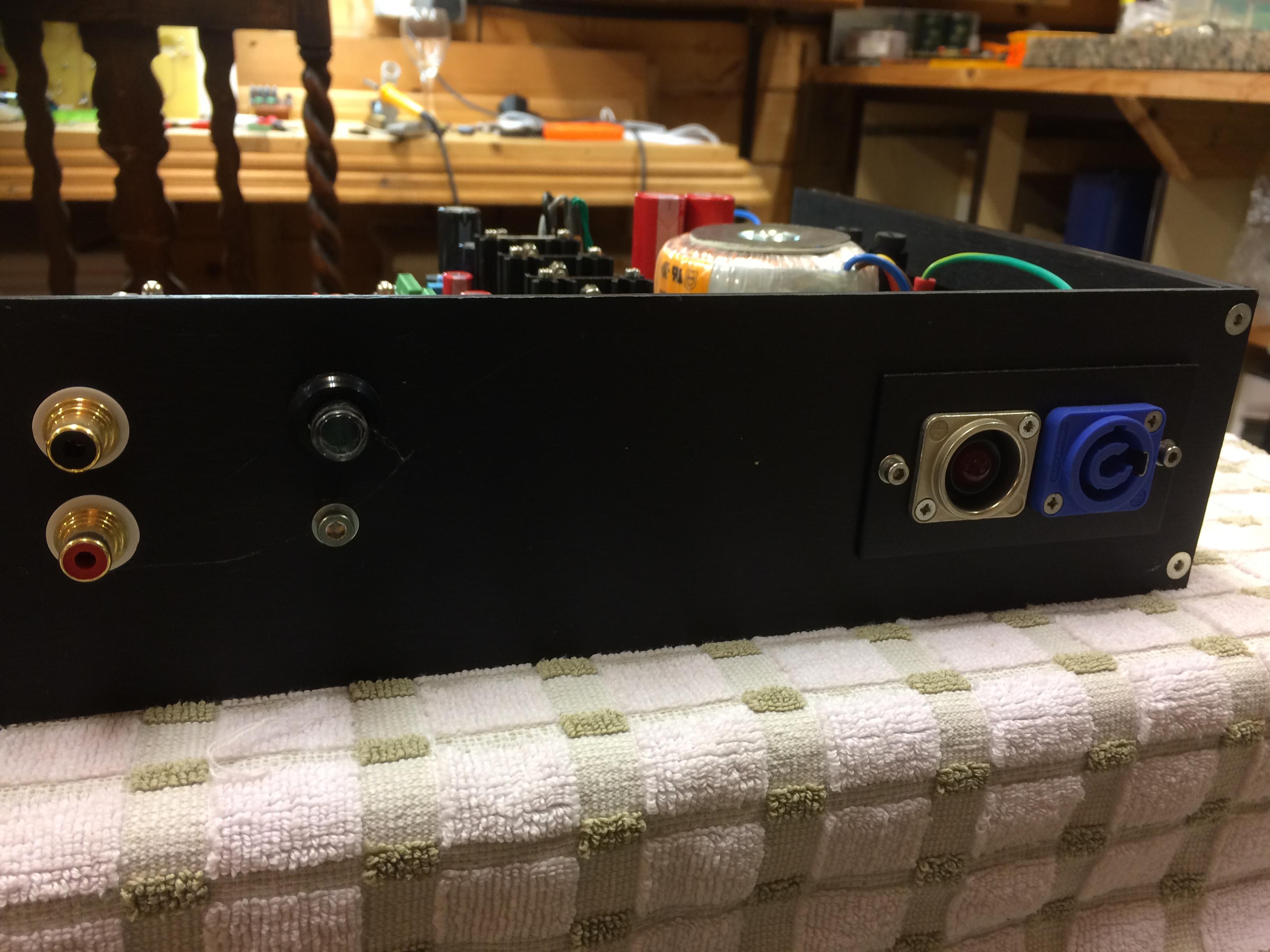

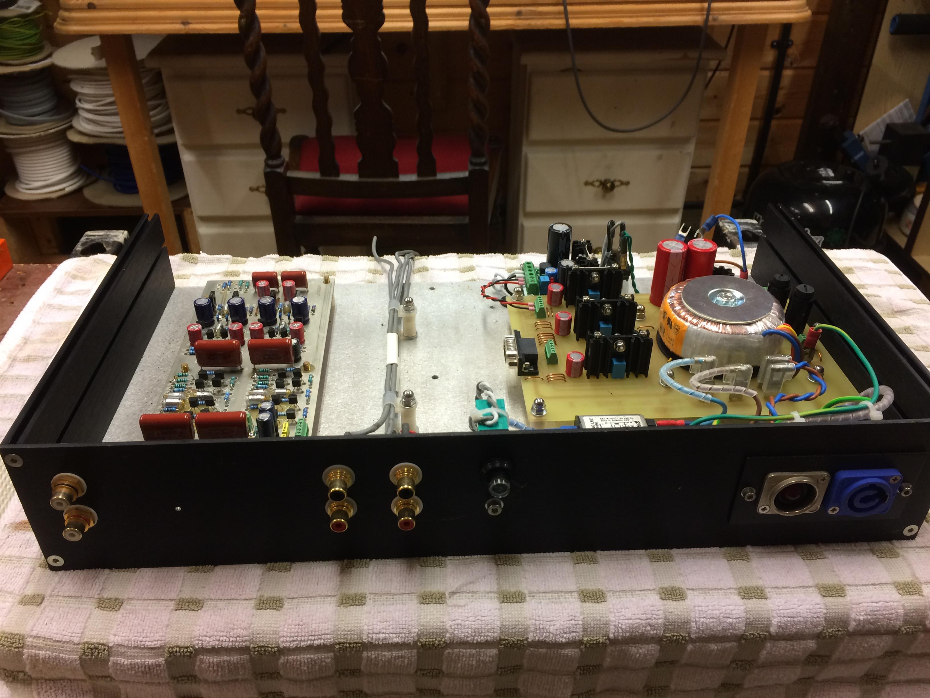

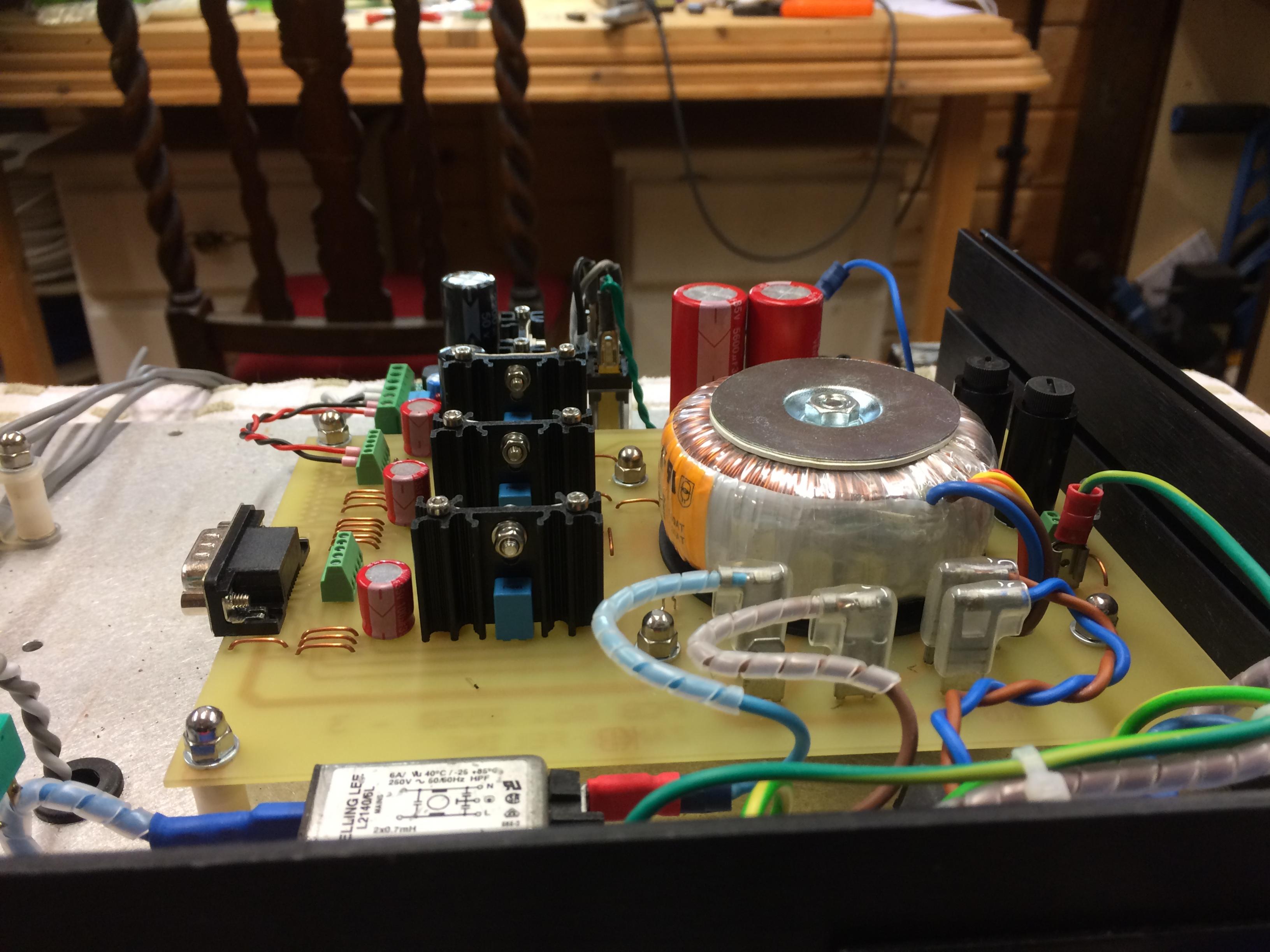

Hello quick update .. pcb's all mounted and PSU tested all OK

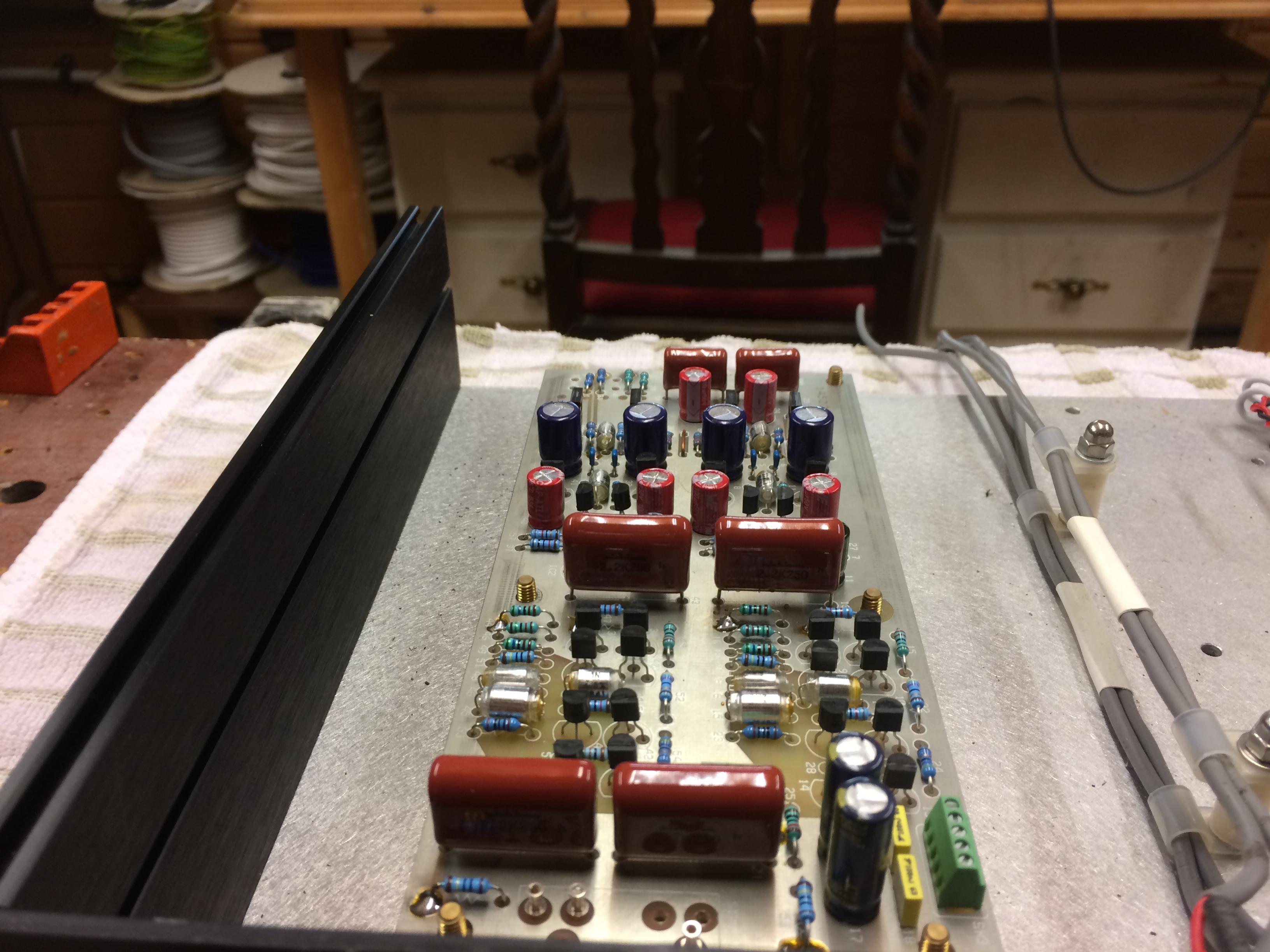

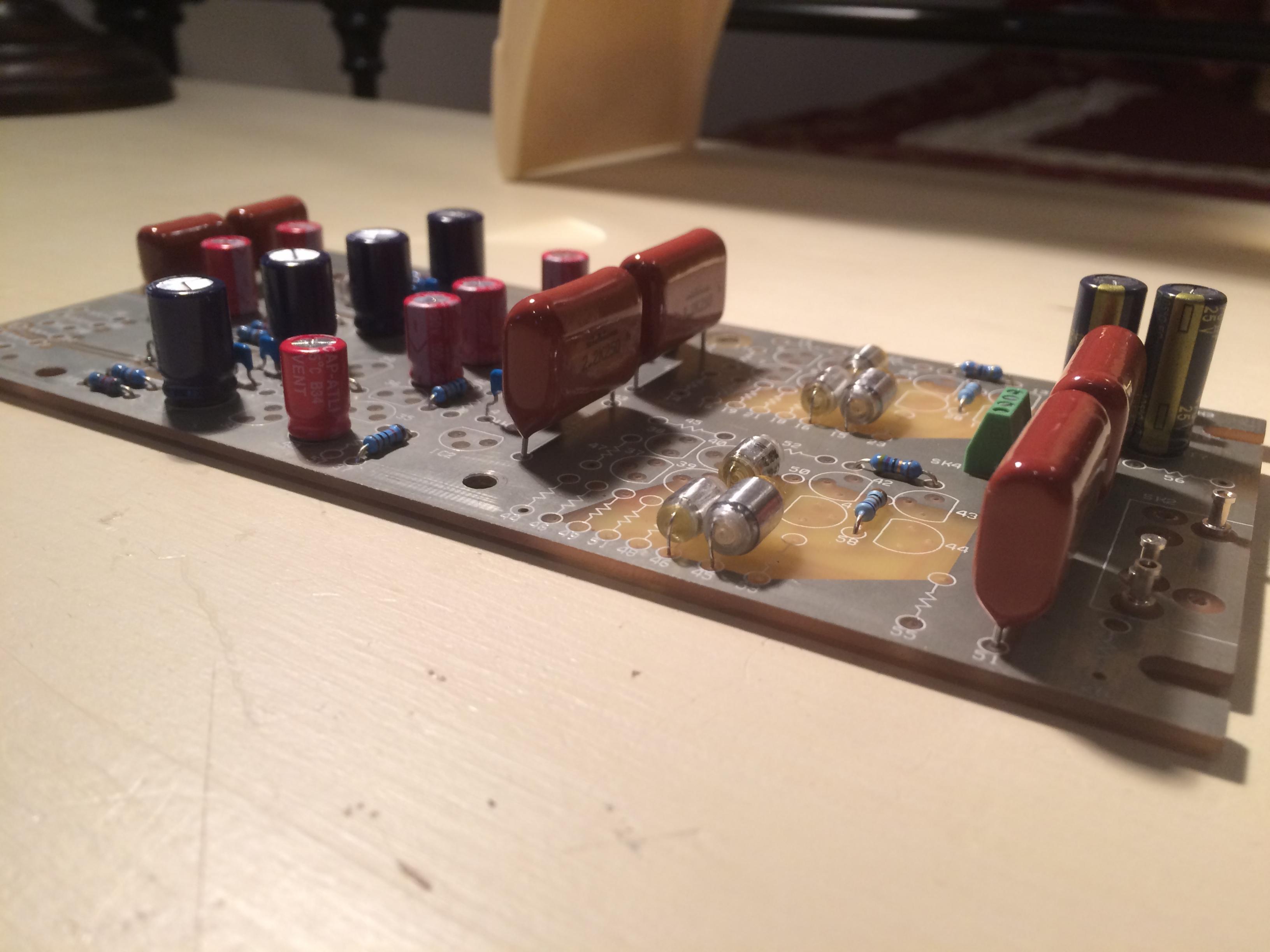

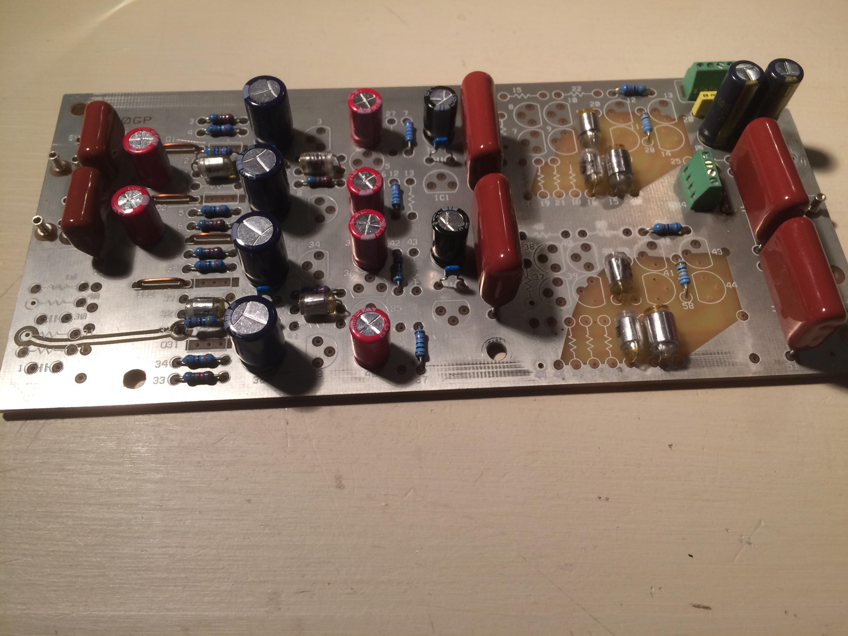

A few pictures as a quick update .. just need to mount the transistors and a few resistors
.. now need to start looking at turntables for purchase:rolleyes:

Joined 2019
Interesting.
I couldn't find any JLH pcbs so decided to make it my 'learning about KiCad' project and based on the schematic on Paul Kemble's site.
