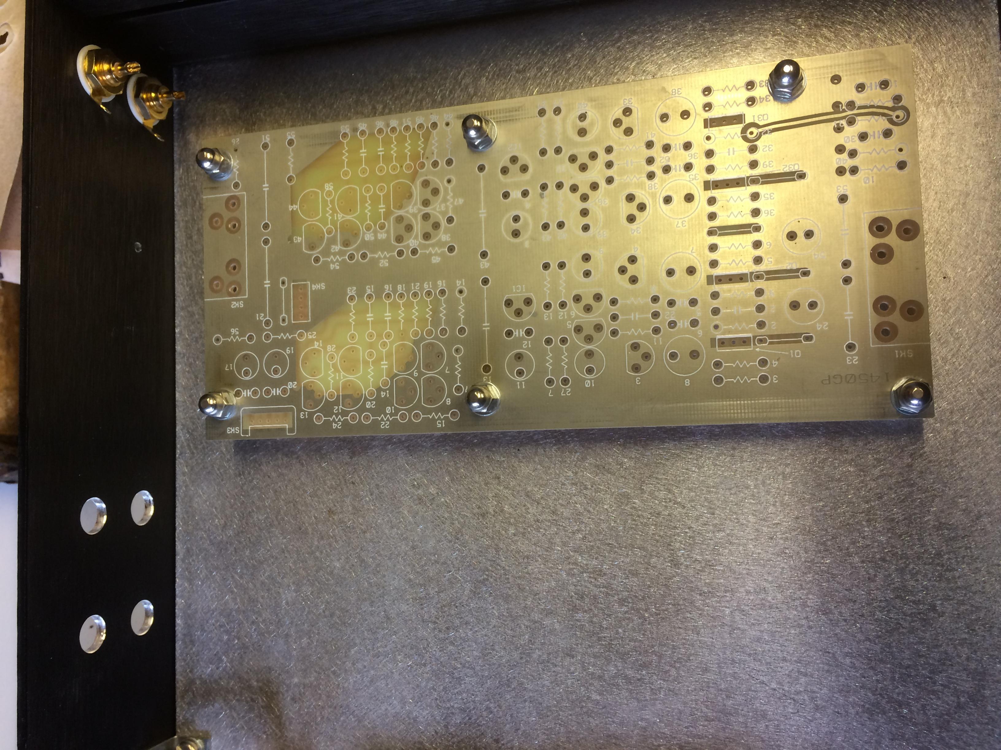

Hello forum members
finally decided to have ago at the JLH phono pre amp project. Have managed to pull most of the parts together passives and transistors etc. I have the original PCB and a new power supply board.
will upload some pics later when back in the workshop
regards
Bespoke Constructor
Joined 2006

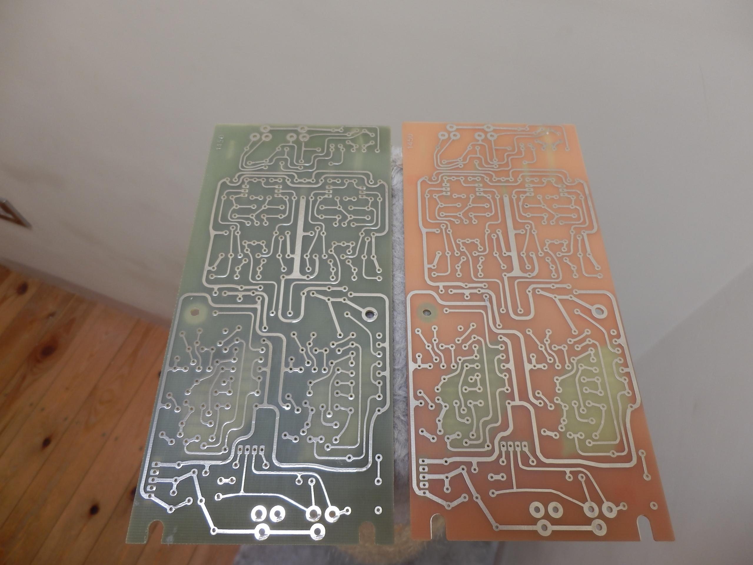

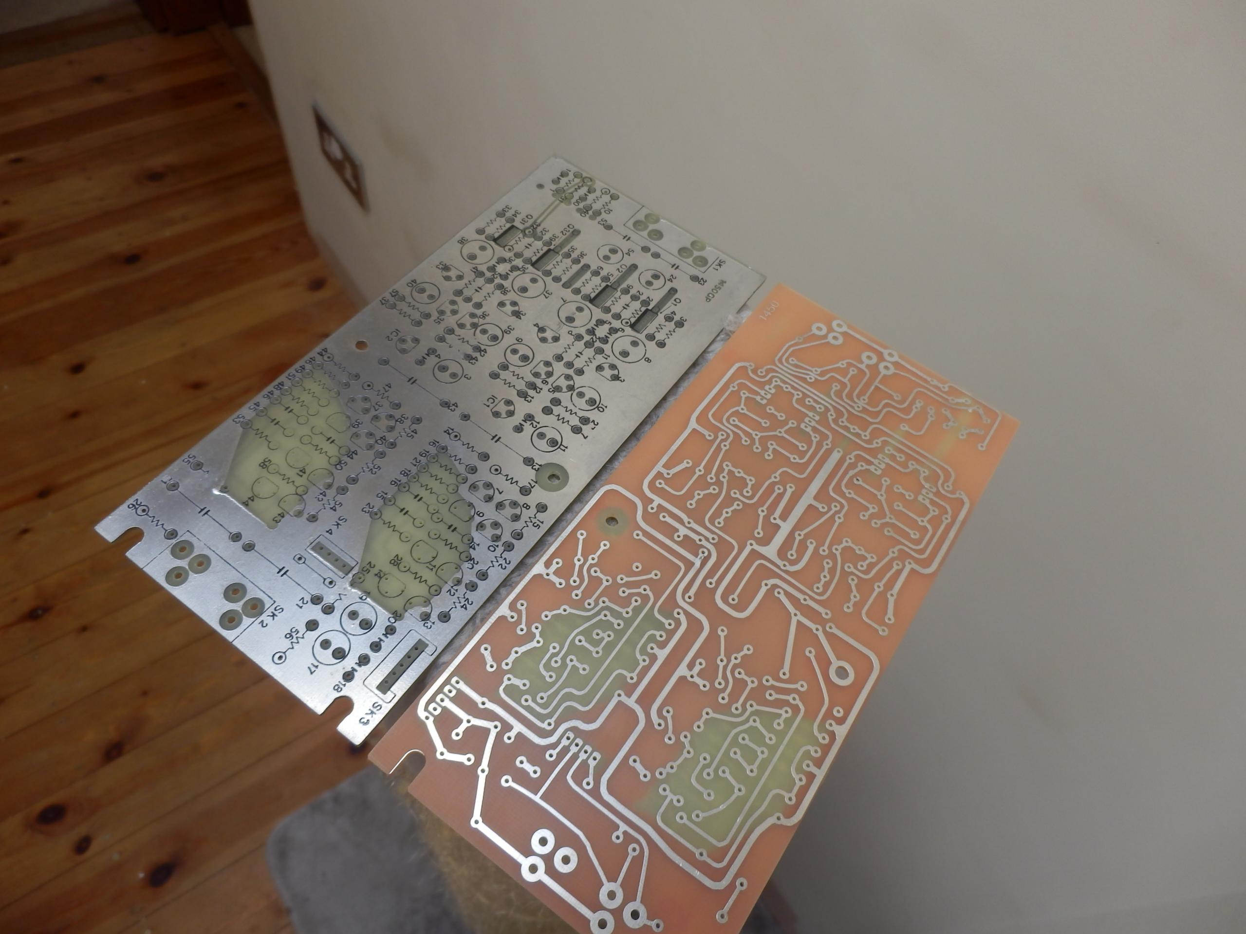

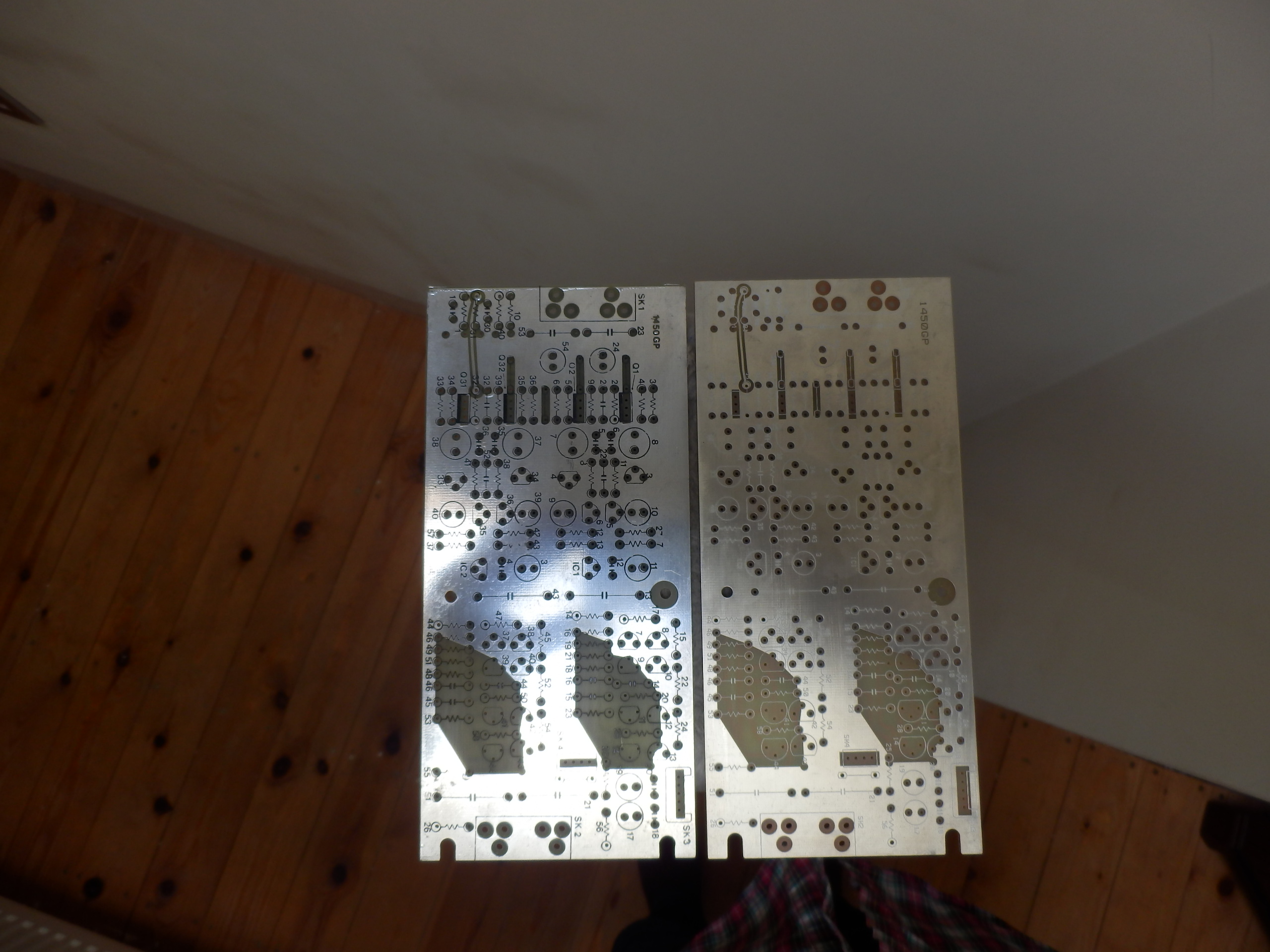

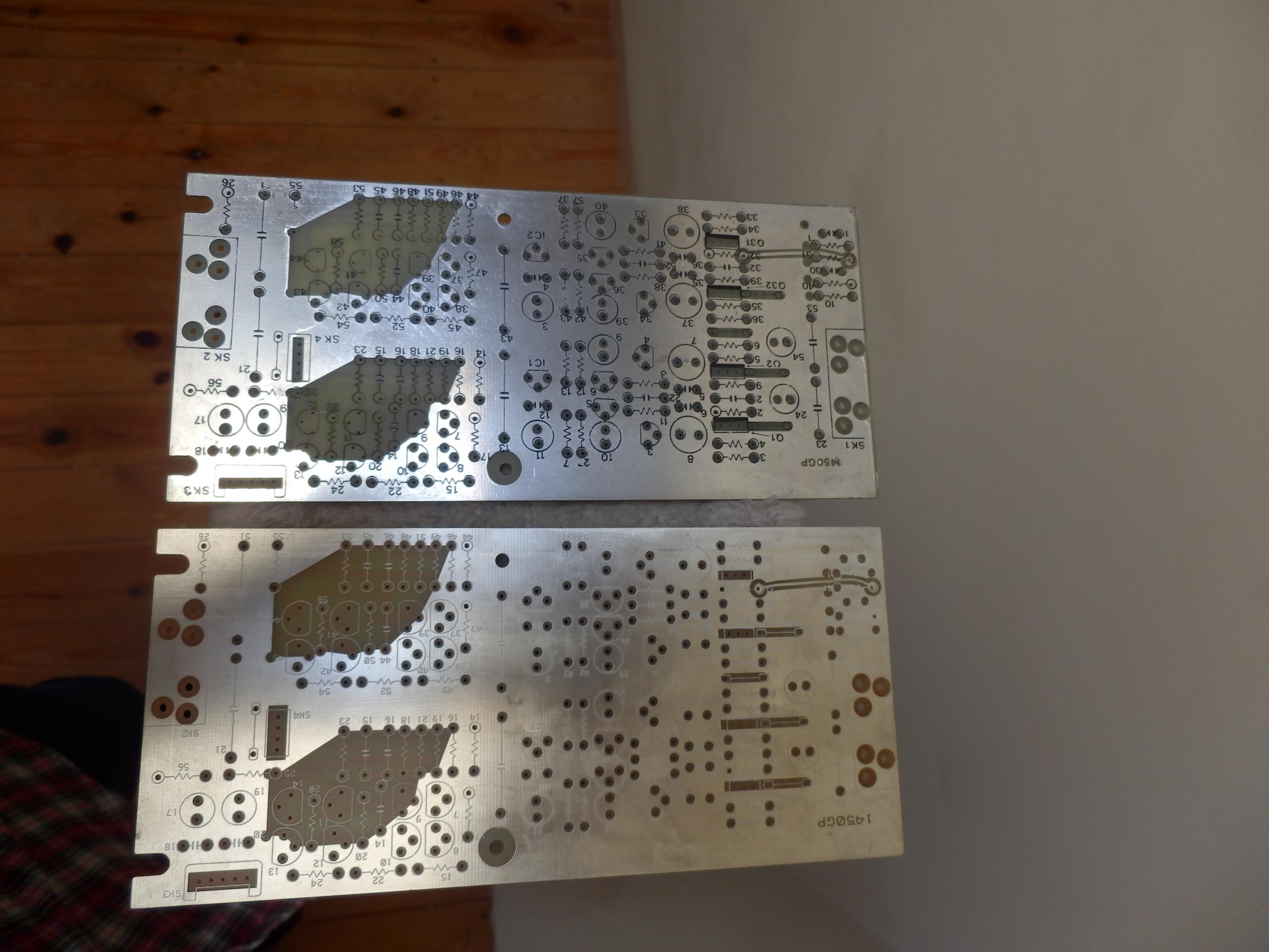

couple of pics of the phono PCBS (2 shown in the picture but only one needed for stereo)

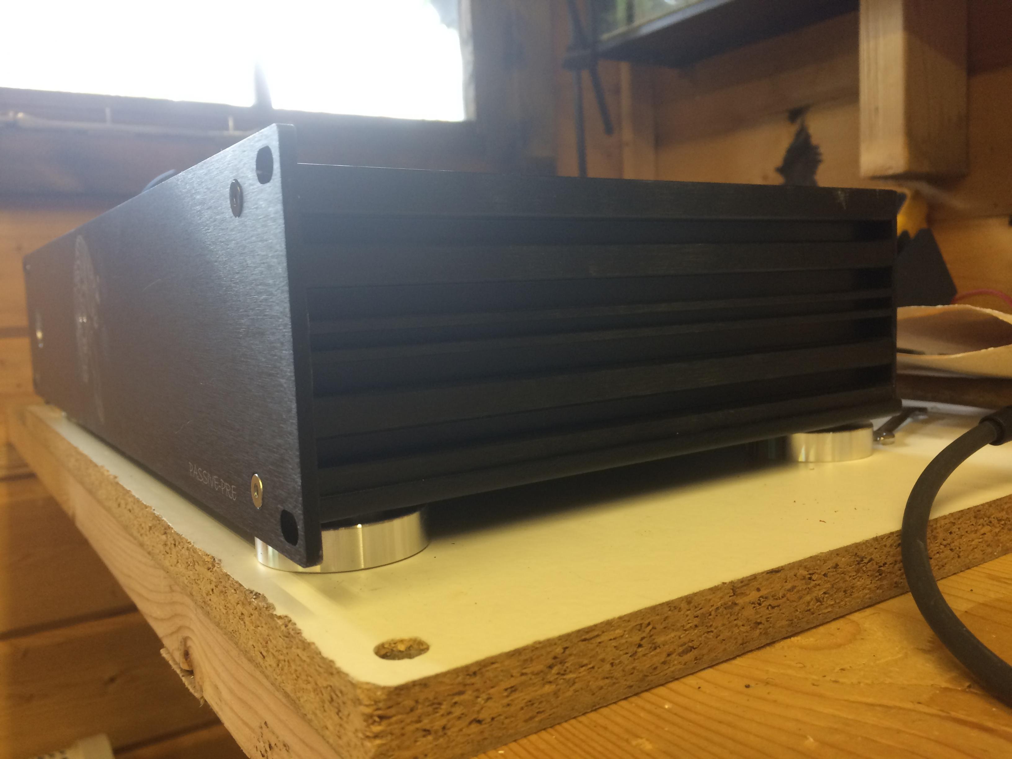

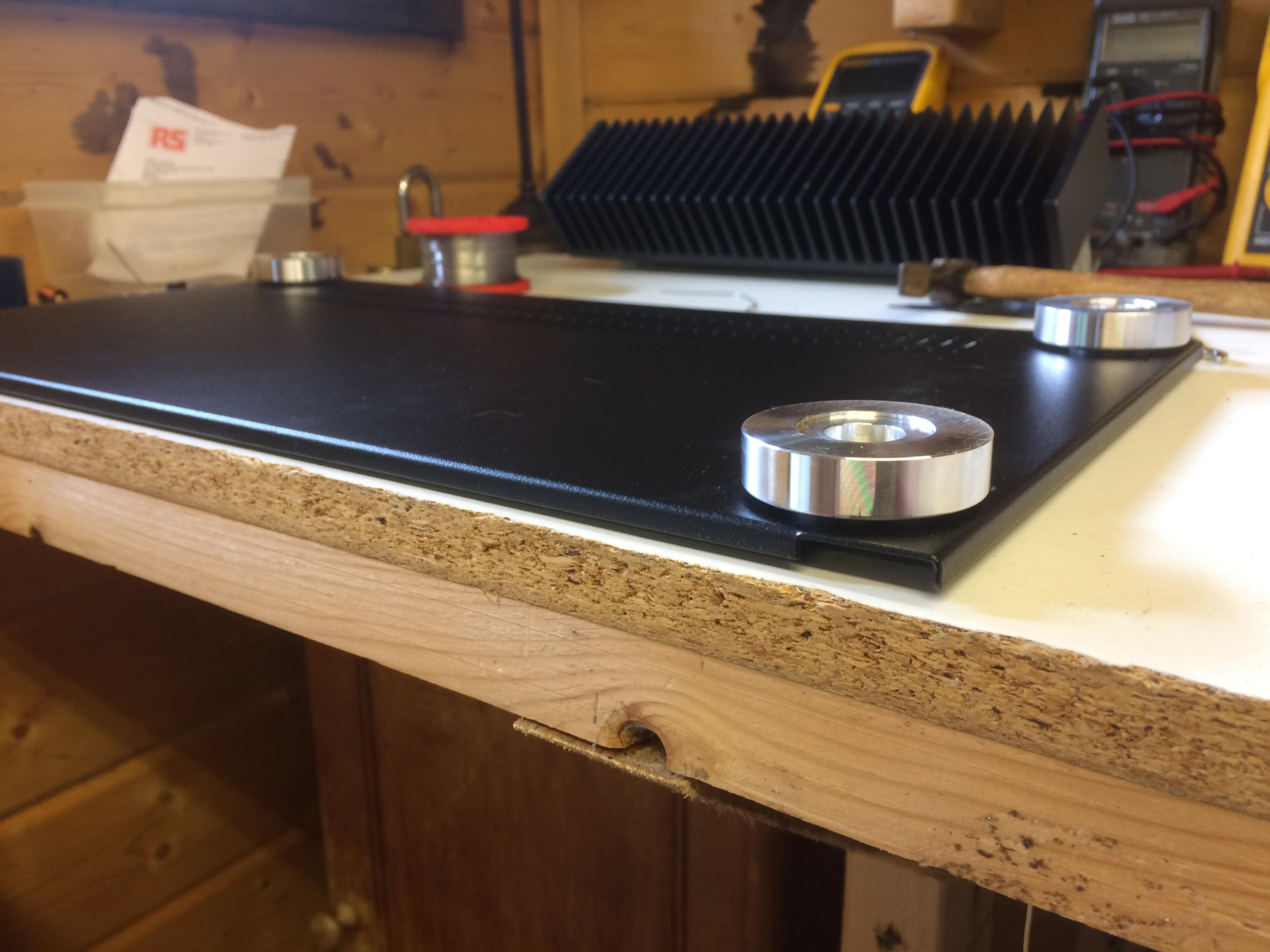

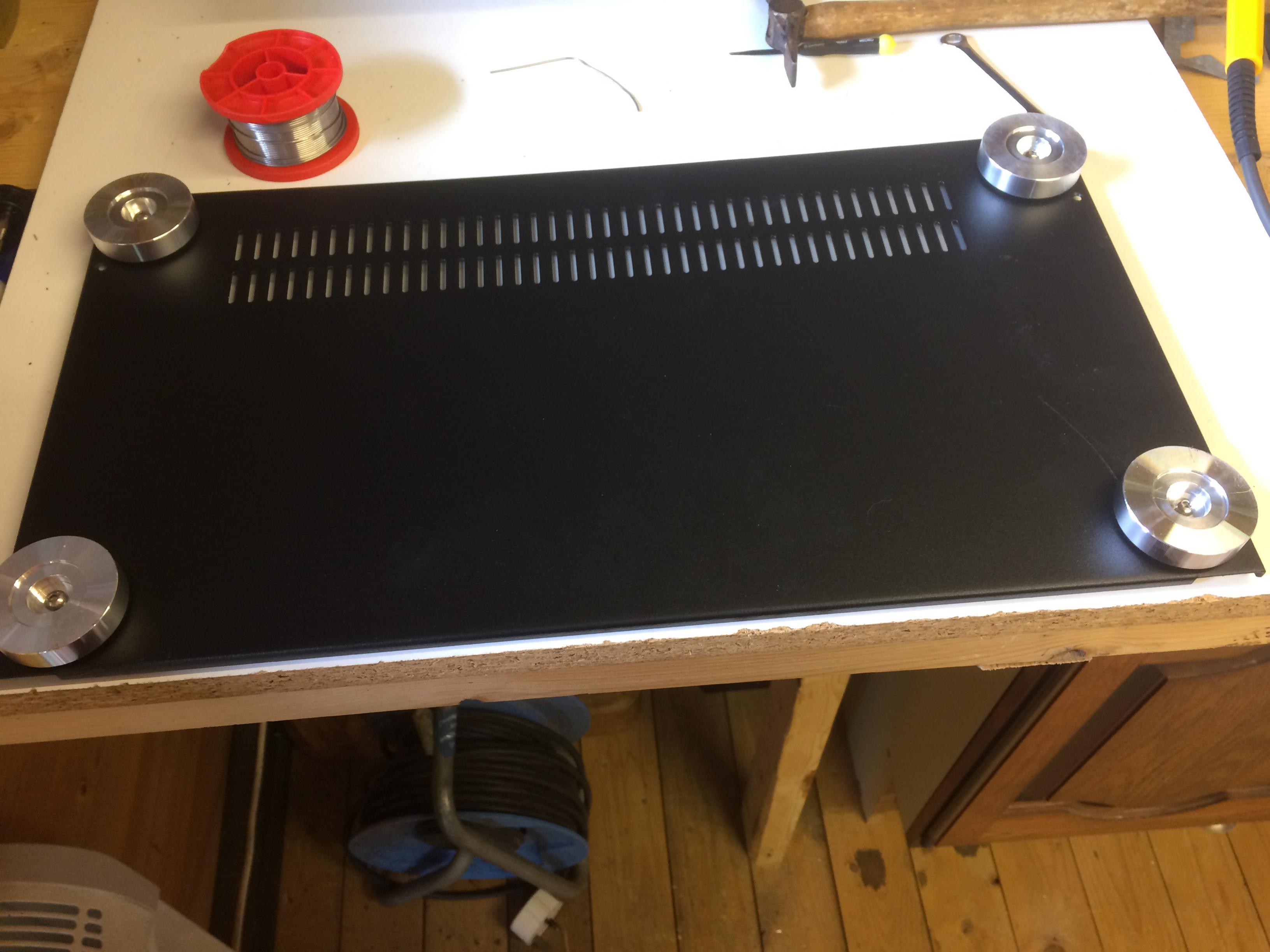

Hello going to use a hifi 2000 aluminium rack case to match my other builds
couple of pictures of the feet being prepared
once completed the feet will have felt pads added, these are solid aluminium

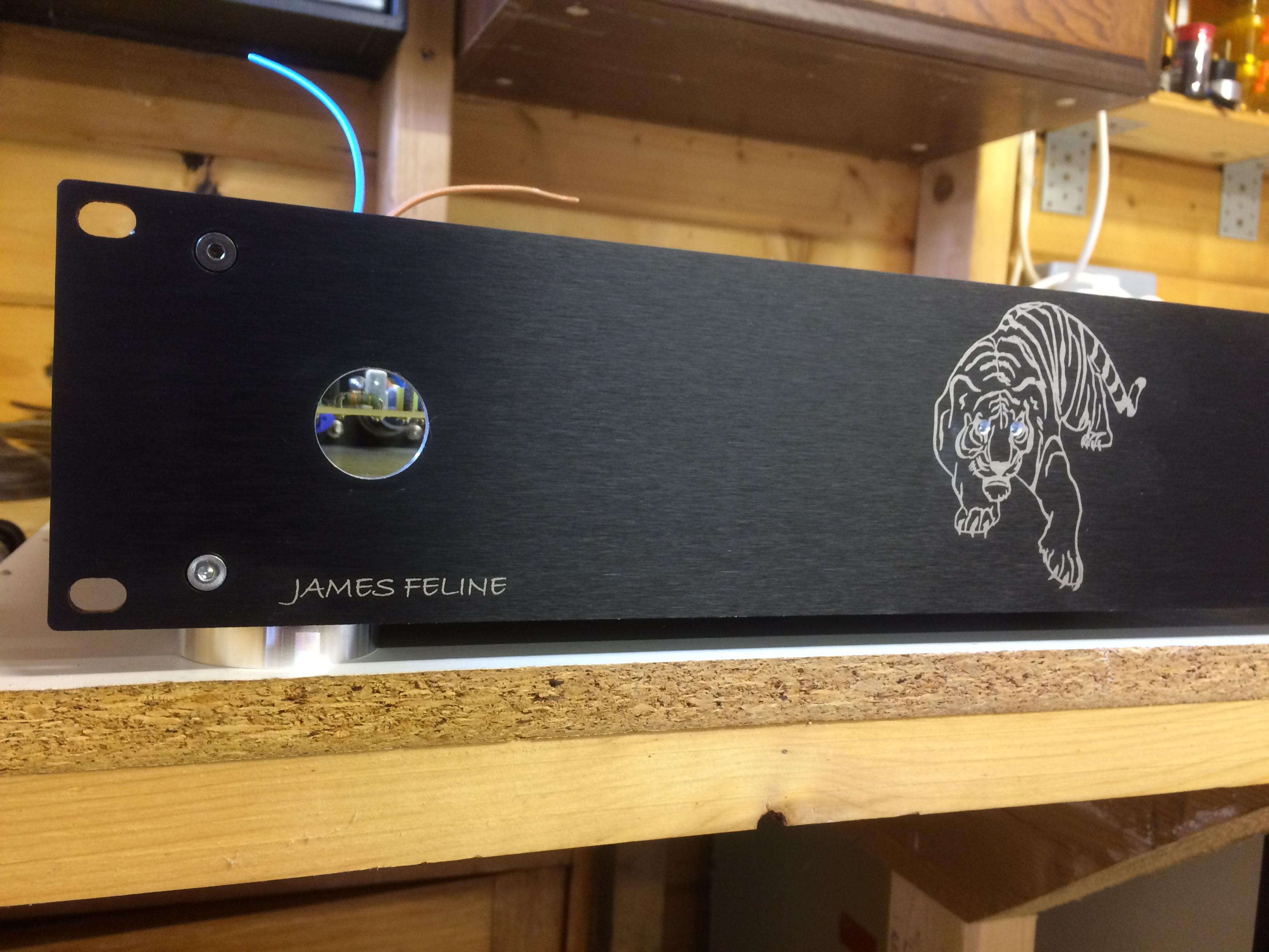

Bespoke Constructor
Joined 2006
quick picture of the front .. don't worry the counter sunk bolts will be changed later so they match .. plus waiting for the master on/off switch to arrive via mail order (RS) .. plus cats eyes not fitted yet, need to decide colour

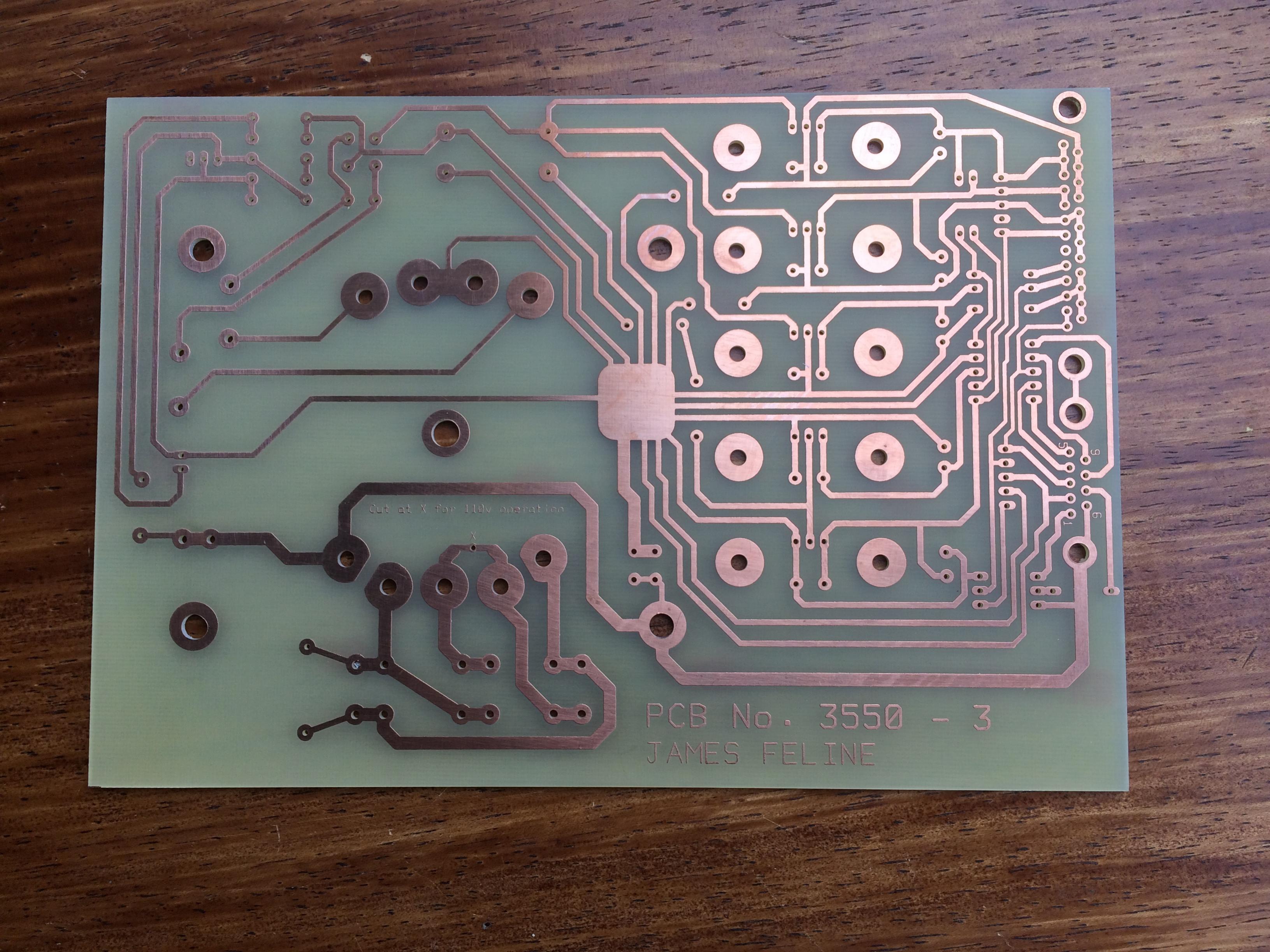

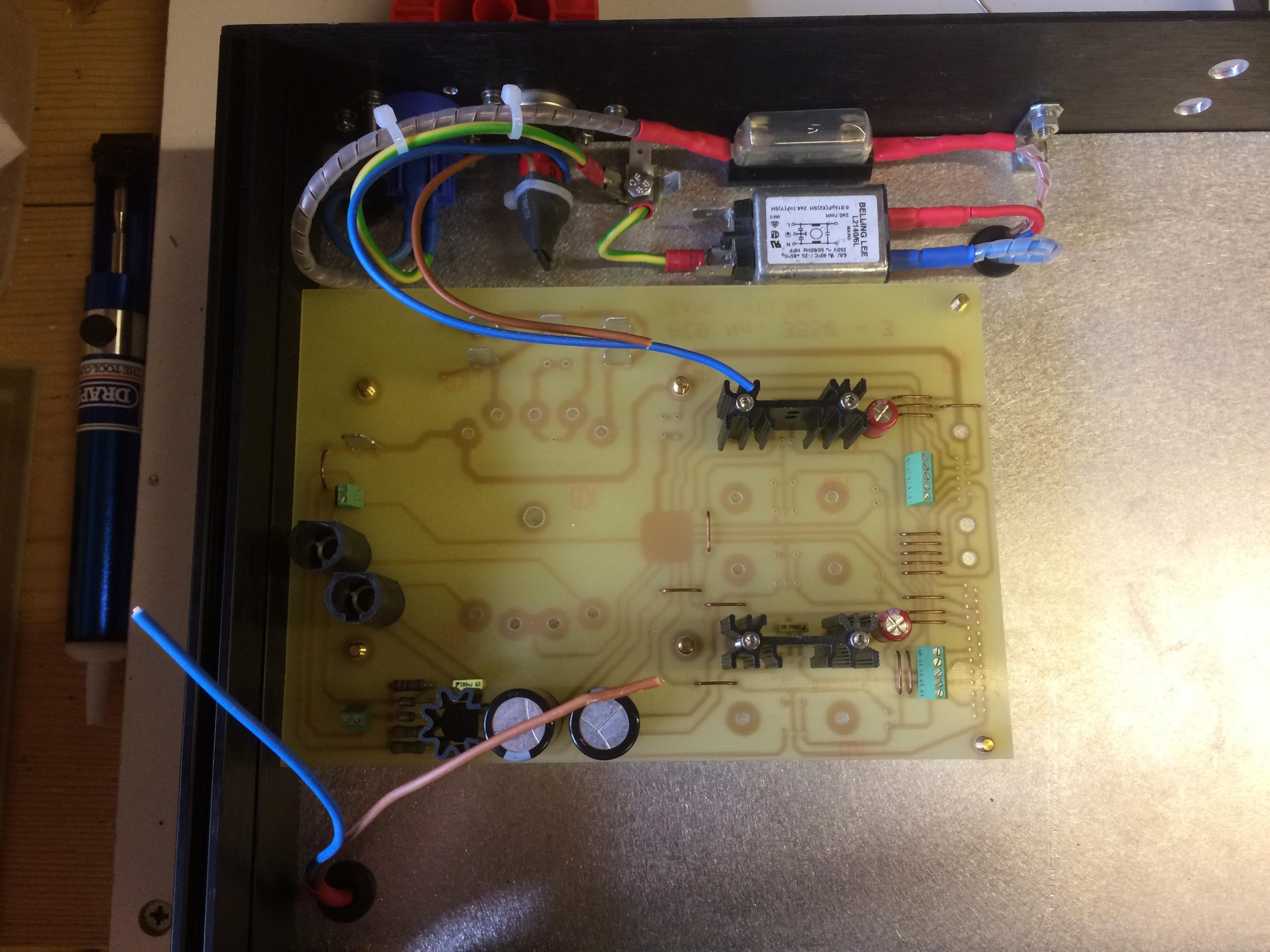

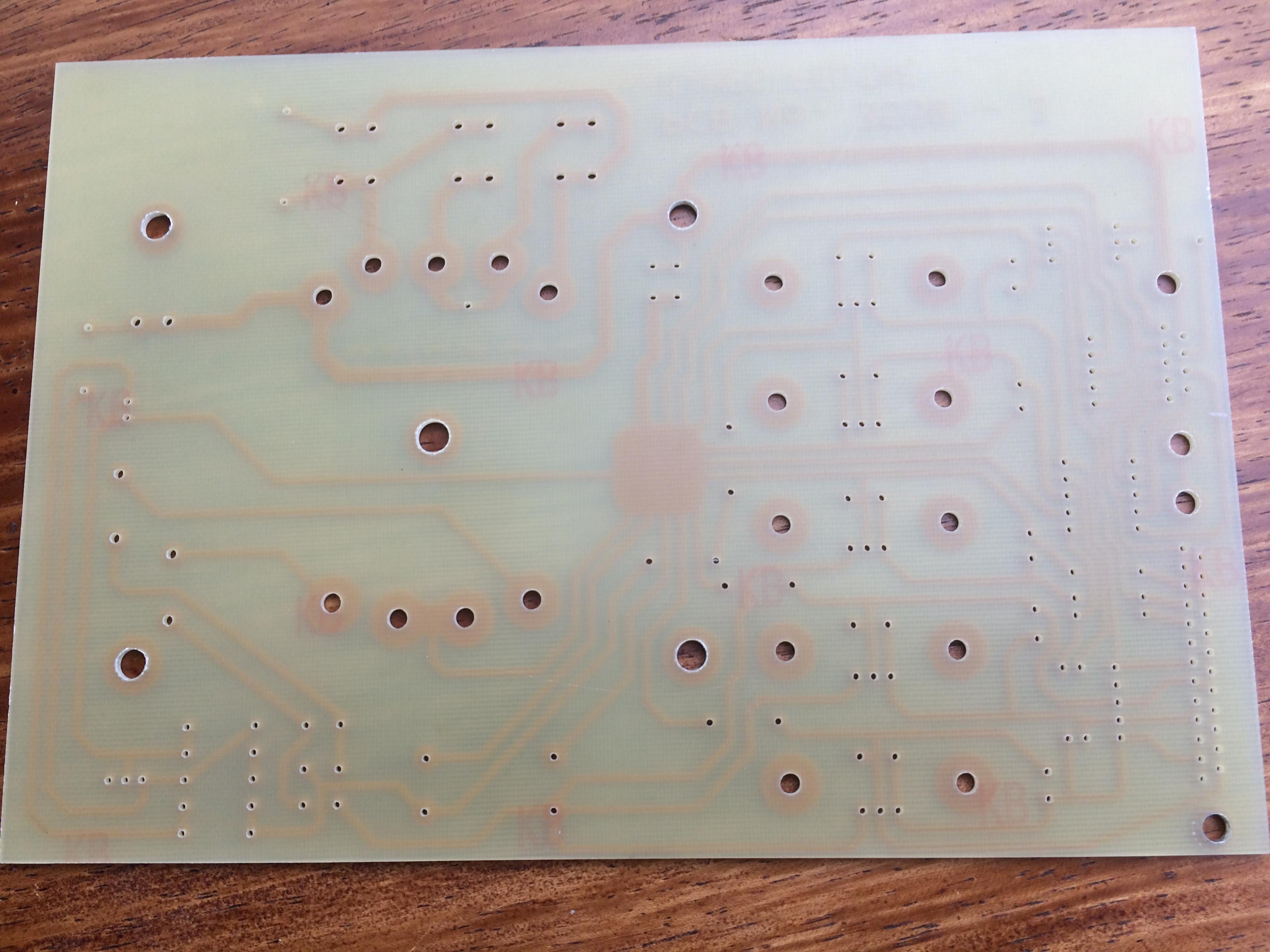

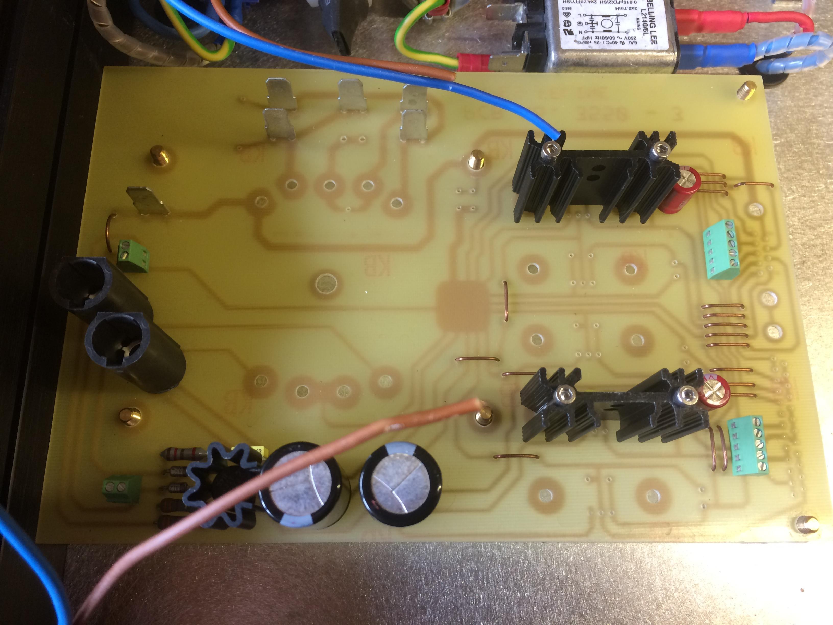

Bespoke Constructor
Joined 2006

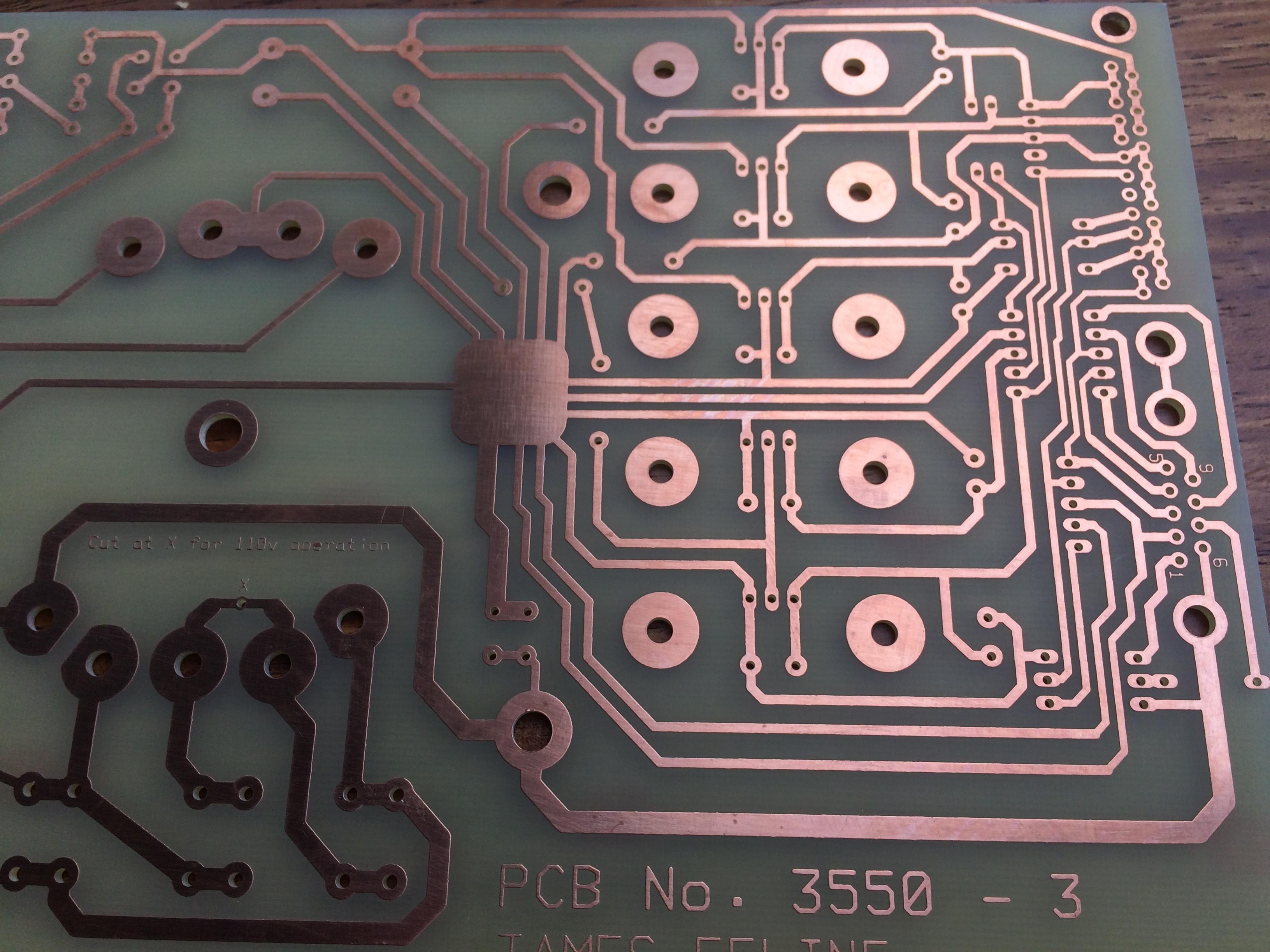

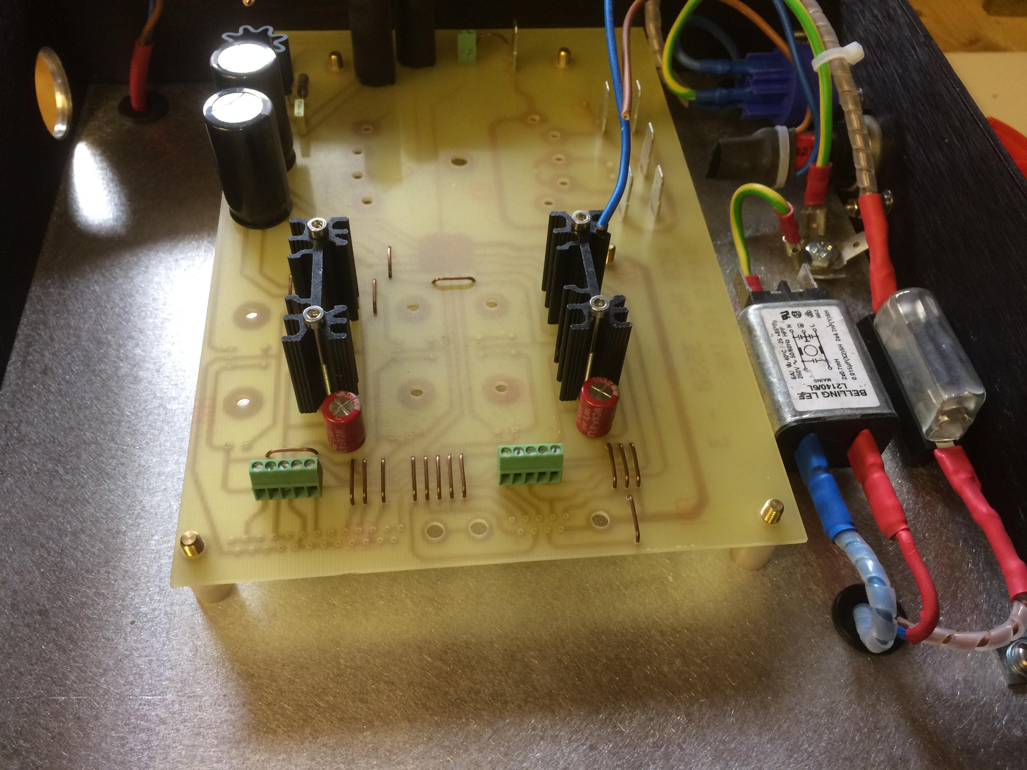

Hello ... on this project I have decided to make the phono preamp with the original power supply when available as a kit from Hart electronics.
These pcb's are no longer available so have made my own as a exact replica .. purely for retro .. nostalgic reasons :rolleyes:
I like the PCB for central star earthing plus can be used for many other projects if needed .. also I have used 2oZ copper for the PCB tracks
more to follow when completed

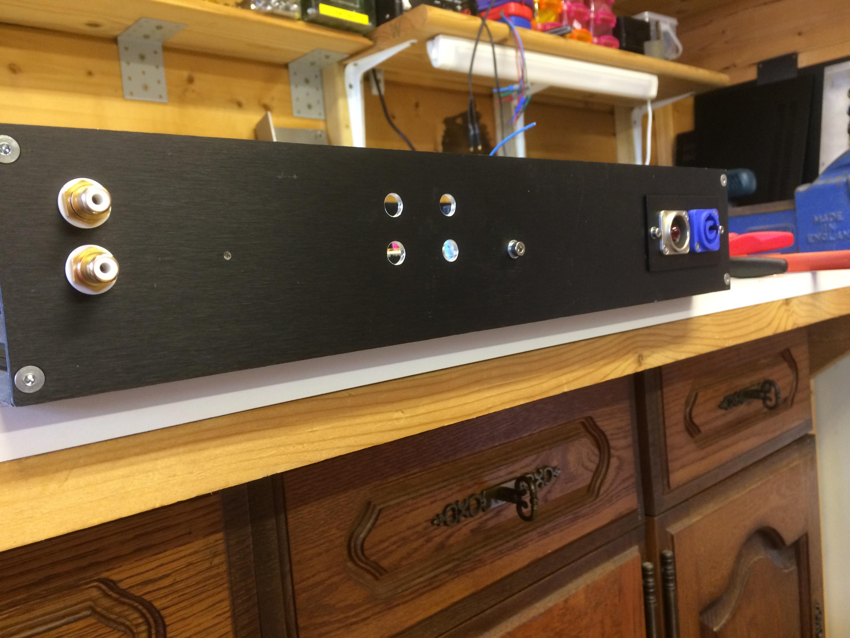

Bespoke Constructor
Joined 2006

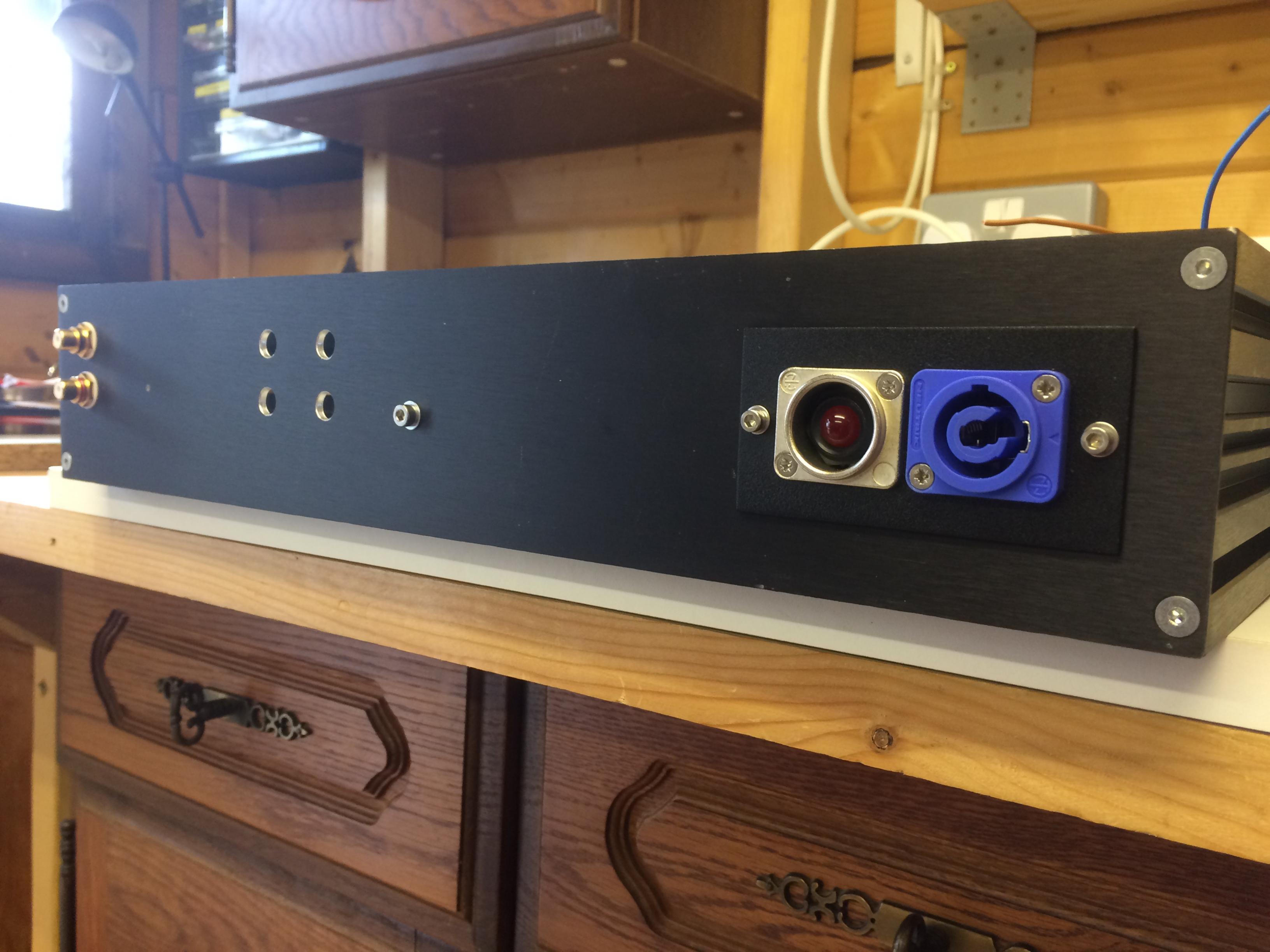

Ok people .. some more in progress pics from tonight
so a rear view .. we have mains in and power indicator at the rear
2 sets of inputs (MM & MC) plus the output phono sockets .. just need to add the MM /MC switch and the PSU earth lift switch .. then some engraving to finish the rear off
regards

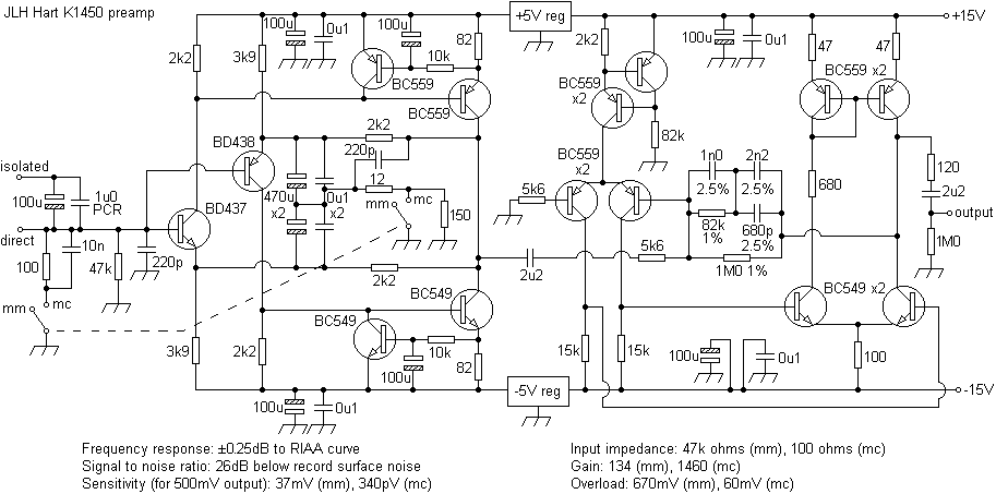

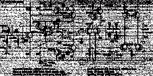

Hello James, (or is that the cat's name)
That's looking very good so far, took me a little while to work out what you meant by cats eyes! Obvoiously your 'trademark'.
ISTR that Hart did kits for ETI magazine projects. Was this one of them ? If so, do you know which ETI issue it was in ?
That schematic you posted is the same as the one on Paul Kemble's site. The specs at the bottom have quite a few typos. Nothing important but I'll post corrections later.
I also noticed on the Kemble page that there may have have some mods, like reducing gain of MC input to mitigate bass roll-off. Did you get any documentation like updated schematic, updates, etc. with your board ?
I'm currently looking at phono-preamps for a new preamp build. I put this one into LTspice and on 1st look it's pretty good - very flat RIAA eq, except for a little bass roll-off from the 13Hz rumble filter. This is a candidate, also it's op-amp based cousin the K1500. I just want to work with the correct upto date circuit, that's all.
Simon
Bespoke Constructor
Joined 2006
I will try and upload a PDF later .. this was the original Hart shunt feedback kit k1450 this has had many favorable reviews from Vinyl enthusiasts .. I built the less complicated op amp version years ago and was very pleased with the results .... plus I am going to purchase a turntable hence this project ...
regards
