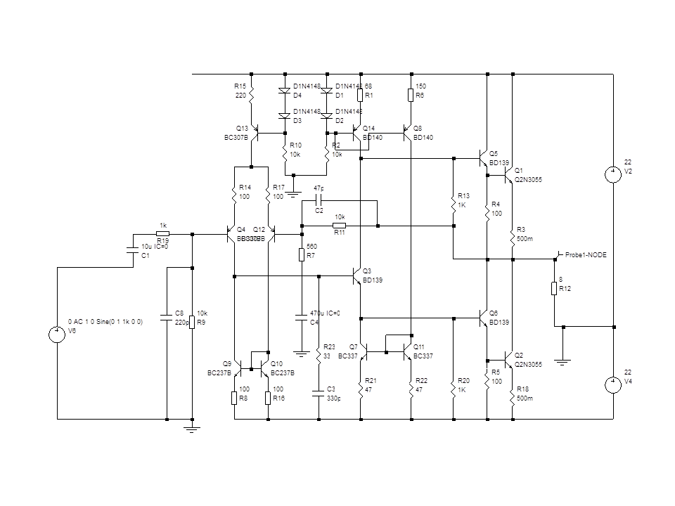

Taking Andrew T's challenge, I'm posting this experimental variant of JLH's 10W.
The concept is as follows:
Use D.C. coupled output - needs diff. input pair.
Use current mirror (now standard practice in one form or another)
Output stage: this is where the unusual bit is. The main issue with the original design is that the base current increase in one half can only be provided by a decrease in the other. Because the current gain in an output transistor of the old days falls quite dramatically with current, the increase in current in one half is not the same as the decrease in current in the other. So the average quiescent current had to be set higher.
To remedy this, local feedback is needed. That takes the form of (a) a medium value emitter resistor in the output (b) a driver transistor with medium base resistor too and (c) a 1k bias resistor which sets the current and input impedance, largely.
The voltage amplifier stage uses a standard JLH design in keeping with the original, with CCS load and CCS bias. This is the second unusual bit. In order to bias the output stage, the 1k resistors need a voltage drop of about 1.8V each. So the CCS which starts at 10mA drops after the upper output resistor to 8mA and then again to 6mA for the lower stage. To ensure that the lower stage does not then upset the balance, a CCS stage is used to shunt the excess current. That is fed by a second CCS stage from the top rail but could also be set from the ground rail.
The bias current can be adjusted by altering the current in this second CCS by making R6 a variable (with limiting resistor in series of course).
HF compensation is done with a global compensation capacitor and additional RC phase delay C3 R23.
The PSU voltages are 22V for 16W output.
THD at 1kHz is 0.003% but rises to 0.04% at 20kHz at 10W using epi 2N3055's.
DIY-ers are welcome to make suggestions to improve as I have not built and tested this yet. At 900mV input, another key point is that no transistor cuts off up to at least 200kHz. I think that will eliminate any practical possibility of transient or slew distortion.

Darlington output etc
I have copied my post in the 'vanilla' JLH69 thread to here for reference and now posted circuit diagrams etc.

Circuit diagrams derived from Geoff Moss' modifications
To give some background to my post above, I have put my circuit digarms into Visio and pdf'd them.
To start off with, bear in mind that the excercise was one of experimentation and wanting to try different driver and (predominantly) different output stages.
Consequently, I split the amp into 2 phyisical parts/boards that are linked by a short (3cm) umbilical cable allowing me to mix n' match easily.
(a) a driver board that can accomodate a standard configuration or a S-Pair driver.
(b) an output board that can accomodate standard single output pair, multiple output pairs (up to 4) or darlington output pairs with their current sharing resistors.
These were the basis of the experiments that seem to work out quite well.
Here are the cicuit diagrams. Some additional components were added to make Geoff Moss's driver board more acceptable to my engineering pedancy - some stopper resistors on the presets and an input shunt resistor to keep the input cap charged
I have to admit that I do like the single input transistor geometry: LTPs bring a plethora of problems that have to got around.
Kind regards
Mike
