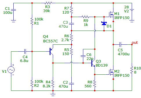

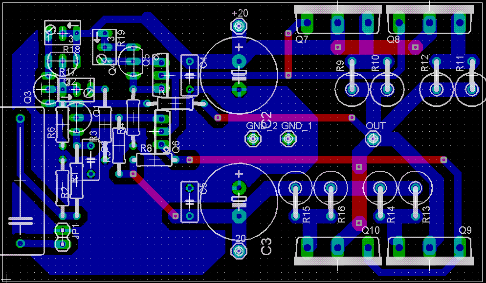

I'm keen on building a pair of (updated) JLH amps to drive the tweeters in my bi-amped system. I've devised a pcb for them, and i'm currently seeking validation and maybe some tips for improving the layout.
The schematic can be found at this site .
I'm attaching the current layout here.

Khron said:Greetings everyone...
Personally, I would move the caps to the other side of the power transistors so that the feedback path is much shorter.

If you are going to use it for your tweeters only, why need to double up on the power transistors, one pair would be more than adequate for 10 watts or so.

Now your tweeter amp is class A - which is good. Its phase response is good. I would drop the output to say 5 watt which is more than enough (supply about 15V).
My opinion is that it is not necessary for the extra expense using a center tap transformer here simply because your output cap for the tweeter is relatively small (<10uF/25V).
Furthermore, the PCB has shrunk even more and you may be able to fit it into the small box with "smaller" heat sink🙂

Well.. Frankly, i was thinking of powering them from the same PSU as the woofer amps, and with a high-current regulator (LM317/337 with some solid pass transistors), with +/-20V or something like that.

Hi Khron, please drop the Mr. I am only 1000 years old. Personally I think about 5 - 7 watts is good for the tweeter, then you can easily regulate with a single LM337 per each without a pass transistor.

Khron said:I took your advice and moved the caps. I had a bit of work uniting the grounds, but i hope i haven't messed it up more than it was before![]()
Now this is a great looking PCB I like the star on the output, you have the right idea here.

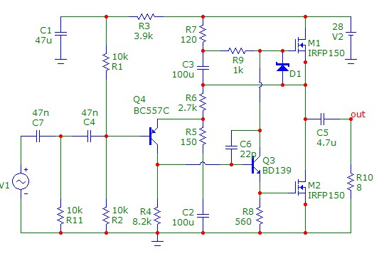

Hmmm.. speaking of reducing power... What component modifications would have to be done in order to reduce Iq ? 😕
(Referring to the schematics in the link in the 1st post)
Final suggestion, run the gnd on the bottom plane and the speaker terminal and track on the top, then your gnd plane is continuous.
Khron said:Hmmm.. speaking of reducing power... What component modifications would have to be done in order to reduce Iq ? 😕
Iq should be dependent on the setting of VR2.
I would, but i did my best to keep it feasible on a single-sided board, and only jumper wires on top (thin or thick, depending on what signal / current they carry).
