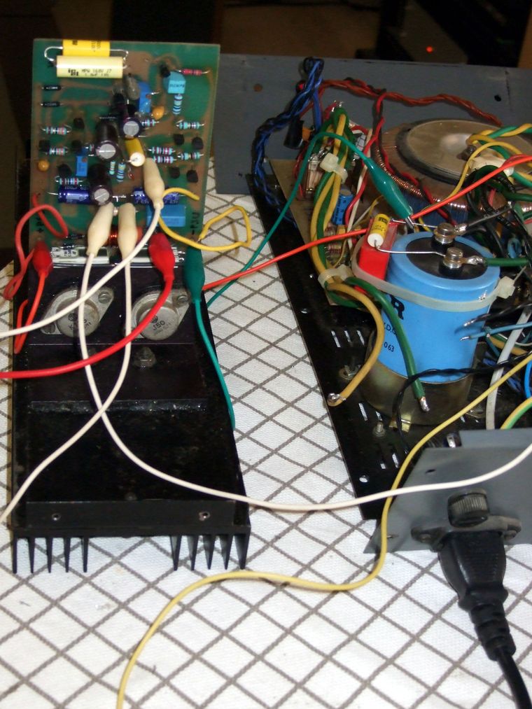

1nF & 4k7 gives 4.7us RF and Audio filter.
How low can this go and still stay free of oscillation? 330p, 220p, 150pF?
As far as I can recall JLH usually used the full Thiele Network on the output.
I had tried 330pF SM and it oscillated. That was when the output Zobel was still missing if I remember correctly.
Bandwith and phase response must be computed without input
and output filters to give an idea of the amp s caracteristics.
With the filters connected, the picture is made way more rosy,
although adding a zobel network will not change the THD ratios,
moreover at frequencies as low as 1KHZ.
Should have been the restoring of BC546s or something with renewing the soldering of components or wires then because the THD reduction at 1kHz was real by measurement.
