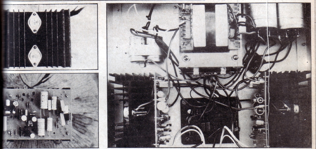

It would need the gate stoppers direct on their pins at least, surely they knew less on that construction (1984), but it apparently worked as depicted. They even tested their build as 100W on 8 Ohm 20Hz 0.01% 200Hz 0.004% 1kHz 0.003% 10kHz 0.02% 20kHz 0.025%. Maybe it could have measured better if they had D.Self's advice on wiring that became known later. The builder/reviewer had a Systemdeck with Linn basic LVX arm, Grado GF1+ cart, Naim-Nac 32, BBC LS35/A and DIY B139 ported sub with passive cross. His comments were it was neutral with obviously smoother mid-highs than BJT amps he had tested (probably vs NAP-250). He also found the bass taut and strong, noticing it improved there with bigger reservoir caps.

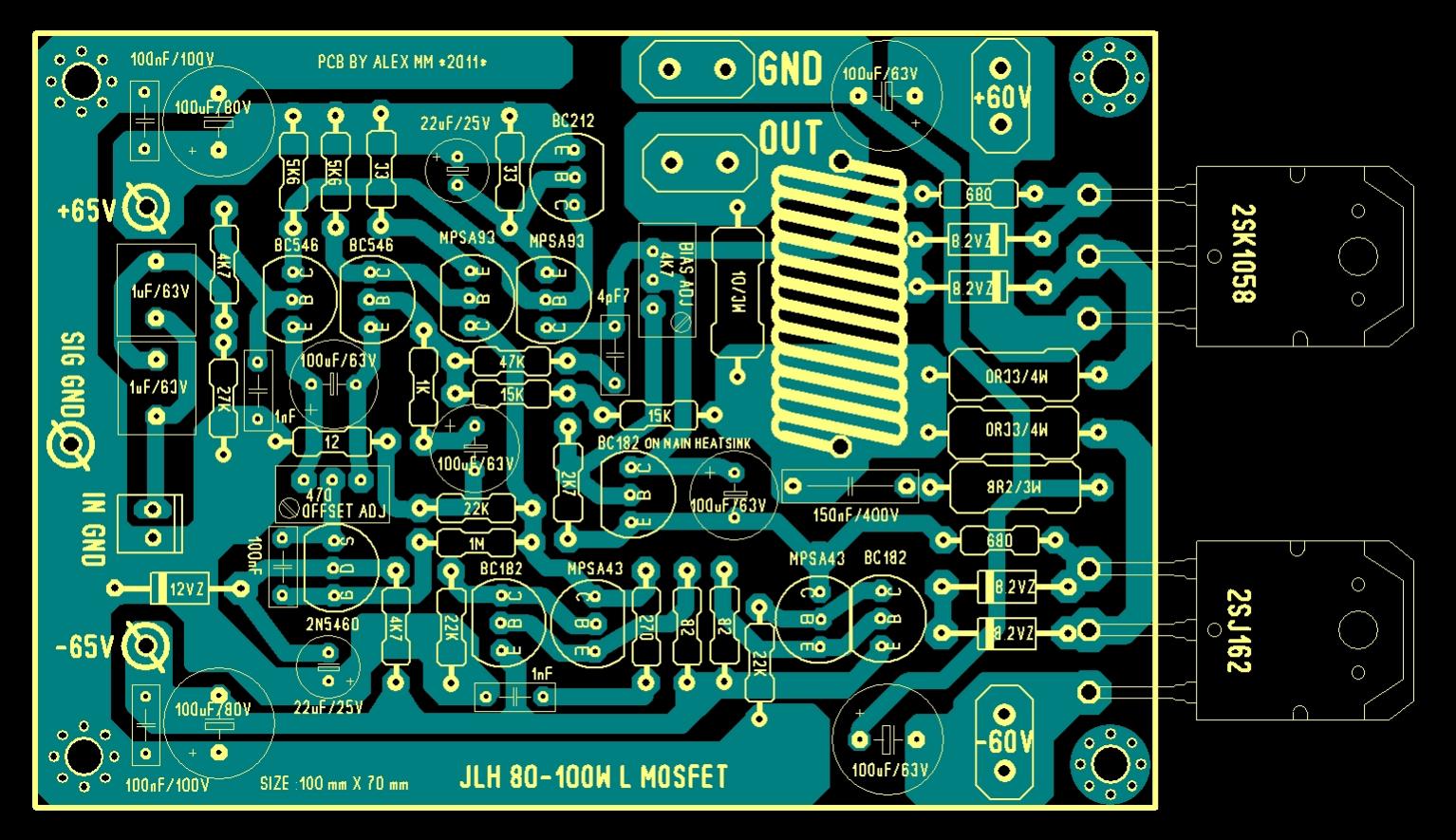

PCB option
.....I have layout PCB for 2SK1058 and 2SJ162 output transistors in 6hours 🙂
it's first try , but I can do better then this .

Ah! This is very nice of you Alex. Now you really breathe second life to the child of the respected designer, a homage since he is no longer in life. Bravo.

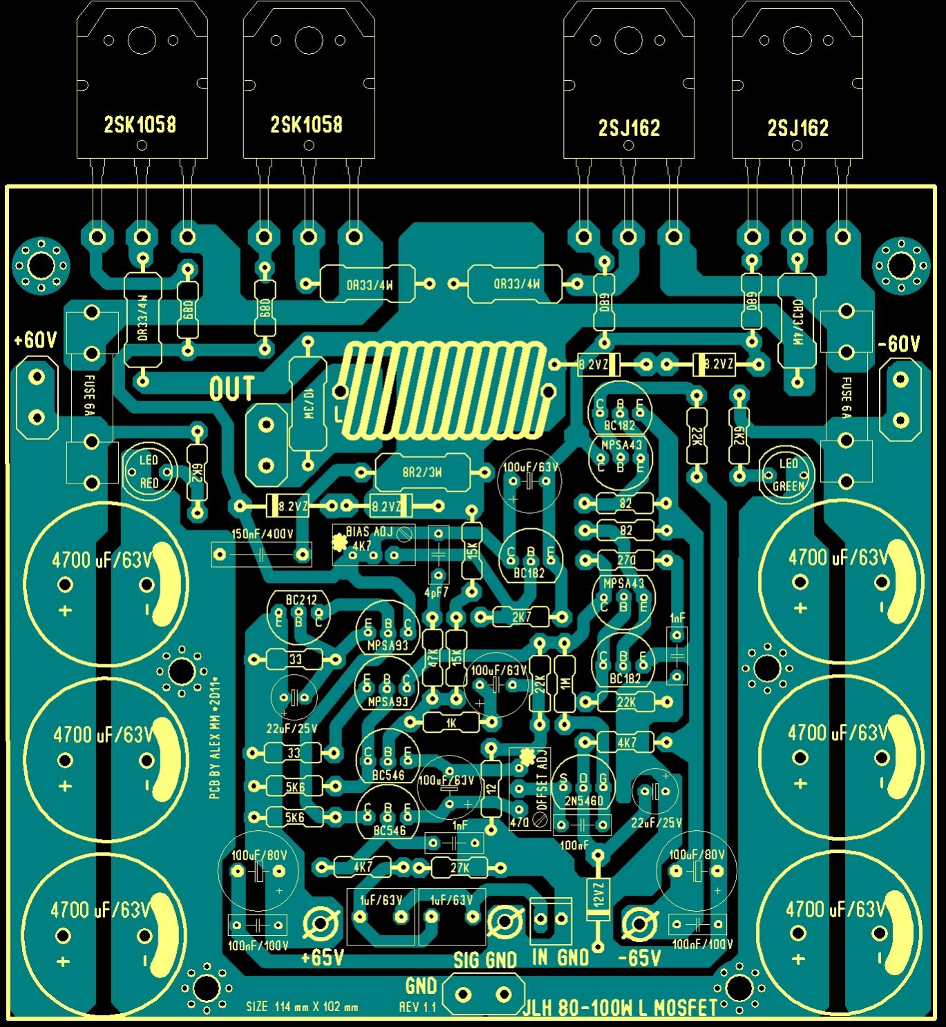

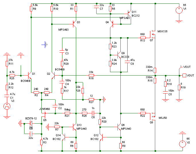

JLH was giving +/-80V max with just one pair K135/J50 for 160W 8 Ohm. So with 2 pairs it can be 4 Ohm rated I suppose. Does anybody see any drive deficiency from the CCSed VAS? Looks like 7mA running in the 200V Vceo driver. Mini-sinks for the MPSAs likely needed if with higher PSU.
I don't recall reading of a JLH Class AB Lateral mosFET amplifier with this spec.JLH was giving +/-80V max with just one pair K135/J50 for 160W 8 Ohm.
Can you refer us to model or article or other source?
...Another thing, shouldn't be the gate stoppers go half value when with two pairs to preserve the same OLG frequency characteristic?

Indeed, using only a pair of these laterals for such high power
is indicative of the early technology it still was in 1982, and as such,
was still not very well understood.
At least two, or better, three lateral pairs is a minimum for +-50V PS
and anything below this quantity is just plainly not enough..
The 680R gate stopper are way too high, 100R is a maximum
value with these devices, and if the amp oscillate with such
values, then it s simply not designed accurately.

A modern simulation of its behavior with the doubled up plastic laterals as in the second pcb approach, could indicate possible oscillations, value changes in the compensation, or VAS BJT type changes for the better PM, THD20, IMD, etc.

It will be very nice to see how it behaves on the simulator for OLG, PM, THD, IMD. Please post Spice screens when able. Back then JLH could not have such tools, but he surely had a stable working low offset amp on his bench, before publishing it. Mine never blew, I had used it loud on 4 Ohm etc.

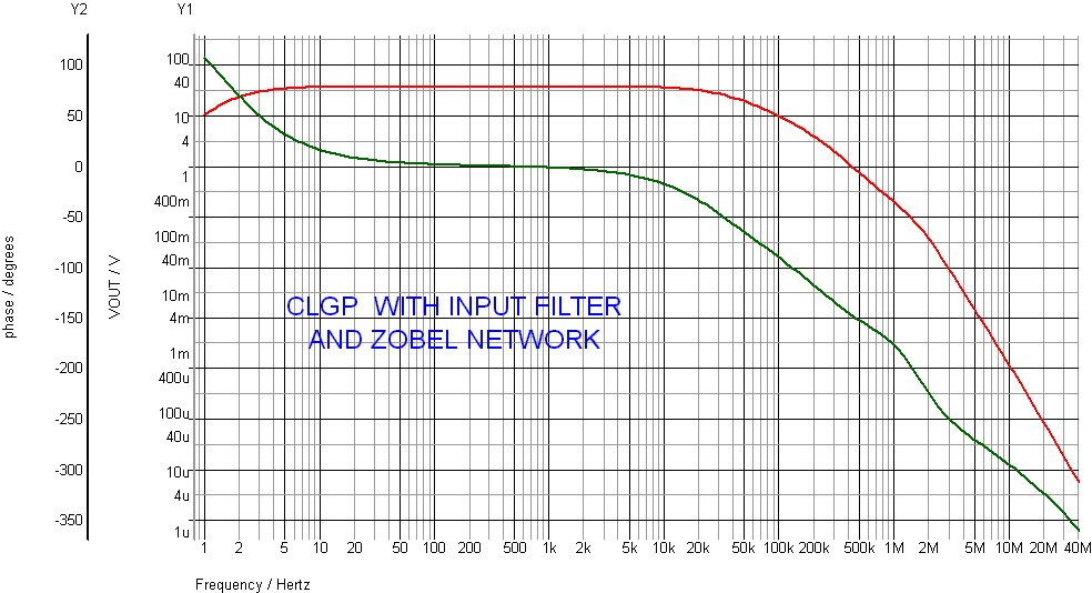

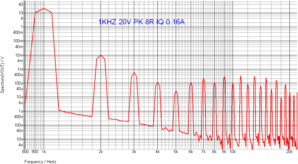

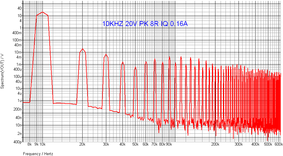

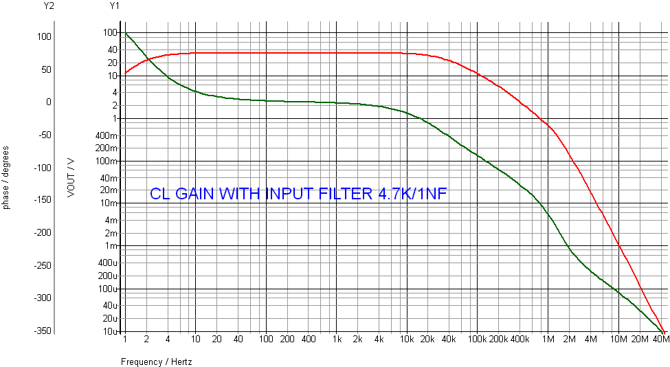

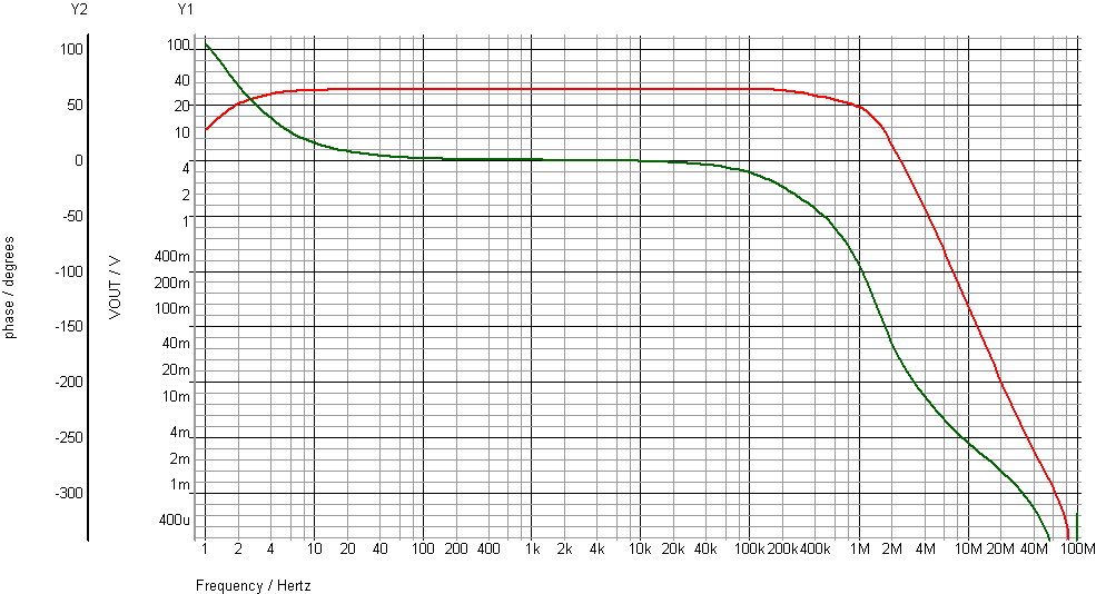

A few pictures in the waiting of a little more...
Nice to see, thanks! But can you add the missing filters and rerun? The amp won't go that high closed loop, it has 1nF to ground after the 4k7, I remember its 10kHz square wave a bit rounded on my scope. Without it oscillates. I have tried it. It also misses the series R//L Zobel on output in the sim. I had a reduction from 0.20% to 0.00125% for 1kHz 1W when I restored the Zobel.
1nF & 4k7 gives 4.7us RF and Audio filter.
How low can this go and still stay free of oscillation? 330p, 220p, 150pF?
As far as I can recall JLH usually used the full Thiele Network on the output.
Bandwith and phase response must be computed without input
and output filters to give an idea of the amp s caracteristics.
With the filters connected, the picture is made way more rosy,
although adding a zobel network will not change the THD ratios,
moreover at frequencies as low as 1KHZ.
