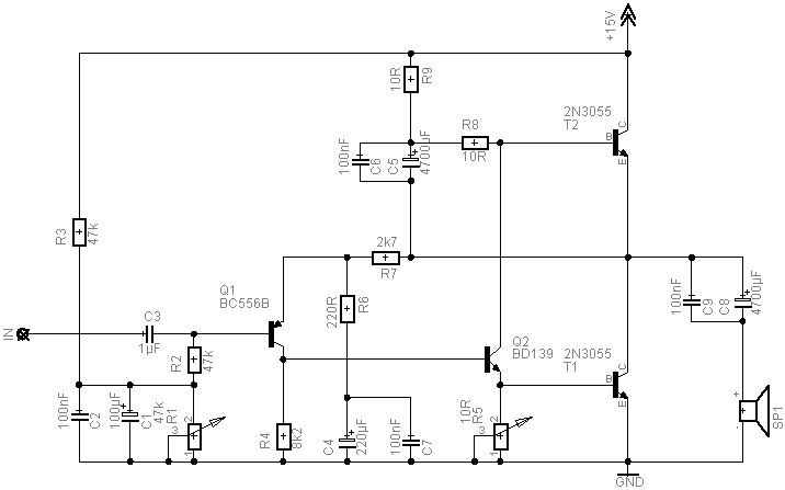

I'm thinking about building this amp to run my tweeters in a bi-amp configuration so I want it to run from a 15 volts power supply and have a 13 volt swing peek to peek to get about 6 watts in a 4 ohm tweeter which I'm hoping is enough to get a decent sound level.
But I didn't really see a way to get such a high swing in the original design, at least not without using a 5 watt pot 😉
So how about this design? R5 at the bottom is used to set the idle current, I'm not that sure it will work though.
I also added some 100 nF caps, they always seem to improve lots of things wherever I use them.
I think R5 is not a practicle way of setting the bias.. your waste about 0.65V/10R=65mA in the driver stage... why don't you use 100R in all 10R positions? You can ommit R5 completely I think..

If you remove R5 completely this will attempt to make the current through Q2 infinite !!!... I would suggest making it about 20ohms and adjust the R8 & R9 to give the desired current in the o/p stage

Not at all.. run some sims to really get a sence of the circuit m8
Well - I have studied this cct for many years and run hudreds of simulations.
Is not the current through Q2 = to
o/p stage current divided by T1 current gain
plus
current through R5 which has about 0.63 volt across it ??
( or where you reading my huge unedited post...😱 )
mike
Well run a couple of hunderd more if you think that's the way to understand it... with and without R5 ... alternatifely, read the article or use your common sense..
I think R5 originally only servers to increase the driver-Iq a bit (more linear), or to speed up cutt-off of the lower output trans a bit... I has nothing to do with Iq, allthough you can influence Iq a bit, a more efficient way to set Iq is to increase the upper bootstrapped resistors.... like the original article shows you..
Oh ! OK you meant remove it to open cct
sorry I thought you meant remove it to short cct
my error
mike
my error
mike

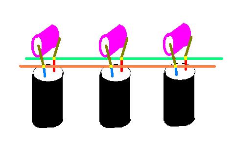

Chris Ma has, IIRC, reported earlier in this thread that he built the higher power JLH using three 15000uF capacitors per rail per channel. He subsequently tried two and then one 15000uF per rail and found that two gave him the best compromise with regard to sound quality (bass weight versus mid/treble clarity).

That's very interesting. I can see why more uF = heavier bass but I'm not sure how less uF = better mid/treble clarity.

Geoff,

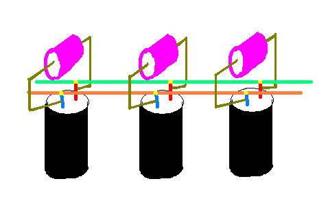

You are correct.🙂 That was my experience with the regulated PSU the same exact PSU post with pictures in your site. At the time when I reported this I did not understand the significant of details that I've missed to enclose. These details were actually the main reason of what I have experienced.
See picture, the way I connected the bypass caps and the result of how they sound differently when using only 1 set of caps connected to the rail, then 2 sets, and then finally 3 sets.
Now I am using all three sets per rail before the regulator boards. In this arrangement there is no significant change in dynamic of mid/high sound that I can detect like previously; except that the more sets I used the bass get better without affecting the dynamic.
