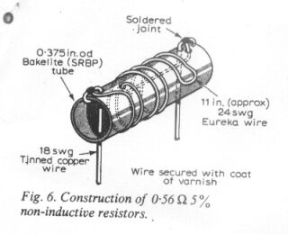

Resistance wire
Maplin also sell it in smaller quantities (an ounce for a fiver - how many ohms per ounce, I wonder?). I'll give it a go.

I just want to make a small contribution to the use of "resistance wire". In fact it is actually possible to wind wire in a non-inductive way. This may be useful where it is not possible to find a home for the length of wire you have to use and still mange to keep it in a straight line. It saves space and is quite elegant in its use of physical principles. The only place I know that shows this technique clearly is contained in Geoff Moss's Class-A site. I guess most uses of this thread know Geoff's site. If you go there and then select "Other Class A amps" you will find the Nelson-Jones 10 Watt design. Choose the "article" (not the schematic) link and go to page 12 (of 14). There you will find a delightful diagram of a 0.56 Ohm 5% resistor wound "non-inductively".
Jonathan Bright said:There you will find a delightful diagram of a 0.56 Ohm 5% resistor wound "non-inductively".
To save anyone interested some time, I have attached the relevant figure.
