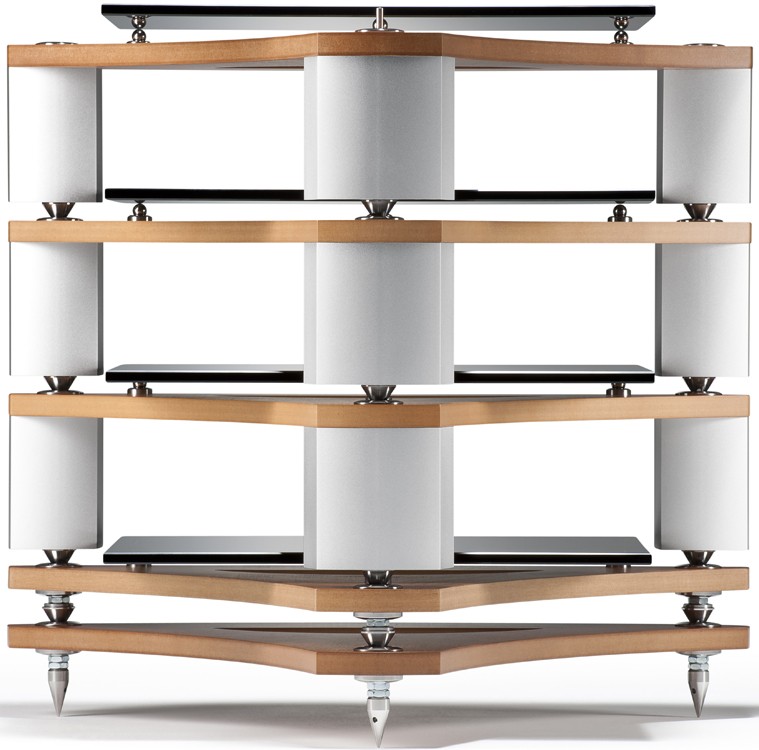

OR spikes like naim and pcb's on heavy mass brass plates on springs all on glass shelfs supported by steel balls AND spikes on the stand base... and you're done

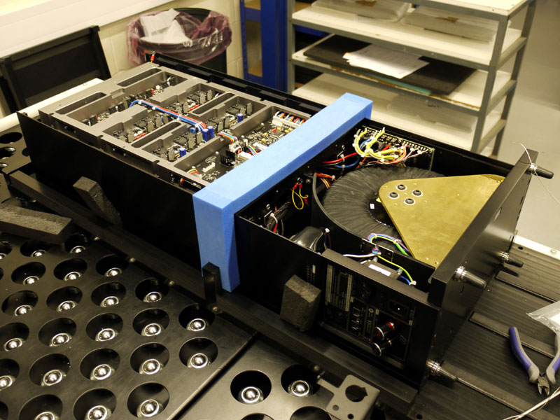

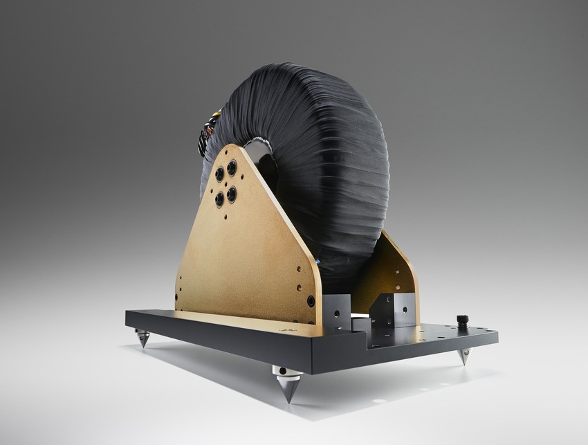

Re isolating the transformer from vibration that in the photo looks to be quite heavy so if the plate is aluminium it would need to be a reasonable gauge to prevent this plate from flexing. The transformer is in intimate contact with the plate which would be in contact with the safety earth. One would not isolate this electrically through some mechanical means. Aluminium is a good conductor of electricity. It is unclear what internal fuse protection there is place for the mains supply - apparently protection relies on the multi outlet box tripping out after major damage could have occured within the amplifier - and in the low tension side of the amplifier.
Er, which photo do you refer to in the above post? Is it the Statement transformer mounting assembly?
On the general issue of spikes for eliminating vibration; consider that they may reduce the transfer of some vibrational modes to the supporting framework but at the cost of focusing the transfer of energy at wavelengths related to their spacings. The design of a 3-point mounting for example, may actually be rather complex and could also result instead, with the increased transfer of some unwanted harmonics, peaks and intermodulation products to the mounting frame and casing, as it happens to be. A trap for the unwary.
As DIYer, I think I would use the broad-brush approach and rely on damping materials instead.

caglarm post 8563. Not the Statement shot in post 8581 for transformer mounting assembly. I have a Naim Nait amplifier although inaudible at a normal listening distance the distictive throbing sound of the transformer can be heard if one is close enough to the equipment. In the statement this could be as much about micro vibration and partial shielding of the transformer electric field. It has been claimed that toroidal transformers have optimum orientation in the last regard. If I remember is not the Statement a tower-like edifice - one that might not get much wife approval rating - as in you can take that to the art museum you are not bringing that thing in here!
On huge rooms Statement may look ok and the target buyers probably have them. I was wandering how you move the boxes around but the underplate is part of the chasis and the transformer is bolted on (big transformer). Decoupling by minimal contact points and small surface may work better though, damping materials will probably transfer energy as well. Maybe a combination of both.

The plate under the transformer is 1 cm thick. It is not possible to stretch. The transformer is connected to the plate at 2 points. The bottoms of the other legs are filled with felt. Air flow is provided from under the transformer. The temperature of the plate is not transmitted to the transformer either. The transformer is electrically isolated from the plate. The transformer is also connected to the main earth. Connection screws is also isolated

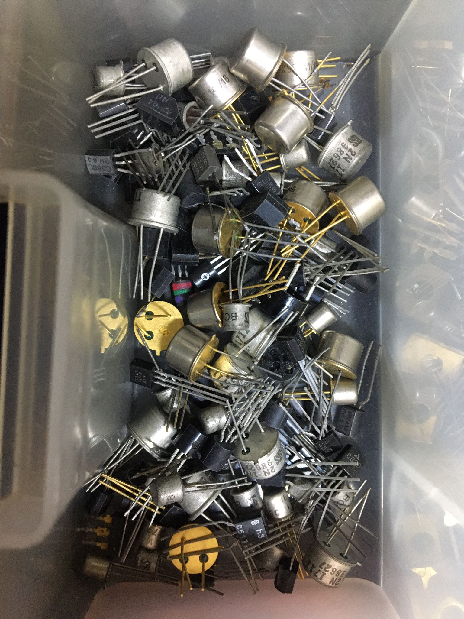

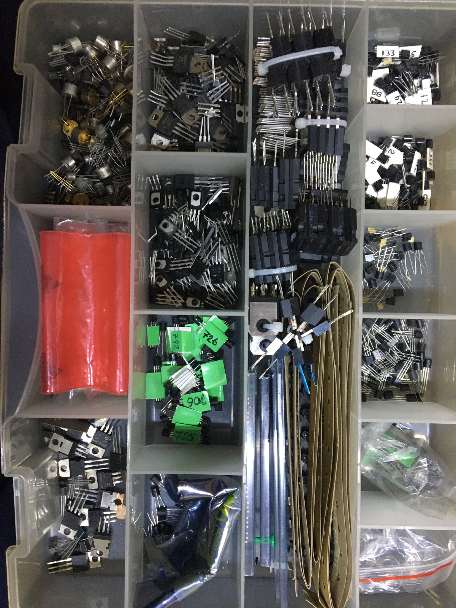

I should add that it's likely your 2N1711 and many other semis that are obsolete but desirable to hobbyists, is actually a fake. Fakes can be produced with the obsolete, original tooling and marking equipment too - such that they appear to be identical. Only authentic factory documentation would prove them genuine though.
Also, in the above post #8568, I referred to 2N697 as having a TO39 case. Apparently this is wrong, as datasheets show the similar, older T05 style.
I'm sure that all the transistors I have are original. Most of them were bought 30 years ago. At that time, my country was not made in China 🙂
