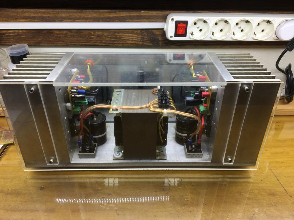

This is my JLH69.
It consists of bc559, ksc3503, mjl 3281 transistors.
supply voltage 24vAC 32vDC
dual mono
Bias 1 Amper
Av=23db
I listen to music by heating my study room in cold winter months

cumbb has done a good job with his build however this could be improved avoiding radiated fields due to switching action of the bridge rectifier charging the supply capacitors.
All that is required is to twist the leads tightly so these fields effectively cancel one another. Also it would be worthwhile if there is no copper flux band around the transformer windings to take this to a transformer winding company and have one fitted. I built the 1969 JLH in a steel metal cage designed for a valve amplifier. the field around the transformer was sufficient to cause the cover to vibrate and generate a fair amount of mechanical noise.

Quote, OldDIY: Can I add vibration isolation pad (mat) under the transformer?
An isolation pad would have to support the mass of the transformer + any necessary mounting force. That's not simple to do because most synthetic foam materials are too soft, compressing down to nothing after some period of time at typical transformer operating temperatures. A piece of say, 8-12 mm solid but relatively soft neoprene rubber sheet laminated with rigid insulation board, could be effective though. Closed-cell neoprene foam sheeting is available too but I doubt its longevity. Here in Oz at least, there are some heavy machinery installers and automotive suspension specialists who use and sell suitable thick neoprene and other sheet rubbers, in roll form but I have no idea of your local sources or minimum purchase quantities. You need only a little of the stuff and that makes it hard to find a seller.
