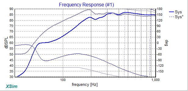

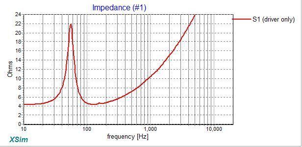

Nigel, are you saying that there is a case for fine-tuning the output capacitor for the speaker the amplifier is intended to be used with ? Is this a case of using the value of the capacitor as a form of EQ to allow the impact of the room or other speaker behaviours to be dealt with at the amp ? And is is still true to say, that no tweaking should be needed if you already have your speaker and room set-up optimally ?
Yes, there is a tweak to adjust bass response with series capacitors. I think this mostly applies to small (undersized) sealed boxes with fairly high Qt, the effect with a proper sized capacitor can be better low end extension, but also more current from the amplifier. I have no practical experience about this, only read some stuff about it.
You can simulate this with crossover simulation programs (like Xsim). Also using a small cap will generally create problems around the resonance frequency of the driver. The attentuation will not be a 6dB slope, but the higher impedance at resonance will create a bump in the frequency response.
Below are examples from X-sim. The grey curve is without cap (reference) and the blue is the response with cap in series. 82 & 400uF. I also included a graph of the woofer impedance curve.

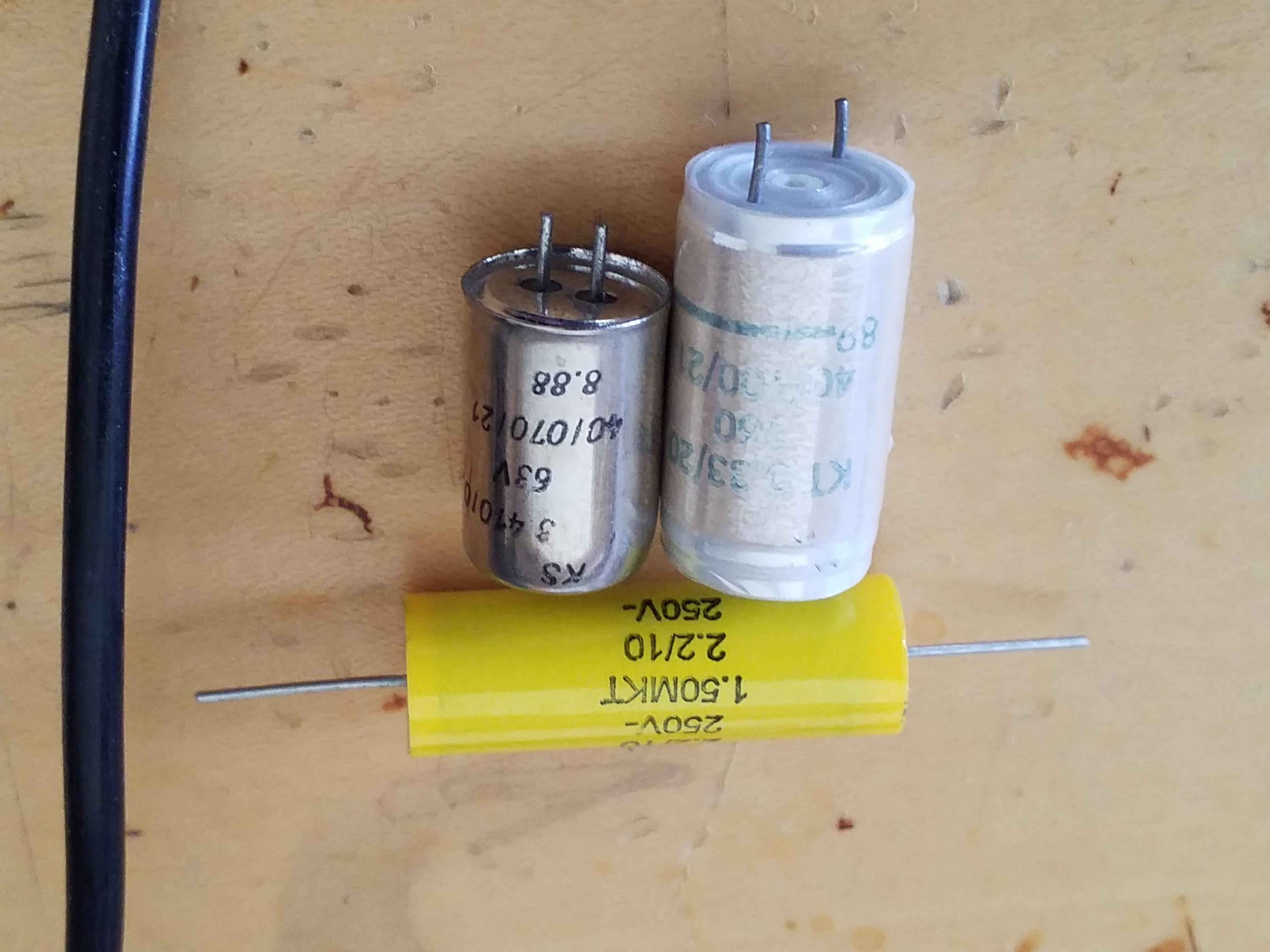

I see you're digussing capacitors, I have been thinking, what makes up a good input dc cap?
In my jlh I just put the yellow cap in 2.2uf, with nu further thought, it sounds wonderfull, but went through some drawers and found the other two caps, I tried feeding sine wave from 10hz to 30khz, they delivered an exact image of the reference signal, so what properties should I be looking for?
Yellow is 2.2uf 250v
The metal canister cap is 3.4nf 63v
The last is 321nf 160v.
