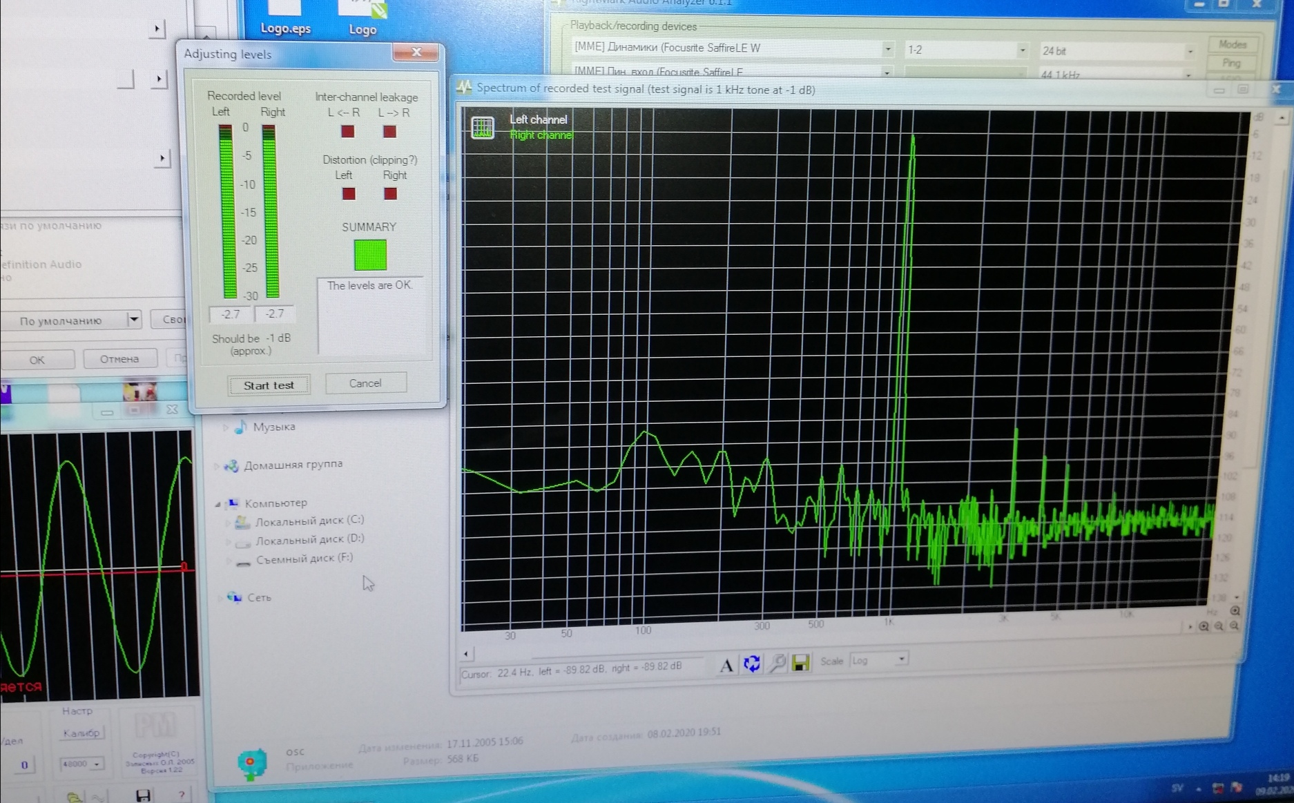

Hello,
I assembled my first JlH amp, basically 1969 schematic with transformer regulated supply. 27v 1,3a.I used genuine 2sc5200 transistors and hopefully genuine 2sa970 and 2sc2240. Had to add some 10-15 pf on transistors and 22 pf on feedback resistor.
Attached some measurements of thd at 4-5w with cheap sound card and square valve at 20khz.
Does it look adequate? The sound is quite good and no audible noise.
Also, what is a recommendation for output capacitor? Brands, etc, will an expensive output cap make a noticeable difference in this application?

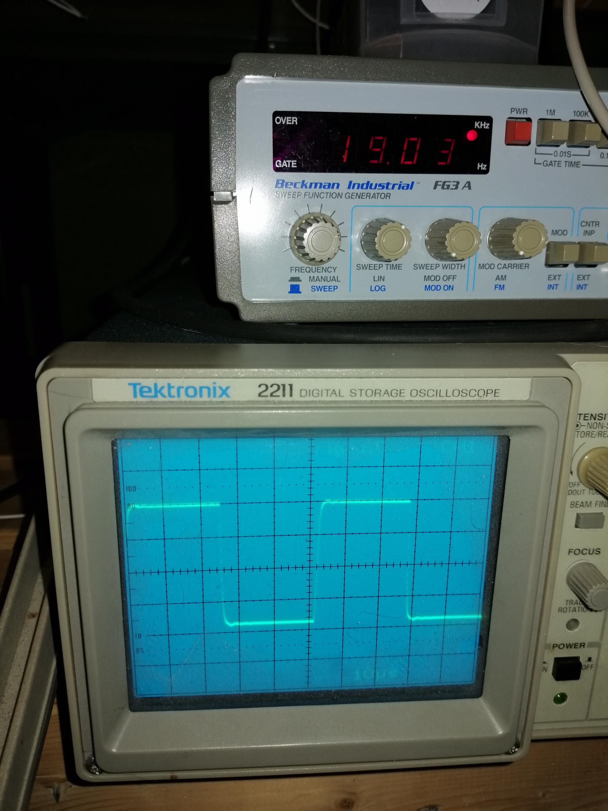

We should all be jealous. That implies 380 kHz if a perfect 20 kHz. BBC open university maths taught me that in black and white TV days.
Nigel, I I'm not sure how to interpret your reply and if it is addressed to me. As I mentioned, I have not much experience with SS amplifiers.
My signal generator could only do 1,5 MHz, so the attached picture shows the amp output sign wave at this frequency. Quite a good sign wave, but the signal is about a half tall.
