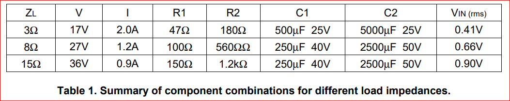

Yes, I agree that 0.5K/W is safe but still a bit hot for my liking and I wouldn't locate the amplifier in a cabinet, on close shelves etc. or lean over the amp whilst fiddling with connectors, as I do. If the amplifier is separate to the preamp as Hood's clearly was, it doesn't matter so much if it runs hot but I prefer to incorporate at least a volume control/preamp for simplified operation at home and heat doesn't mix with pots or any contacts and connectors, for that matter.
I'll dig out a bit more history by attaching Hood's table of parts and supply voltage combinations for different speaker loads and power output. First, we need to check that what we are using for speakers is really in the same ball-park as Hood was, 50 years ago, when impedances were nominated differently to today. Now, marketing drives what 8 ohms means and that's more likely a universal 6 ohms rating by 1969 standards.
In other words, don't be confused by old docs which recall past values and facts which may well be more correct but still at odds with today's audio babble, where technical terms seem to flip around willy-nilly from one ignorant user to another. Just use a little history to help clarify what nominal speaker impedance really means when you are looking at a speaker's impedance graph that only crosses the 8 ohms line at one point 😕

Something that has just occurred regarding you last but one post. I don't think Mr Hood had the heat transmitting paste that we now have, I suspect that he would have used something like petroleum jelly and mica washers.

If you study heat transfer the big problem is the washer. Arcam had very good anodising on the A60 heatsink. They did away with the washer and just used the heat transfer compound. Whilst I couldn't believe it I never knew it fail. From memory a very good T03 washer is 0.3 degrees per watt. That's a massive problem.
Almost right with what JLH would have used. Around 1969, I was using clear silicone grease with sheet mica for a 2N3055 based amplifier, much the same compound as used in my company's chemistry lab for sealing ground glass jointed laboratory glassware. This differs from today's thermal paste compounds only in that it was thickened with aerogel silicon dioxide rather than powdered alumina or similar ceramic filler, which renders it white and is claimed to improve heat conductivity.
The problem with electrical insulation is it also is thermal insulation. This.is all connected with conduction, semiconductors and ultimately insulation. The free electrons come into it. The electrical insulation washer has to pretend to be a thermal conductor. As far as I know thermal powders are mixed with a rubber like compounds to make the washer. Free electrons are equally associated with heat and electrical conductivity. A heat transfer washer is a bit remarkable.
The surface finish of the transistor is a factor. The rubber conforms to the surface to assist. Thermal paste the same. Conduction and free electrons a fascinating subject. Aluminium is on its own with that, it resembles a metaloid. Silver is a superb electrical and thermal conductor. Mica a very good insulator and can be made thin. Some still prefer it.

Thinking about suitable transistors and the heat transmission through mating surfaces I would be grateful for some suggestions for flat TO220 varieties, the only one I know of is TIP3055. I have tried a search for TO220 but sadly it doesn't reveal anything concrete.

.....TIP3055 was Arcam's choice in T03P or T0247. The T0220 is a bit small to shed the heat. TIP3055 is a slightly faster device and very nice. I have seen the T0220 version....
I think you mean TO218, the precursor of TO247 outline, rather than TO3P. My experience is that that these are (or perhaps were) inconsistent from one manufacturer to another. Some are just repackaged 2N3055/MJ2955, others are different chips that probably fit the broad specs of 90W general purpose power transistors. YMMV regarding hFE, Ft and linearity there, even though the datasheet specs are comfortably met.
https://www.onsemi.com/pub/Collateral/TIP3055-D.PDF
ST Micro still supplies the TIP types and I was given a large quantity of them, still in their boxes and the Ft was comparable with 4Mz semis. I have also encountered original TI product that didn't even make 1Mhz and sounded very poor in my P3 amplifiers long ago. I went over the same ground only a year ago with ST Micro's versions and had a pleasant surprise though. So, I wonder what chips ST will be using now that the ancient TO3 outline has finally bitten the dust?
ST don't make many high power BJTs now, only 4 TIP types and surprise, surprise, a version of 2SD1047 in the TO3P package. Rotel has been associated with the 2SD1047/2SB817 pair in all their top range amplifiers from low power to monsters, over decades. Methinks it would make a great, economical but at least genuine 15MHz power transistor for Quasi-complementary designs such as small Naim clones and several Naim wannabes that were popular but manufacturers couldn't survive in business. That one's on the 'must try' list for a JLH'69 too 🙂
Well, Farnell's list is wrong - no sorry, its right for the G suffix if you check On Semi's website too. In reply to an earlier question though, anyone searching for T0220 versions of TIP3055/2955 etc, should look for MJE3055/2955 or MJE3055T/2955T rather than TI's brand prefix. For Audio applications, I wouldn't consider these unless you are only trying to get up to 25W in class AB or maybe 8W in class A in the smallest possible space, since there are better transistors that won't cost much more.

I just had an unusual thought in thermodynamics. We could eliminate the heat washers all together. The positive rail transistor could be 2N3055H or better. The bottom BUZ900 enhancement mode MOSFET. These come on much like a bipolar so should be possible. The advantage is Collector and Source to the casework. That means the two left right top transistors on on heatsink and left right MOSFETS to another. No compromise and using the ideal device where best. I would estimate a 30% smaller heatsinking possible it the fit very flat. It's not the heatsink temperature, it's the transistor. If the PSU has over current protection it should be ok exposed. Capacitor coupling preferable. Transistors make ideal current amplifiers, MOSFETs ideal voltage amps. Superficially that is what we would have. No idea how easy it would be to do. Not all FET are source ( emitter ) to case. Exicon make suitable FET.
You could adapt this idea to the JLH using all NPN devices. Make the 0V devices fitted to a 30 % larger heatsink with washers the others on a positive rail no washers. For this PNP slightly preferred.
