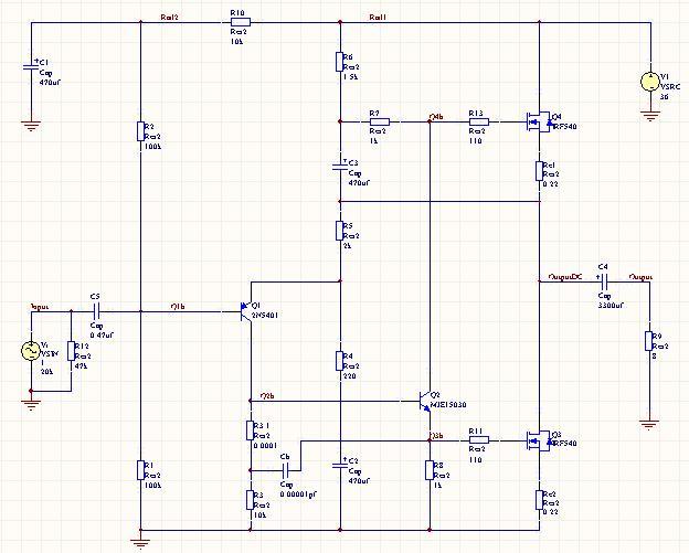

tschrama said:Can you post the circuit you actually used, maybe there's a small mistake somewhere?
here it is. It is essentially my version using higher resistor values for the driver stage.
I have the bootstrap turned off in this particular simulation and it can be turned back on easily. however, it is not going to materially change the picture. The simulator is protel dxp (demo).

what I did is to inject 1v peak (0.7v rms) 20khz signal into the input and measure the output. I have no way to control on the output / speaker easily.

Hi Millwood,
I use 400mV peak input to give about 1 Watt in 8 ohm. Lets stick to that to ensure enough freedom from saturation/clipping effects.
You circuit looks OK to me ... 😕 so what happend... maybe it is your simulation: I use 1Khz.. escpecially with a MOSFET output stage this can be of significance.. I 'll try 20KHz, could you try 1KHz?

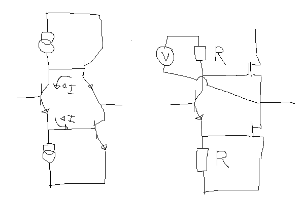

The original BJT circuit works in the current domain:
-the upper BTJ get an current injected to it's base, this determines the current through it's emmitor.
-When the driver BJT 'steals' a bit of that current, the up BJT will put less current through its emmittor.
- The current that the drivers 'steals' goes through it's collecetr, to its emmitor.. injecting more current in the base of the lower BJT.. icreasing its current draw.
So the output BTJ are current driven, they are driven by a phase splitter that 're-distributes' the base-currents of the output BJT.
X-pro.. this is about right isn't? help me out because I lack the talent to explain things more cleary...
So just replacing the output BJTs with MOSFET might not work. But is does! Why? I think I know now...
In my simulations the lower driver transitor is 1K... The an AC voltage across this resistor is vreated by and AC current through the driver BTJ.. this current has no where to come from except from the upper 1.5K and 1K resistor pair.. The Vgate of the upper MOSFET is changed by the bootstrap capacitor: in effect following the output AND by the current going through the UPPER 1K resistor.. so Vgs is changed simmilar as the lower MOSFET: nice ac-current sharing😀
Hope this helped..
conclusion:
1]Keep the lower-driver-resistor equal to the upper-driver-resistor and current-sharing is achieved..
2] use the most upper driver-resistor (1.5K in my sims) only to adjust Iq
I just did a 20KHz sims.. I get the same results as you🙂 nasty!! must be because of the MOSFETs gate capacitance .. I see the same 300uAp... 600uApp!
The bootstraphoqwever does improve thing by 10dB in my sims.

tschrama said:-the upper BTJ get an current injected to it's base, this determines the current through it's emmitor.
that makes sense. It also suggests that if you replace the collector bootstrap and emitter resistor on the driver with two perfect current source, you will improve performance. Has anyone tried that?
tschrama said:So the output BTJ are current driven,
I can make a similar argument in voltage as well: As the voltage ont he base of the driver goes up, it raises the voltage on and current through the emitter resistor, such turning on the lower output BJT more. As the emitter current goes up, voltage drop off the collector bootstrap goes up (think of it as a resistor for now). that means Vbe for the upper BJT goes down, turning OFF the upper BJT. Viola, you got a push-pull design.
The same holds true for the mosfet version as well, except that you will be talking about Vgs.

I made a correct version of the simplfified topology that help me tto visualize things...
Pfffff .. thats a bit muck for a simple mind as my to follow, but I'll work on it... thanks.
Yes.. I think it might.
Your also right about the drivers current and high frequency aspects of your circuit... keeping the associated resistors of the drivers low is the only way to deal with the MOSFETS gate capacitance.. this dictates high current through the driver.. I should have done some 20KHz sims earlier...🙄
Kind regards,
Thijs
Hi Millwood,
my sims tell me that for optimum current sharing between the MOSFETS you need the make the upper-driver-resistor 0.85 * value of the lower-driver-resistor
In my circuit this means 850 Ohm upper, 1000Ohm lower..
I see in you circuit upper 220 Ohm, lower 110 ohm ... I think you amplifier is allmost a SE-amplifier.. scaling these resistor properly might improve thing a lot...

tschrama said:my sims tell me that for optimum current sharing between the MOSFETS you need the make the upper-driver-resistor 0.85 * value of the lower-driver-resistor
I will try that later.
tschrama said:I designed a total MOSFET version of the amp a bot 1 or 2 years ago.. maybe in this very thread... using IRF610 as input and drivers... simulated great!
http://www.diyaudio.com/forums/showthread.php?s=&threadid=2274&highlight=
I've learned a lot in the mean time😉 .. so don't take this design serious...
our designs are surprisingly similar, putting aside that we used different input and driver transistors.

I will try that.
tschrama said:I really wanna get me some of those IRF540s.. to try myself.
it doesn't have to be the 540s. Other mosfets I am sure work just as well.
tschrama said:I loveeeeeee your heatsink!!!
yeah, I know. you got do with whatever you have, 🙂
Once I have experimented enough with the existing amp, I will build a new one. I made quite a few layout errors with the existing board.
