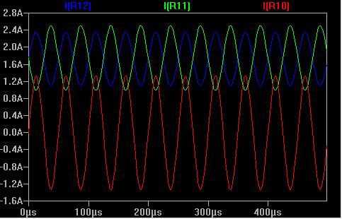

here is the current plot:
the blue line is the current from the top output device, and green fromt he bottom, and the red is what goes through the load. R1/R2 are 220ohm, rail is 36v. Standard schematic from the original JLH.
so unless you very carefully adjust R1/R2, the two transistors will NOT work equally in terms of their current output.

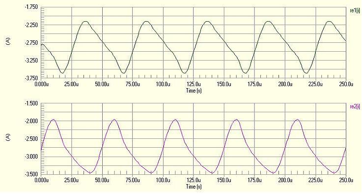

Hi, tschrama:
I simulated your design, and it works, to certain extend. The THD is just slightly higher, at 0.11% full power at 20khz.
the problem is I think with current going through the two output devices: they are nowhere near sine wave. I posted it here.
I think if you don't want to run at low Iq for the driver, this is the route to take, as there is a minimal penalty on sound quality.
two more simulations:
1) adding the 2nd bootstrap to my mosfet jlh: it worsens the THD to 0.13%.
2) adding the 2nd boostrap and use higher value resistors: it worsens the THD to 0.14%.
Not sure what happened but will investigate later.
