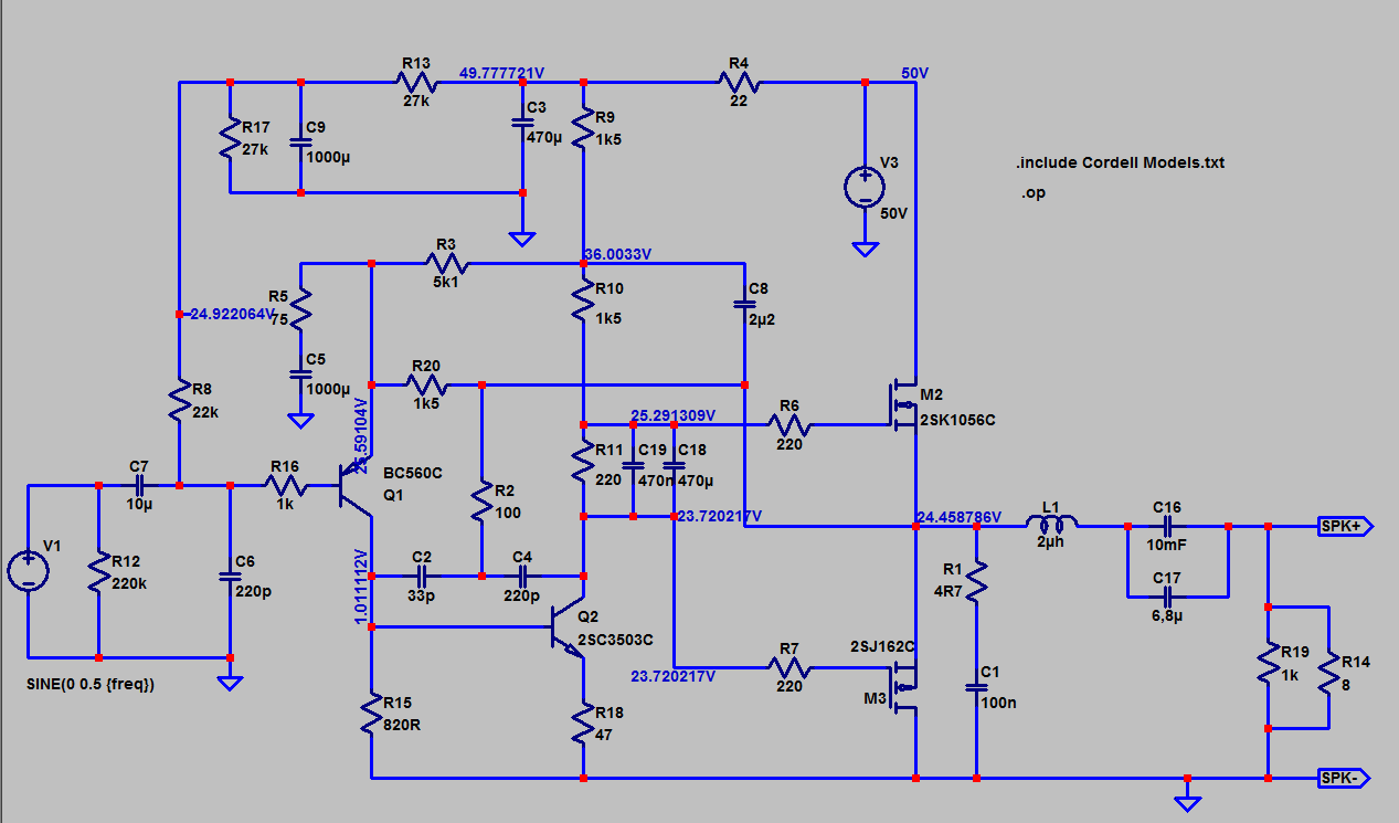

Dear all,
I took the liberty of committing nigel's circuit from post#5060 to LTspice. I modified his circuit to retro mode.
Please help me to simulate this circuit. THD, Sq, and Stability. One separate LTspice diagram for each parameter. This is for educational purposes only.
Also please an explanation of the resistor R3 and how its value is arrived at.
--gannaji.

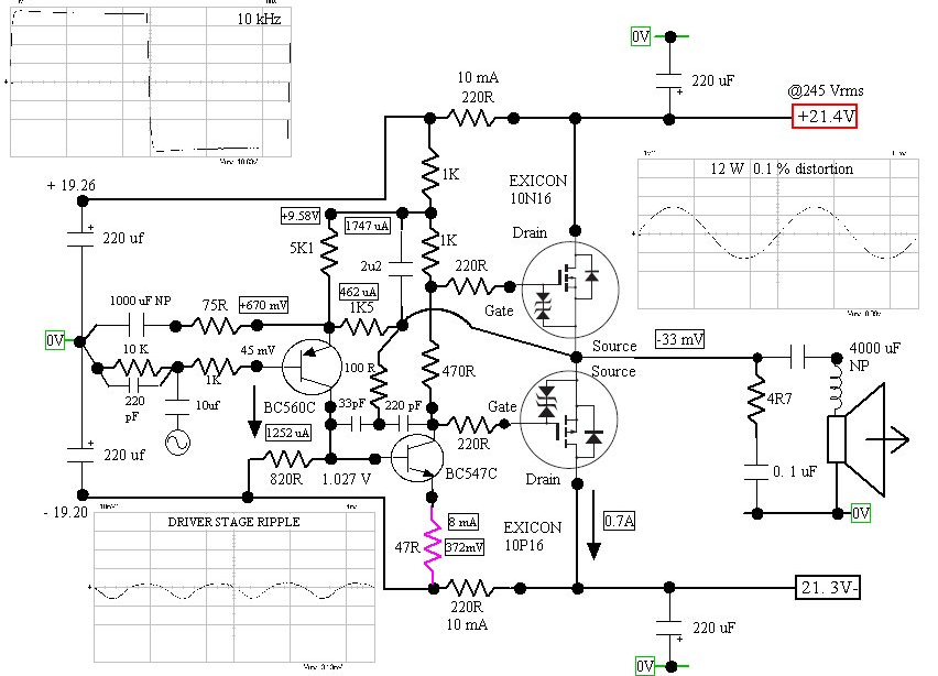

I must say I didn't look too hard at that. With a class A amp I take 10kHz 10 watts as where I stop asking questions. My little class A using Exicon 10N/P 16 amp did 60 kHz full power with no real distortion. It didn't start like that.
I had a better set of measurements from later ( lost ). Note the very local feedback loop to the VAS. It works. The amp is stupidly complex . Sorry so many graphs. Were so as not to forget details. It's class A + AB. The purple resistor became 16R. When 0R ( purple ) it's higher distortion. Self says otherwise. Too much loop gain isn't always ideal. It can mean more VAS capacitance to regain stability.
Note the 2u2 bootstrap capacitor. That was the point at which loop gain is not enough and distortion becomes greater ( 1 uF ). Self makes the same point except he can not accept extra low frequency distortion. When it's very good I might prefer the better quality capacitor. 10 uF polyester 100V type ideal. It is debatable if phase shift is more important and use something much larger. Listening test ( empirical ) required.
The 4000uF non polar output cap ( 4 x 1000 ) was for initial safety. Note very low offset. Zobel and output choke not really required. Choke was 16 turns 1 mm copper on 8 mm drill, 10 mm OD.
