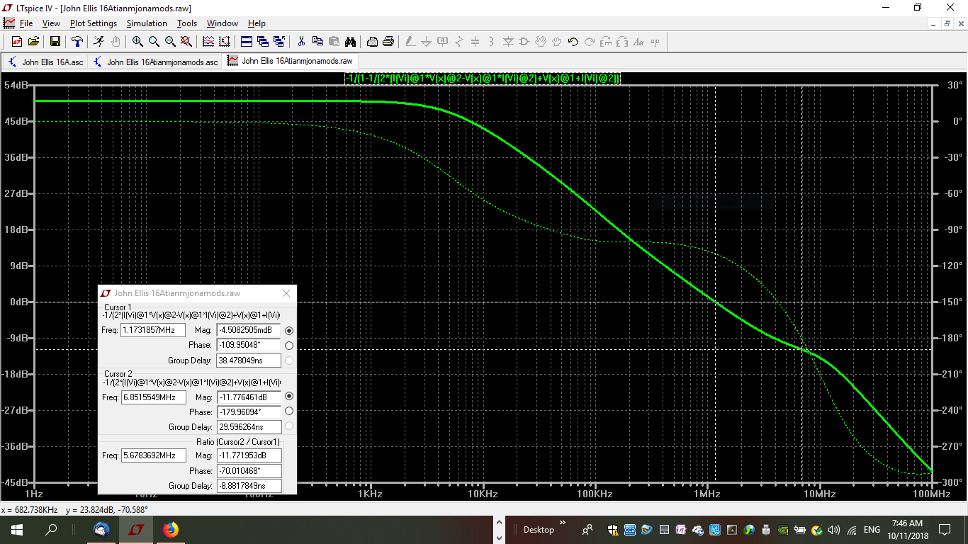

That says we have a choice to build an exact copy JLH. Seeing as we often have to change at least one device we have to ask ourselves can we do better. I would say JLH was a bit lucky with this design as mild improvements show onset of instability. JLH sometimes hints at this as he found sometimes fast output devices pushed it that way, he never really worked out a statement on that. Perhaps as it was too complicated for an average builder and would have been expensive to do the tests. Fake devices seem the bigger problem now. In a way my 2N3055's were fakes as they measure far better than real ones. I wasn't unhappy, the Indian makers I am sure felt them to be modern 3055's.

If a phase margin of - 70 degrees and gain margin of 11.8dB is considered to be enough I believe the circuit will work with 2N3055E outputs. The changes to get this result are minor.
One of the attractions apart from the elegance of this circuit is the fact this can be built with everyday components and still get 0.01% simulated THD at 15W rms at 20 kHz.
