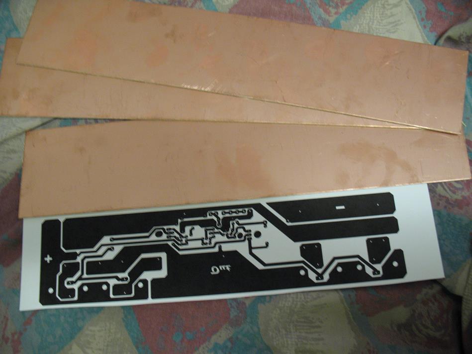

No I only finalized the PC board layout, I do not found clad board the size I need. 31*7.5Cm I found in US but with shipping it cost $22 US plus import duty. Too much! There is local store a bit far away from I live, I did called them (I called many other store), they have some type. I have to make that trip to visit that store. If the copper to thin is useless. I would like to get 2oz copper at least for Class A.
I will do these project!
Thanks for asking🙂
My lay out is much larger, so you can not just print it out for iron transfer.
Please you take it into the paint and print set up and print it out from there for the right size! That is how I draw my layouts, in these case Prasi's layout modified to 100% feet my heatsink. Thanks to Prasi
Working with paint (program) easier to work if the layout larger. Please do not forget there is a GB and if you need PC boards please participate to get high quality commercial grade boards for less $ than it will cost to me. I only chose these option because my heatsinks shape and size.

Greetings gabor
Today I got some clad board for these project.
A bit thick boards 2MM or 2.2mm and double sided. I only found these with thick 2 or 3 oz copper.
I will pull the copper of from one side, will take some effort and elbow grease 😀
The store had one sided clad boards but a few mm shorter what I need and only with thin 1 oz copper.
Just need to find some 12.5" long photo paper to transfer the image. I may glue two paper together if Staples will not have.

Why don't you just reduce the board size to fit on one sheet? Much easier than what you otherwise plan to do.
Besides it looks like you can actually paint the board with something suitable , like nail polish ?, for the tracks. The layout is very simple and without any complications. Have you ever tried this ? I used to do that for years a long time ago. Put the design on the board , drill through all the holes and then paint on the tracks ! Etch it. The second side will get removed also . You will need nail polish, a thinner ( like amyl acetate or acetone ) a small container to thin the nail polish ( maybe NC paint used in cars is also OK ?) a thin paint brush and a thicker one for wide spaces. Amyl acetate dries slow enough to give you time to spread it around easily. NC paint ( with thinner) might dry more rapidly. But then you can scrape away excess very easily as the paint will crack away cleanly and not tear and come off in strands. Use a regular box cutter knife ( or just the blade !) to clear up excess paint or clean up edges.
Alternatively you can use masking tape to block out the parts to be etched away and spray the board with an aerosol can of paint. Remove the tape after it dries , paint on any small complex sections with a brush and etch it !
PS. I still use the nail polish method for very small simple boards as it's super fast. From drilling to ready board in under an hour ! You need to have a steady hand to make it look neat. But you can use guides like rulers etc. to get straight lines.
