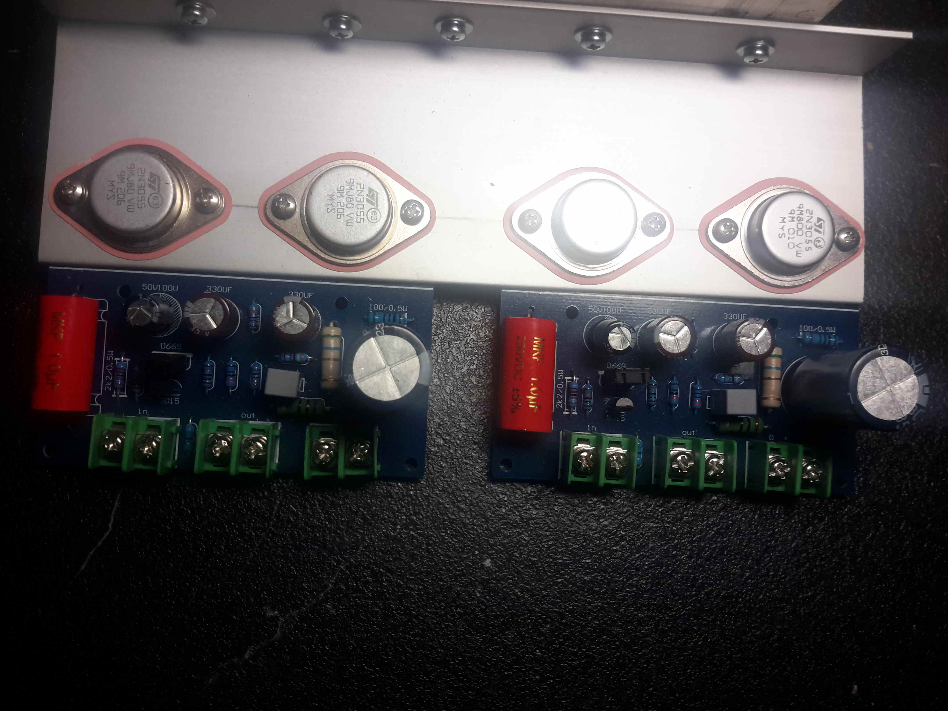

I still haven't built a case for my amp, soooooo... I managed to short some contacts and one of the channels went out with a "thump". Both 2n3055 transistors on it went bad. The channel was "short", kicking my SMPS into error/emergency mode.
So I replaced the transistors. The music started playing beautifully again. For a few minutes, when the same kind of "thump" killed the new transistors. I thought that this time, it was my clumsy transistor mounting, and that when stuff got hot, something must have shorted somewhere.
Okay, so I bought another pair of transistors, and mounted them, this time with all the care given. The music started playing beautifully again, and the third "thump" started to frustrate me... Now I don't know enough electronics to troubleshoot the problem myself, but I think my first shorting must have killed or damaged some other components. Any idea what I should replace to get the amp alive again?

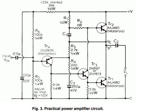

Yes, I have confused the '69 design with the amended version of 1970 that I currently use. This adds a few other improvements as well as bias current adjustment but not all modifications may be necessary. Anyway, you don't have that problem staying with the basic design as most Ebay kits do. http://sound-au.com/tcaas/jlh1970.pdf

BTW, TR3 has the dual roles of splitting the signal phase between output transistors and providing them with enough drive current. If it has also failed as a consequence of trying to drive the shorted output transistors, you could still get nothing (other than the big error current at the output which promptly burns them) when you replace only them. You need to track down all failed components before powering up again and just hoping, otherwise the repair will just get very expensive.
I suggest you read the JLH articles at the Class A Amplifier Site hosted by ESP, that I linked. It might help understanding and thus suggest where and how to troubleshoot, even if the theory and advice may seem hard to follow at first.
Sorry for noob description. I tried measuring the resistors on both channels. The left one is healthy, right one faulty. The beige resistor on the left, good channel is 560ohm, but the right one measures only 190ohm. Could it be that measuring with other components (faulty transistor in this case) still mounted can't be done, or is it also possible that this resistor went bad when the accidental short happened?

The 560R resistors won't be all that different when removed from the board. Carbon Film resistors like these don't drift as badly as ancient carbon composition that were common before ~1975. More to the point, you cannot measure resistance in a DC coupled circuit without it being strongly affected by parallel and series resistance of other resistors and active devices too.
If you measure same value resistors with a 3:1 difference like that, you are actually measuring something else - either because of another short or open circuit component. As it is 560R and not shown, I assume you refer to R2 shown in the attached schematic. It's not hard to imagine what might happen to a multimeter measurement if TR2 or 3 were shorted or not, so pull at least one end of reistors if you want to check properly.

You probably know this but from your pic, I see:
1. A problem with thin aluminium being used to conduct a lot of heat. Class A, even at 10W is serious, continuous heat and unless you attach the transistors directly to large heatsinks, you will need much thicker aluminium for that bracket. Also, mount the transistors much closer to the 'sink. to reduce thermal resistance.
2. Use mounting pillars and bolts to ensure there is no chance of the board or connections shorting to the chassis and they stay in place and safe. The metal surface looks thickly coated but it only takes a little wear in one spot and a few volts to break down insulating coatings.
The aluminium profile is the only one I could get in the hardware store that was big enough. There is a 150x60x25 heatsink with fans on the other side of it, not shown in the picture.

1. A problem with thin aluminium being used to conduct a lot of heat. Class A, even at 10W is serious, continuous heat and unless you attach the transistors directly to large heatsinks, you will need much thicker aluminium for that bracket. Also, mount the transistors much closer to the 'sink. to reduce thermal resistance. ..............
The aluminium angle needs to be at least twice as thick.
The long leg can be sawn to about half length and then the transistor mounted right up almost touching the other half of the angle.
But the internal face of a thick angle might not be flat.
It is better to use the outside face of the angle where you can check it is flat over the whole surface that the transistor mounts on. Or that outside face can be machined or ground to flat.
This sink is far too small.
OK with fans for testing but not for normal listening in a quiet room.

I very briefly explained what TR3 does but unless you understand how semiconductors work and are configured to to amplify signals, it probably won't mean much. Electronics is not a simple study, as I'm sure we are all aware.
BD139 is not the best transistor here but it can work OK if Hfe (gain) is high enough - like higher than median spec. value. However, the 2SD669A you were supplied with in the kit was not likely a genuine Renesas or Hitachi part anyway. You can buy bags of those copies cheaply on Ebay, Aliexpress etc. https://www.aliexpress.com/item/10P...lgo_pvid=6ec96633-245c-41f7-b746-5ff183a23ea8
I don't think you have the pinout correct when checking for an E-C short. A short should read the same in either direction. Whilst the transistor is removed, why not test other resistors in the circuit?
