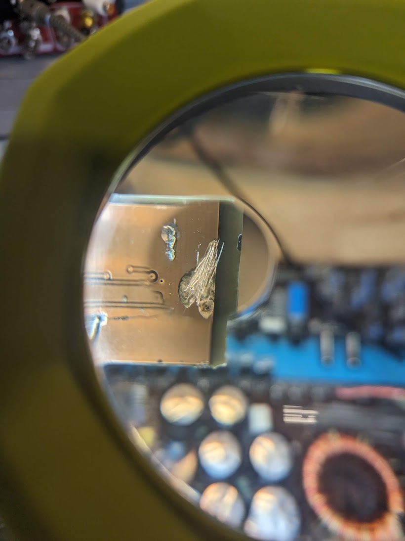

In the area of that via, is the copper there but corrodded or is it corroded away?

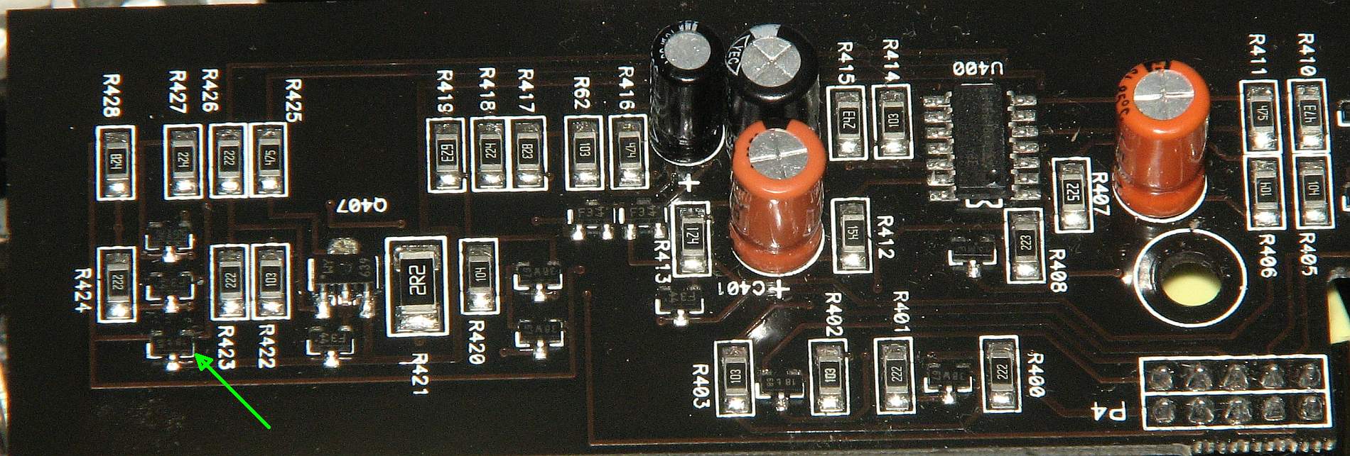

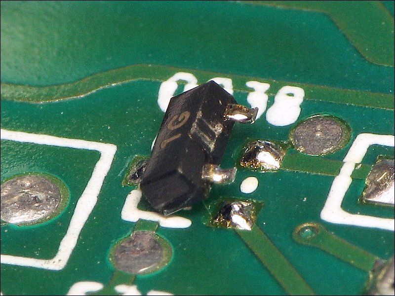

Check the transistor indicated by the arrow in the photo. Remove it and check it for open junctions and leakage as well as shorts.

The copper is there - see attached. I could drill that via and connect through to the traces just to see if it helps.

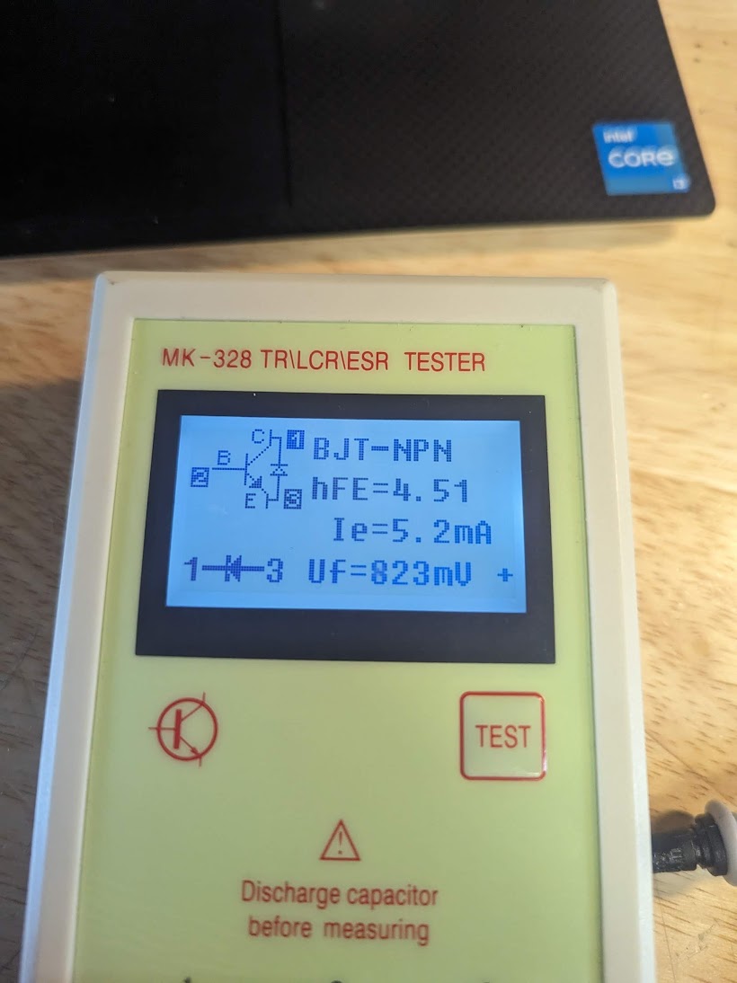

Ok - I did not know a tester wouldn't be reliable for this.
For that transistor, with my multimeter in diode check, positive lead to negative lead:
  • Base to emitter: 0.63V
  • Base to collector: 0.7V
  • Emitter to base: O/L
  • Collector to base: O/L
  • Collector to emitter: O/L
  • Emitter to Collector: 0.7V <--- this should be O/L, right?
It should be open. If you are ever uncertain, lift (as shown below) another transistor with the same markings and check it or compare to a new one if you have one in stock.
Those testers have caused me more problems trying to help others than you would believe.
That's great to know - and thank you for the pic - way easier than trying to probe them completely off the board!
So, it turns this transistor is the issue. I popped a 1Bt on to the board from my donor amp, and now there's no more 15 second turn on delay. The LV supply comes up instantly when remote is applied, and then persists or stays up for about 15 seconds after remote is removed (which I think is the correct behavior - if not please let me know).

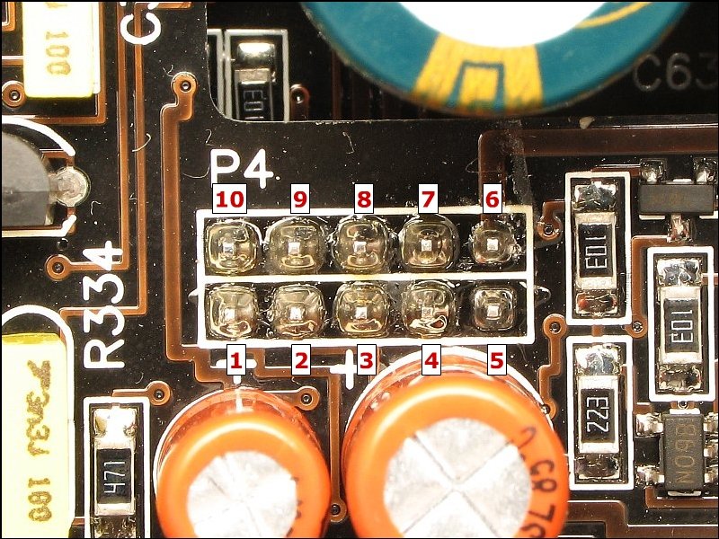

Are you referring to the pins on the 10 pin connector as numbered below?
Are you referring to the LM311 on the PS driver board (U702)? If not, which one?
Hi, my answers in [brackets] below:
1: "The bad amp (with either daughter board): pin 7 is 0.018V and does not stay high after remote is removed"
^^^ So it's never high, correct? [Correct]
2: "The good amp (with either daughter board): pin 7 is 0.64, and stays high for 15 secs after remote is removed"
^^^ High as in 0.64v? [Correct]
Are you referring to the pins on the 10 pin connector as numbered below? [Yes]
Are you referring to the LM311 on the PS driver board (U702)? If not, which one? [Yes, U702]
Ok, so I traced pin 7 through to pins 1 and 4 on the LM311, which are... gnd and VEE. It turns out when the daughter board is mounted in the amp, pin 7 becomes connected to ground (which is why I thought I found a direct connection). Which makes sense, considering the voltages I read on pin 7 for the bad amp with either daughter board installed (18mV).

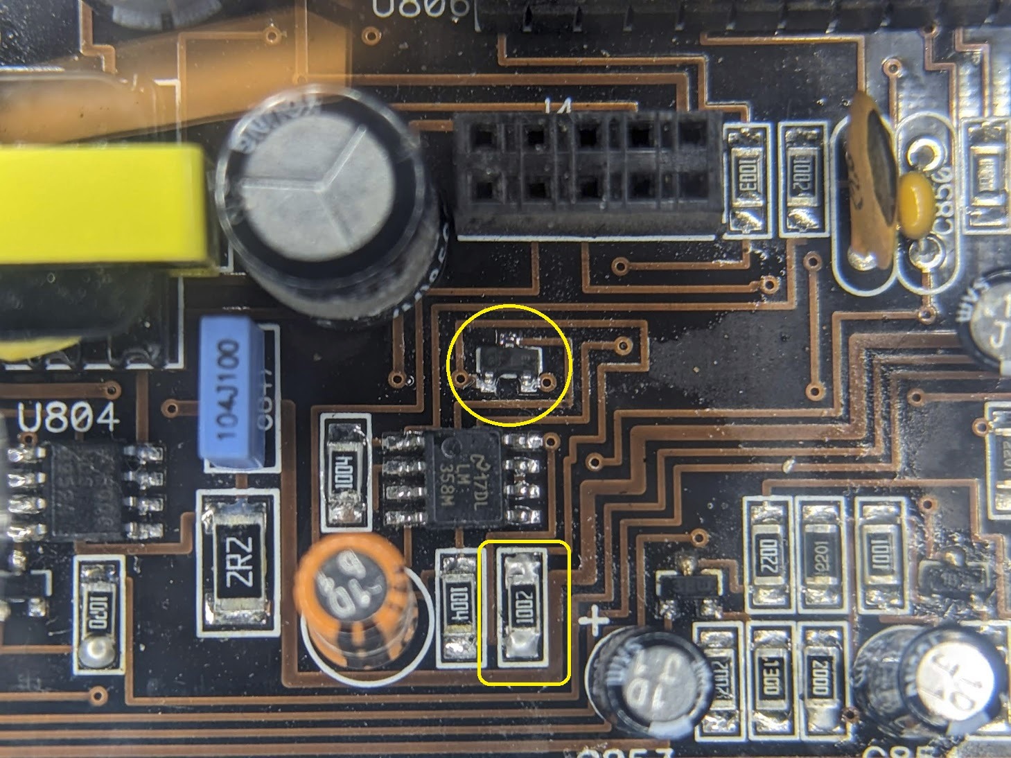

Hey, I've got great news! I've got good pwm drive on the SG3525 through to the gates at the supply FETs. So this amp will live again.
I found two issues in the circuits near the 10 pin header on the amp board. The ZC in the pic, was shorted base-emitter. The emitter of this npn was connected to ground through the via.
I also found the 10k resistor (see the pic) was reading open - it's a pull-up resistor I think, also connected to pin 7 on one side and LV supply on the other.
Anyway, I'm going to get to work ordering new FETs, get this guy up and going. Since the amp is apart, I'm thinking it would be good preventative maintenance to change the outputs as well? Is there anything you recommend for either the power supply FETs and output FETs? I think I saw IRF3205 for the PS were recommended, but I can't remember where just now.
