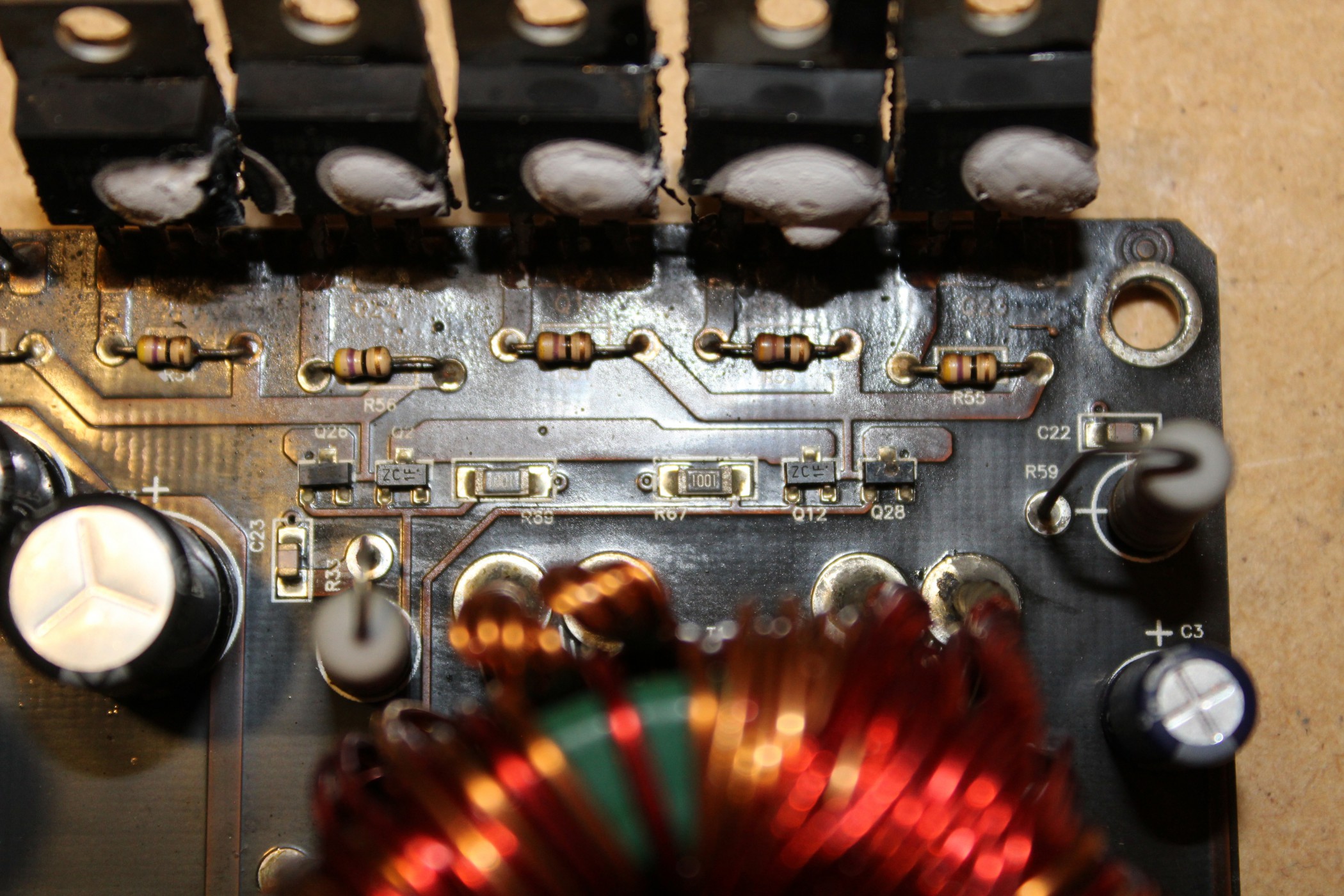

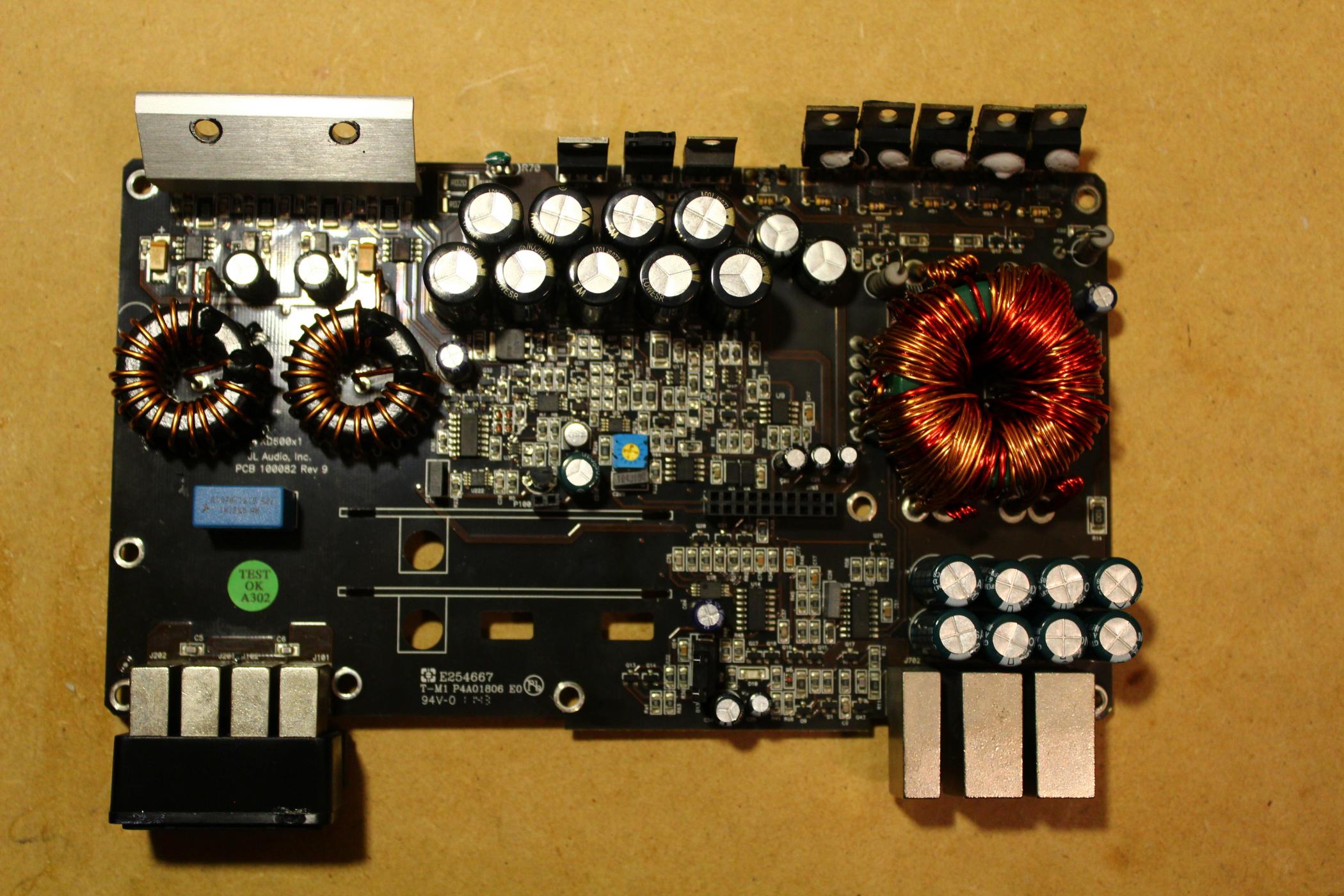

I have a JL Audio XD600\1 that i recently acquired from a friend. I have purchased new mosfets for the power supply, as well as the gate resistors. My issue is that I cannot identify what the gate driver transistors are in order to purchase them as well.

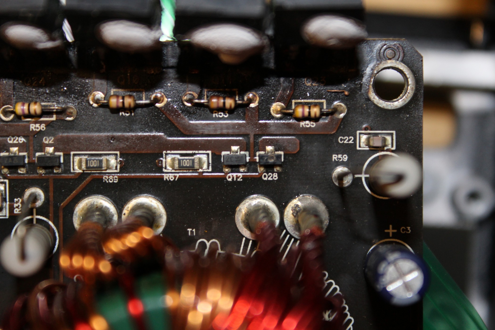

The board is a PCB rev 9. The transistors are SMD and seem to be of the S0T-23 package, but im not sure. The first transistor (Q26 and Q28) is marked longways with ZA and perpendicular to that is an 0H. The second transistor (Q2 and Q12) is marked longways with ZC and then perpendicular to that is 1F.

Thank you so much Perry! I figured it would be you who came through with an answer.
