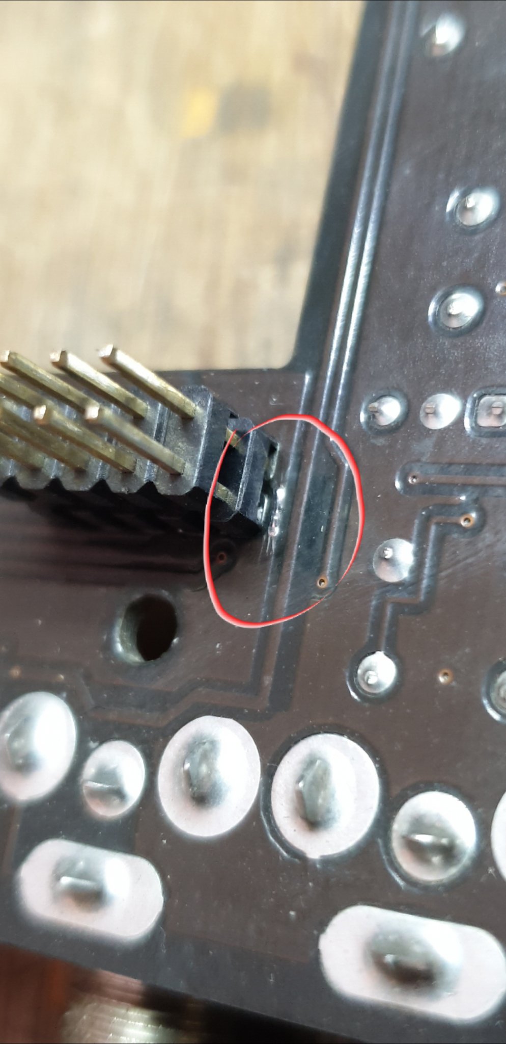

JL Audio Slash 500/1 low ohm led
Incredible, this small bridge opened and did not allow it to turn on

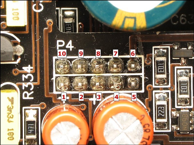

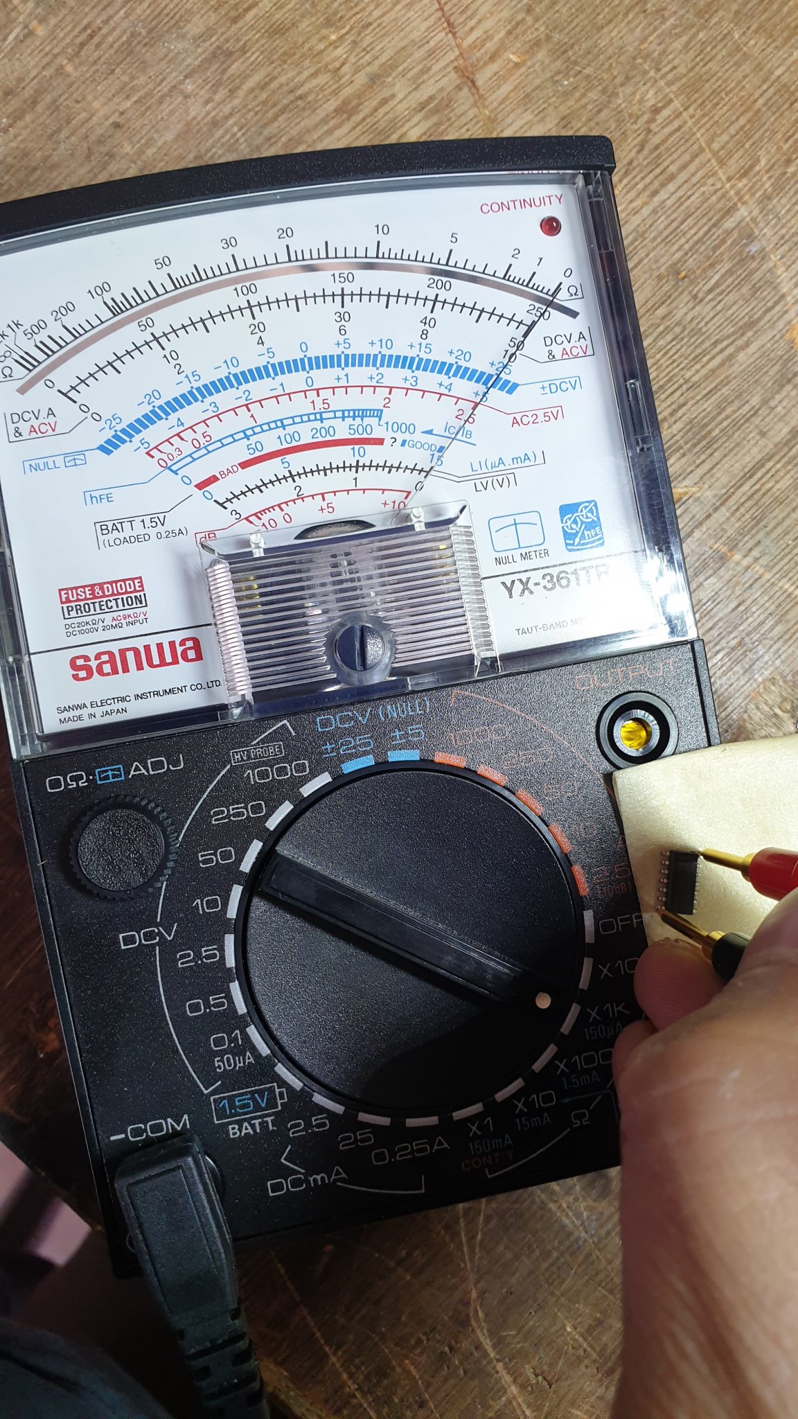

Copy and paste the following list and fill in the blanks. If there is no blank space after the colon, add one between the colon and the numbers you enter. It makes it much easier to read.
DC voltage on the 10 pin header in attached photo?
Pin 1:
Pin 2:
Pin 3:
Pin 4:
Pin 5:
Pin 6:
Pin 7:
Pin 8:
Pin 9:
Pin 10:

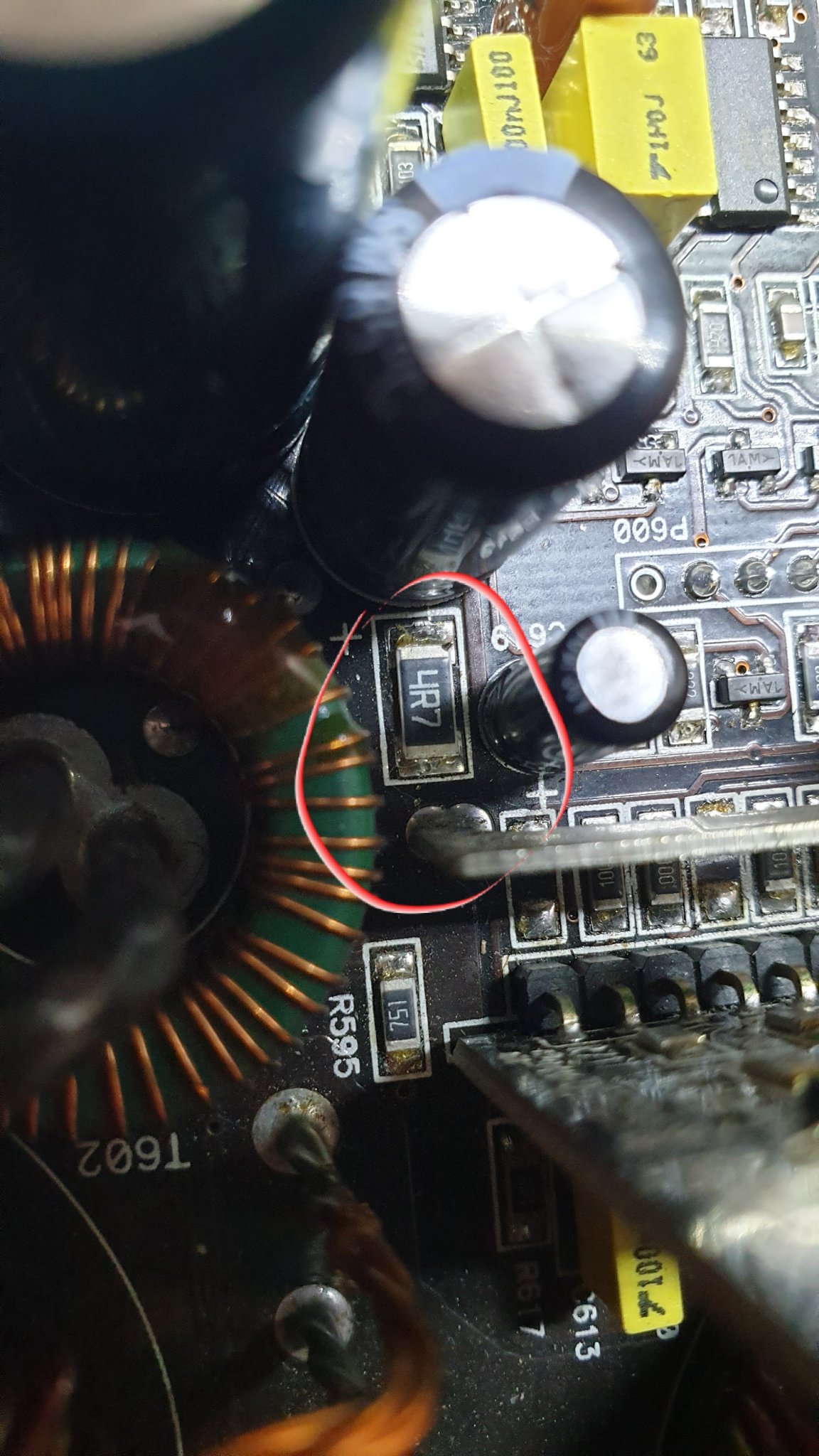

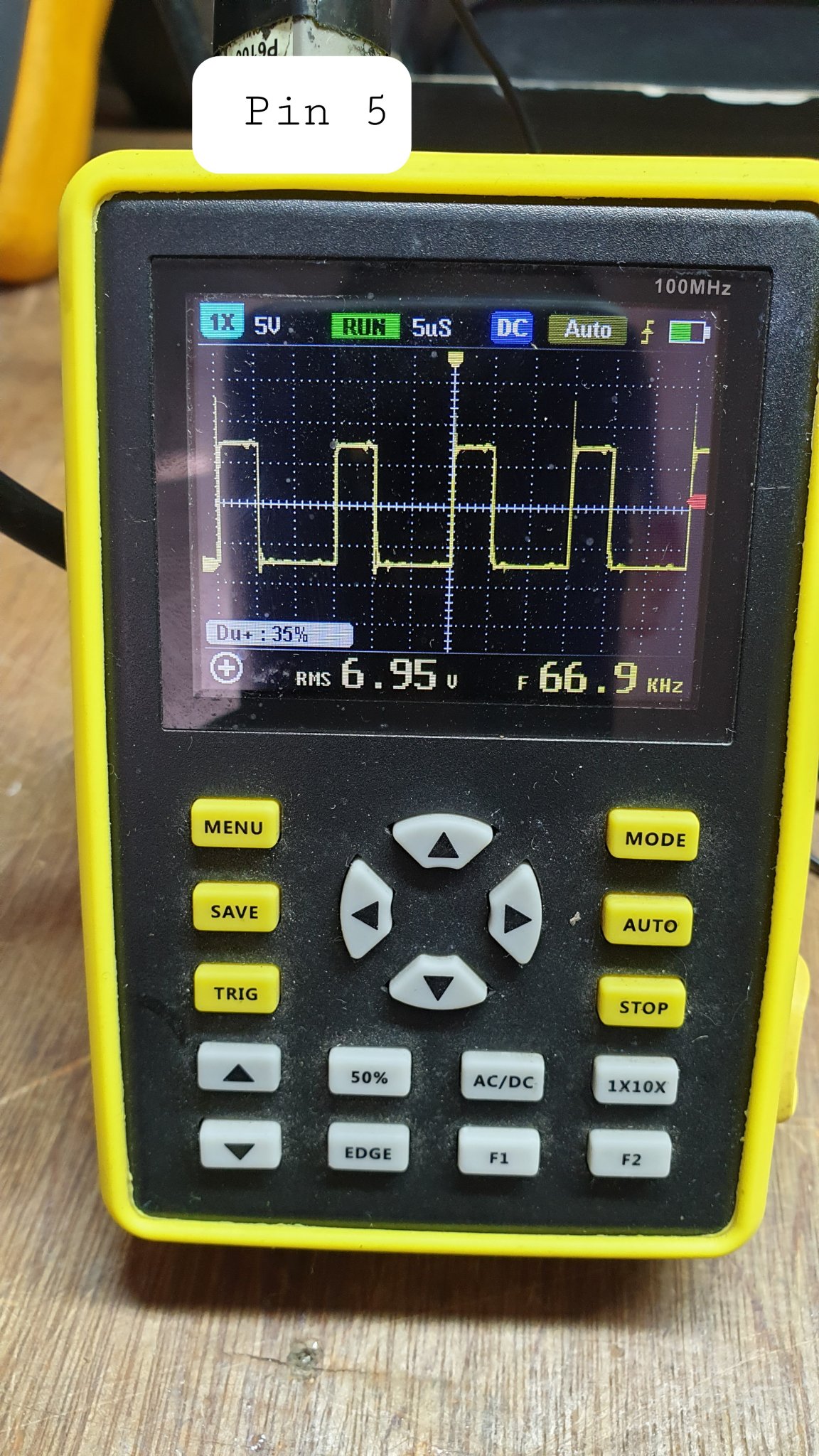

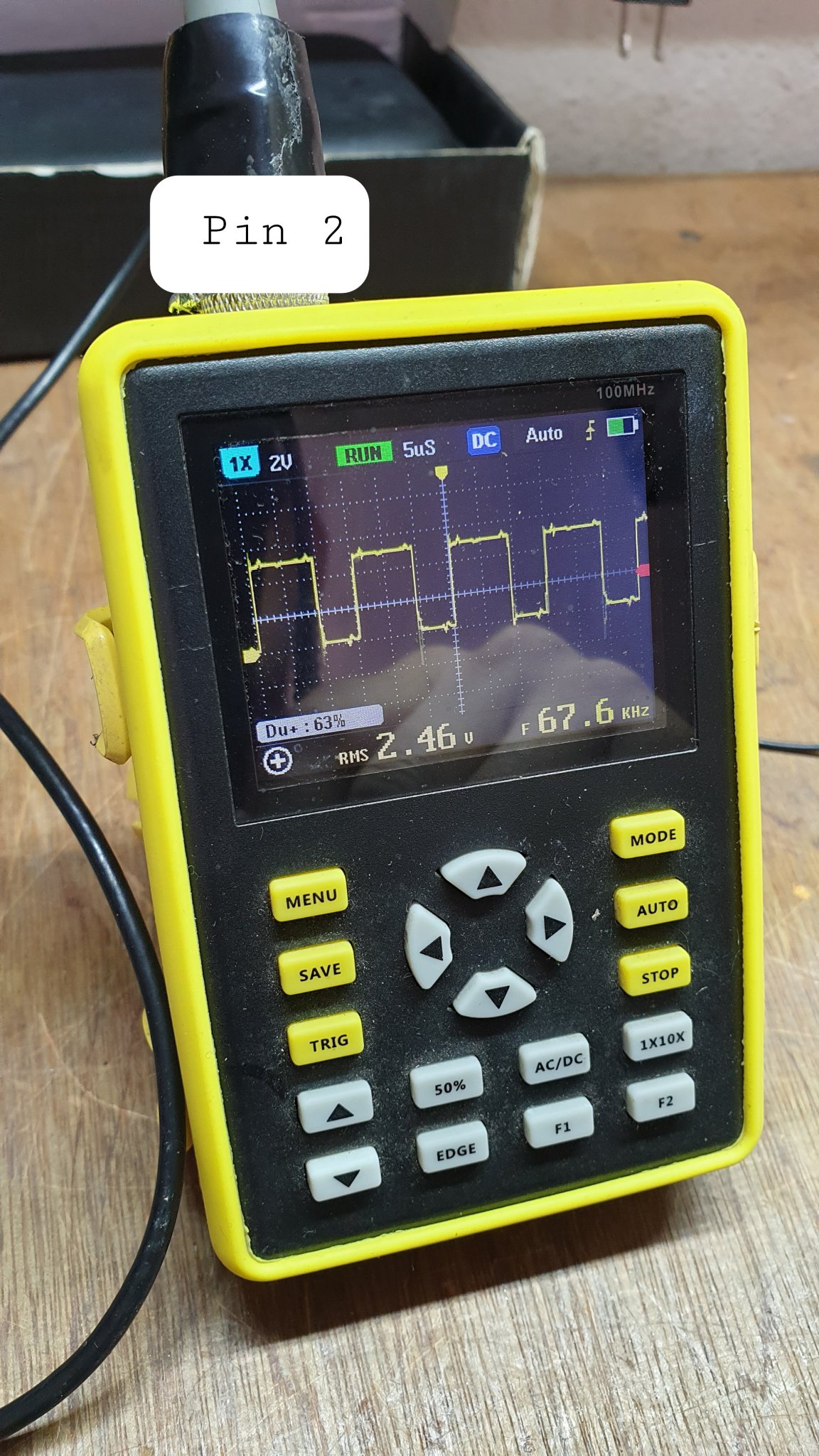

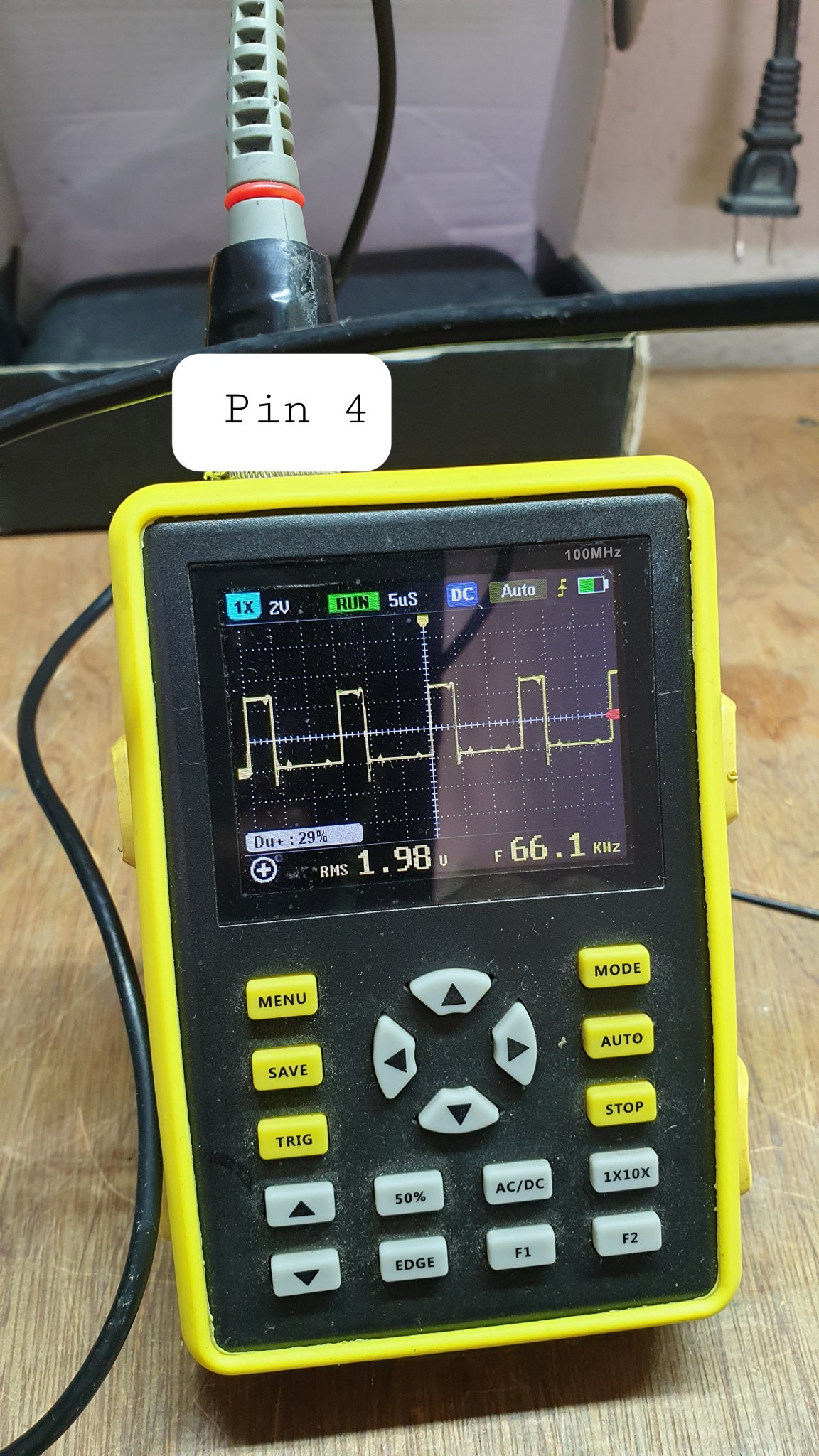

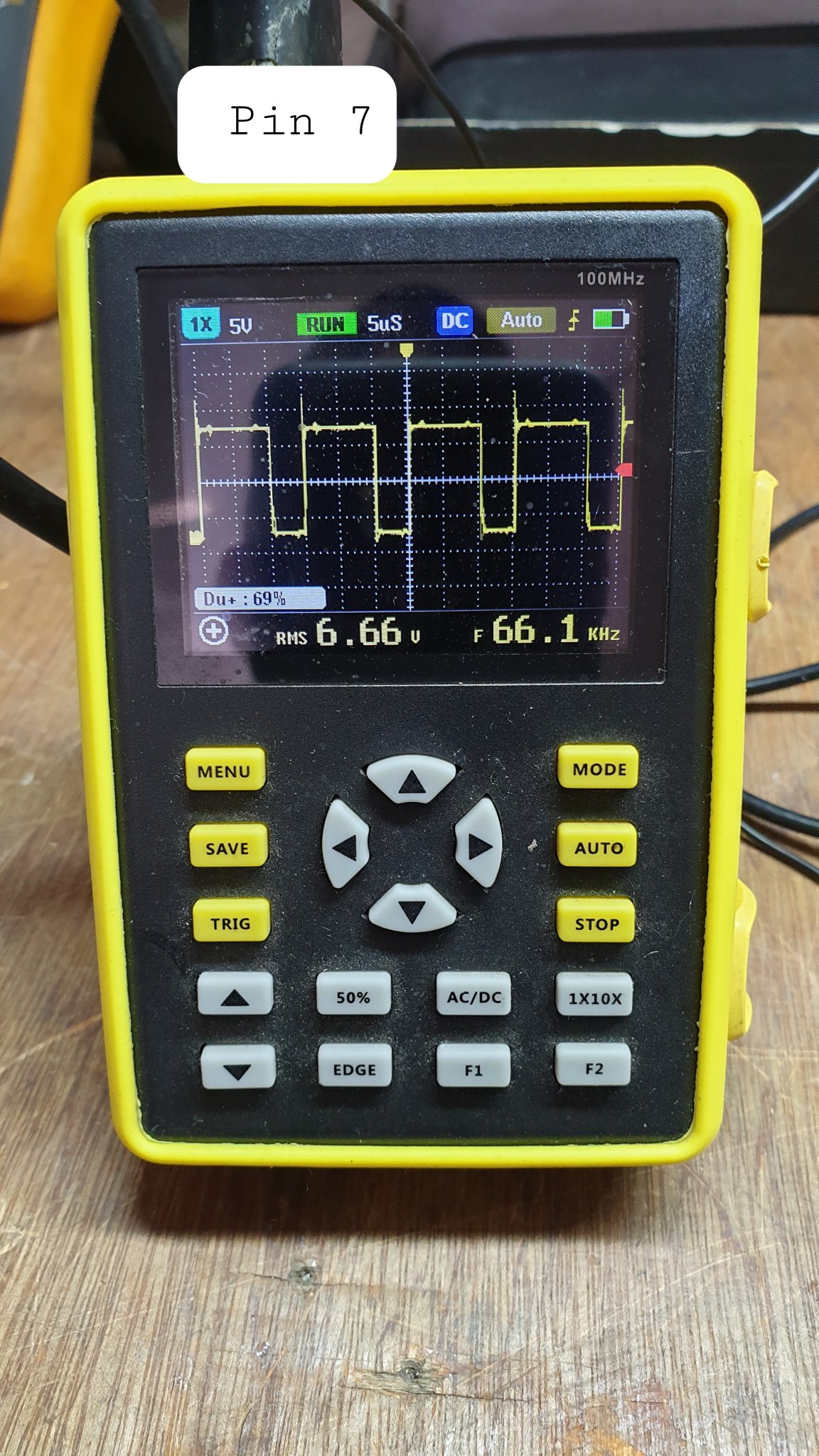

hi, I just found a shorted SN74AHC132 and I removed it and returned the pulse to the low voltage fet, I don't have to change it, at the moment I only have 74HC00D, do you think I can replace it with the 74HC00D?

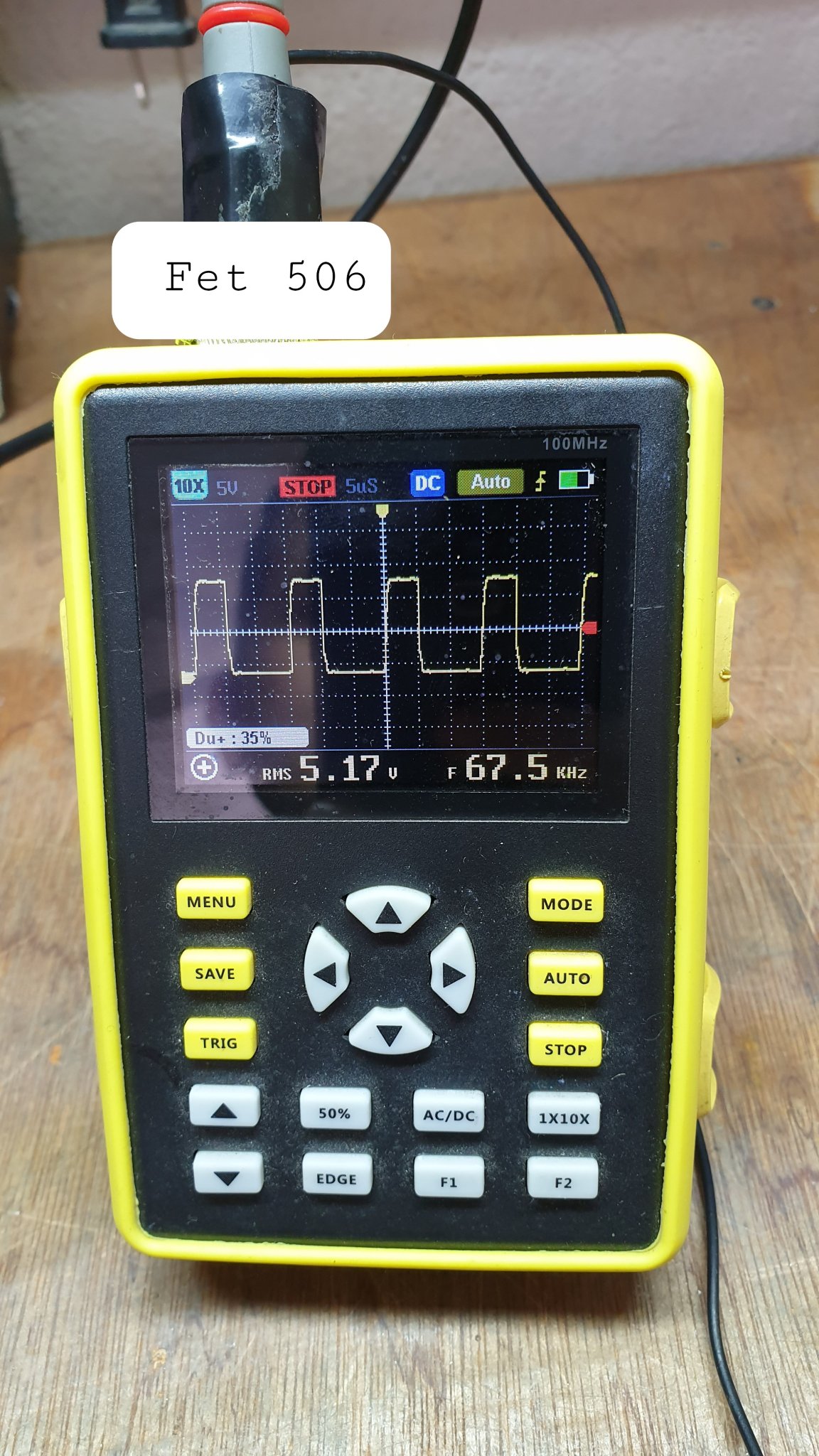

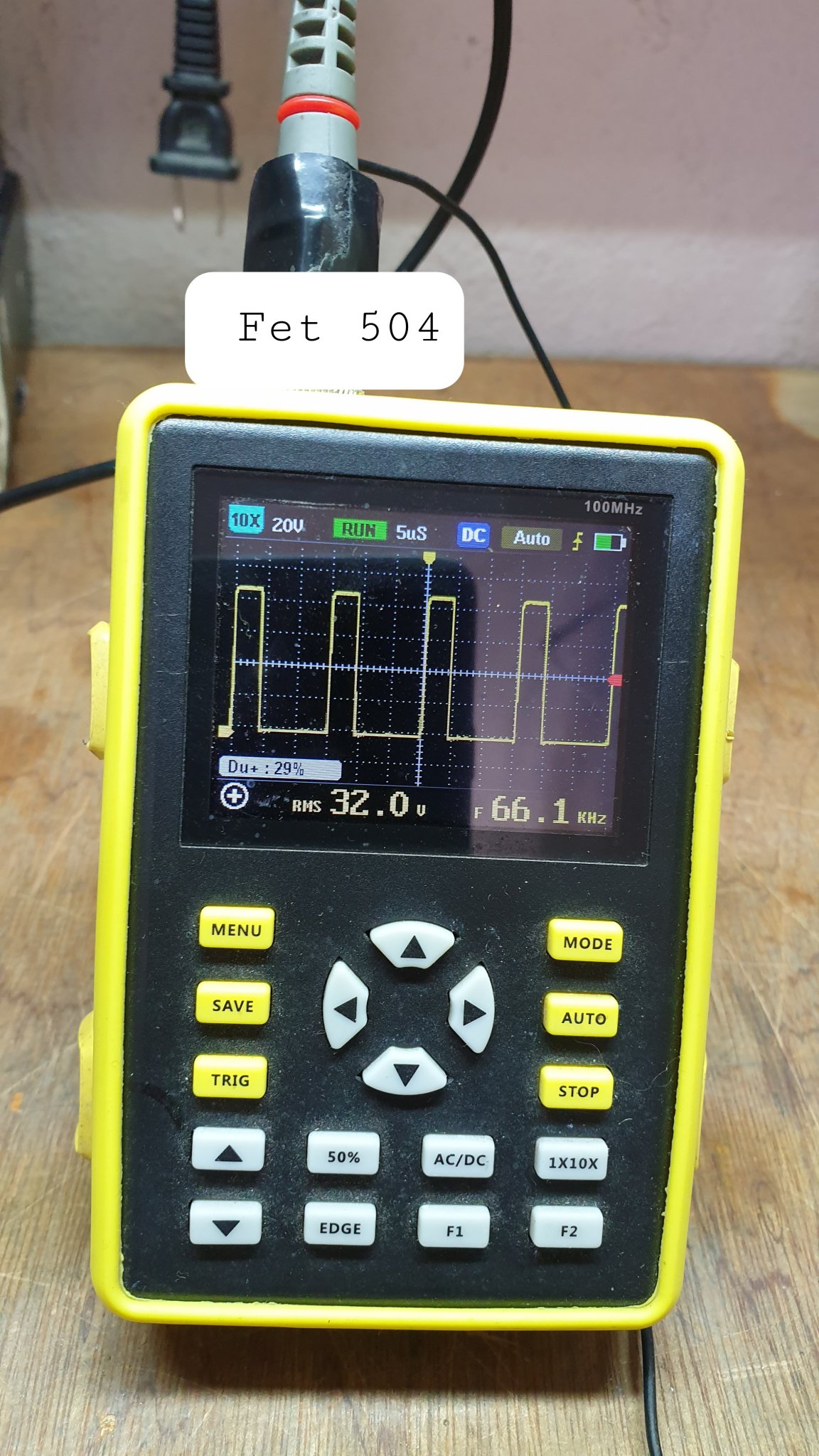

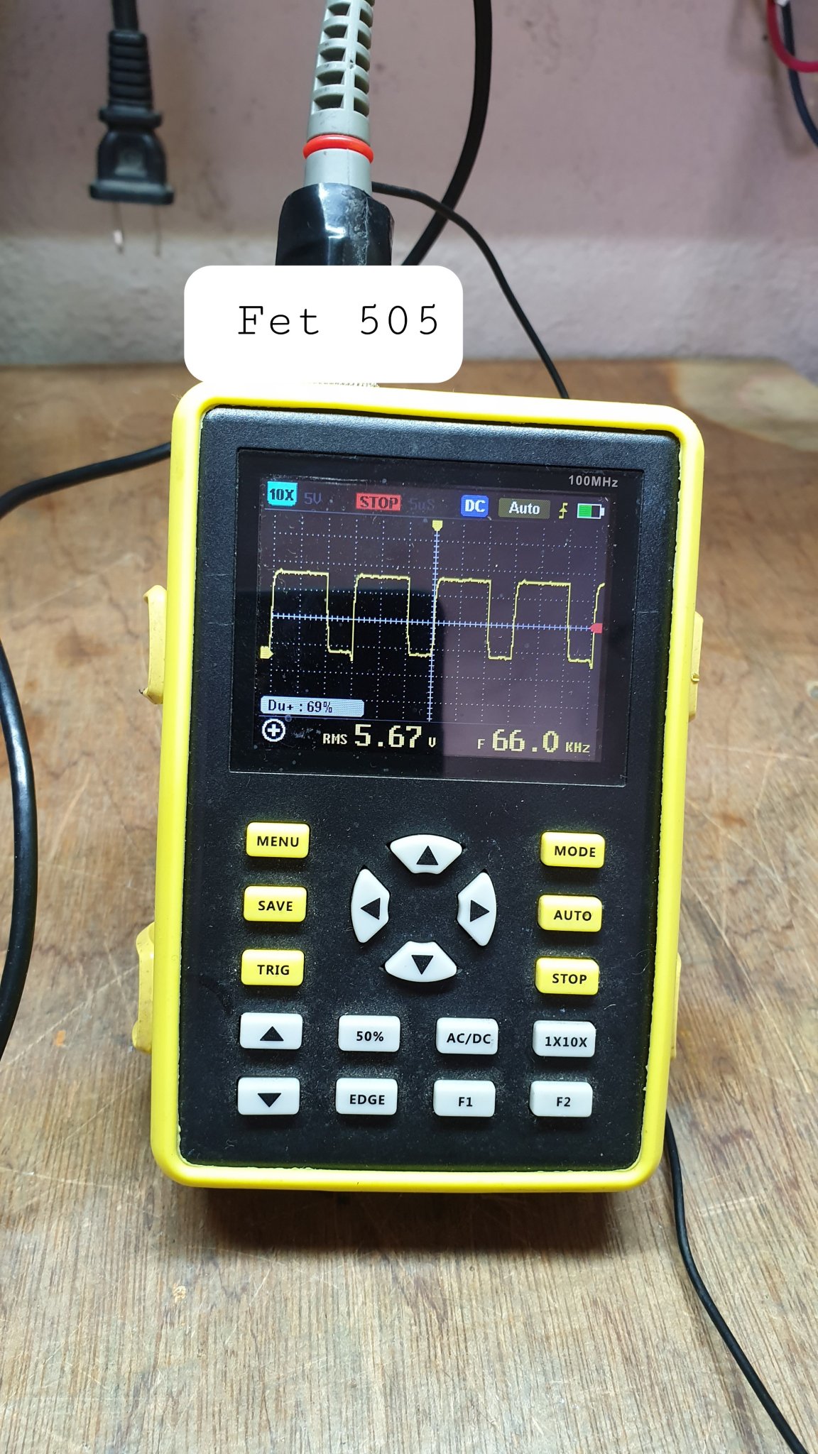

Are you saying that you read 23v DC when you measure with the 2 probes in the positive and negative speaker terminals?

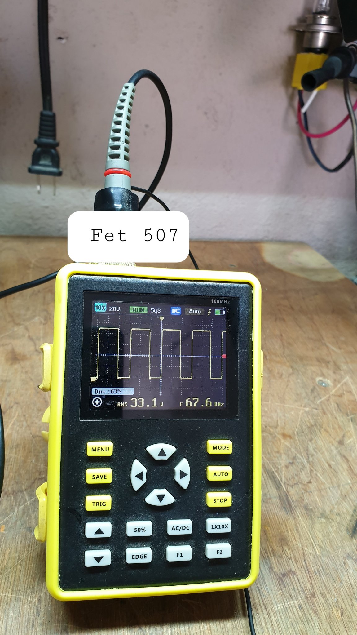

How do the gate drive signals (directly on the leg of the FET) of the FETs heating up compare to the drive signals of the corresponding FETs in the other bank of outputs?
These are the gate signals in all the output fets, when I take a reading from the subwoofer terminals, placing my multimeter's negative on the power ground and with my multimeter's positive on the speaker terminals I see 52.5v on the speaker's negative and 23.75 v on speaker positive should i see 52.5v on both? I hope you understand
