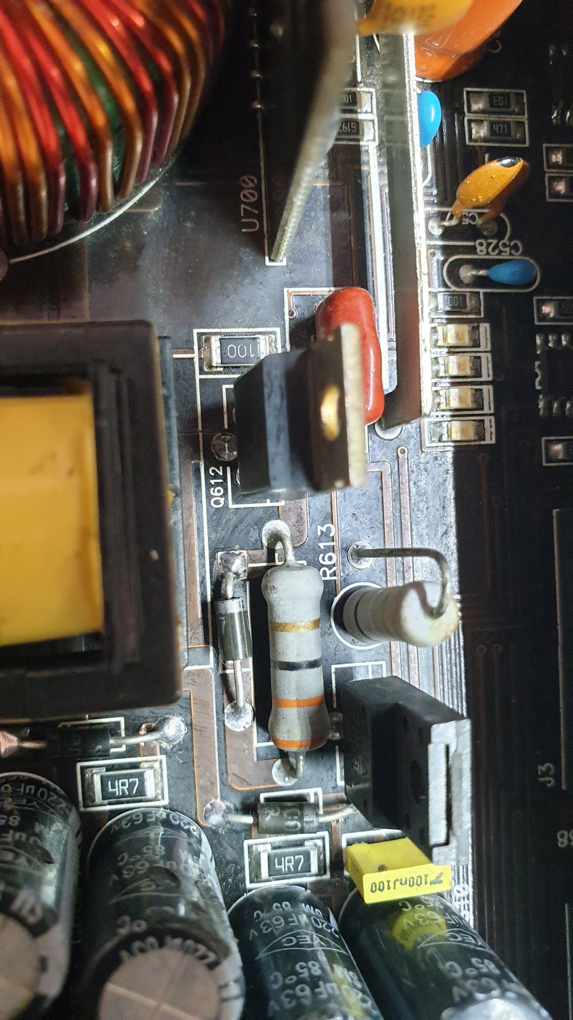

ground and pin 2 of the d600Where is the waveform taken from? I wouldn't expect that much ripple.
only the wave in the central pad of the d600 is more stable after placing the mur1660fct and with the change of the 2n3906
What's the resistance from the center leg of the rectifier to the center leg of the high-side FET?
I already got lost, but that's how they are shown in each of the fets
Q504: 0.3 ohms
Q505: 1.7mohms and increasing
Q506: 12 kohms and increasing
Q507: 0.2 ohms
all with respect to central pad of the rectifier
Q504: 0.3 ohms
Q507: 0.2 ohms
Q504 and 507 are the high-side FETs.
There's no reason that touching the probe of the meter or scope should cause excessive current draw.
It does it even without touching the oscilloscope, I'll have to find out what is causing them, what makes the PS fets heat up.
