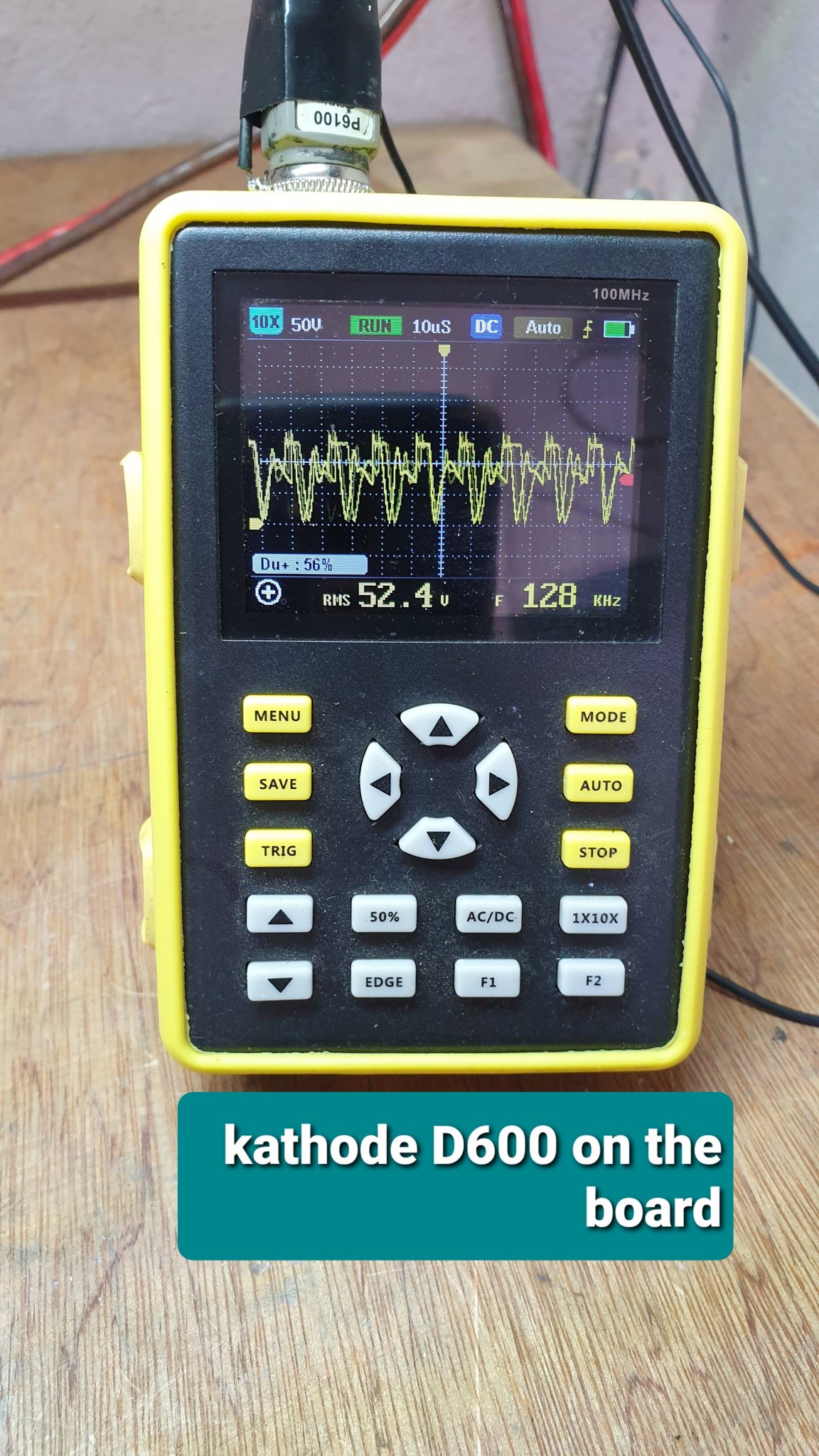

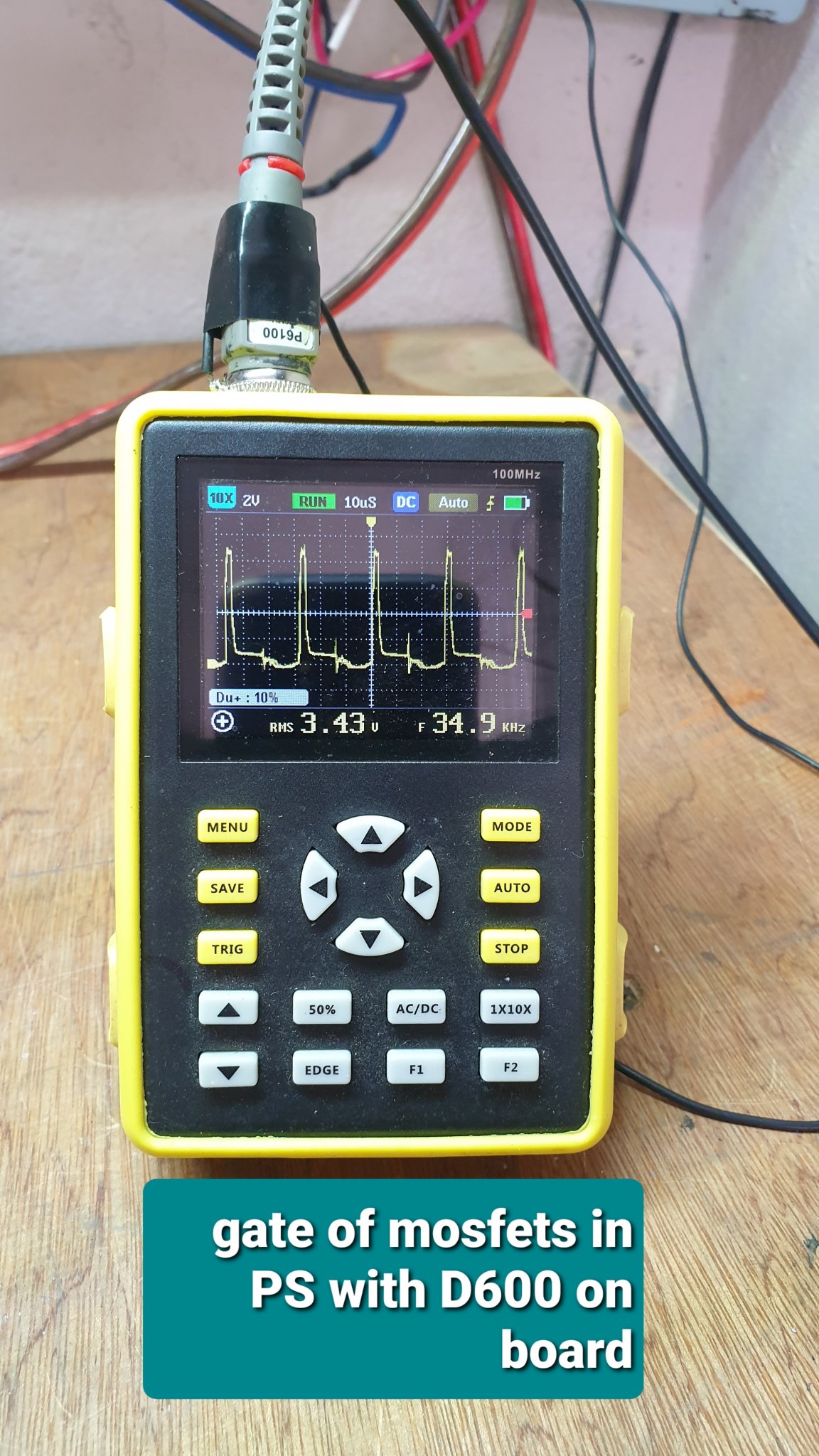

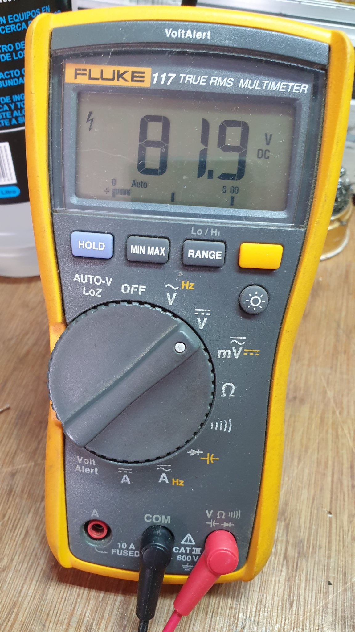

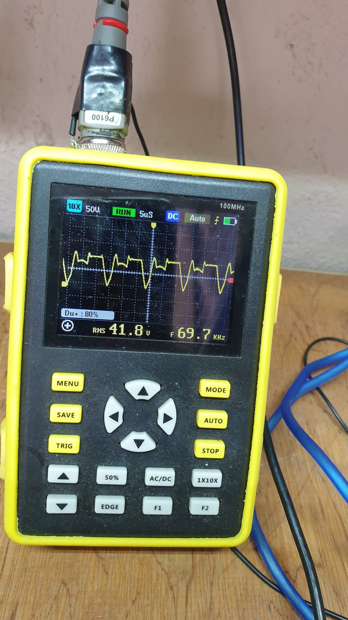

I already found the fault they were two of these schottky diodes, I replaced the 4 greetings and thank you very much
