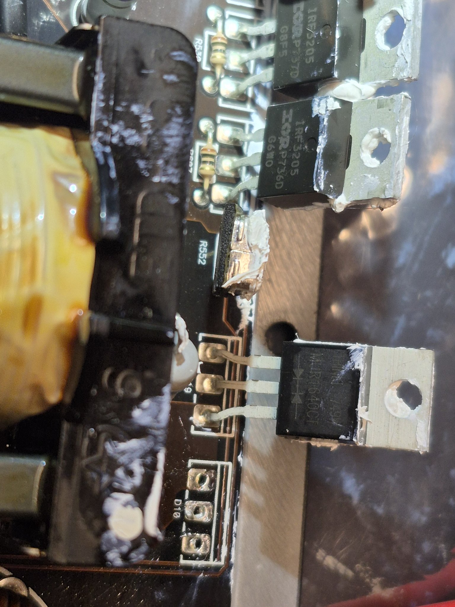

What's the resistance between the center pins of those two components?
In the 750 I posted, the FET that's in that location works with the rail voltage in an odd way (it's connected between the rail and the driver higher than rail voltage). From the traces on your board, it looks like it might have two positive rectifiers. That's why I need the resistance between the two center terminals.

These 2 on the right appear to be rectifiers as well. That's how I got confused. So i should reinstall the mur1640cta that i just removed ?Yes the rectifiers are in the other side of the amp...View attachment 1451033
In which post did I call the 2552 a rectifier?
I need the resistance between the center pads of those two component locations.
This is what I removed on my first day of working on it.
Im too confused now. Maybe i installed in a wrong location.
In post 62 and 63In which post did I call the 2552 a rectifier?
I was referring to the rectifier that you previously installed.
Are you, for some reason, unable to measure the resistance between the center pads/pins of D? and D10 (the two adjacent components) on your board?
I understand. I don't care about the component. I want to know about the board connections, hence the term 'pads'.
