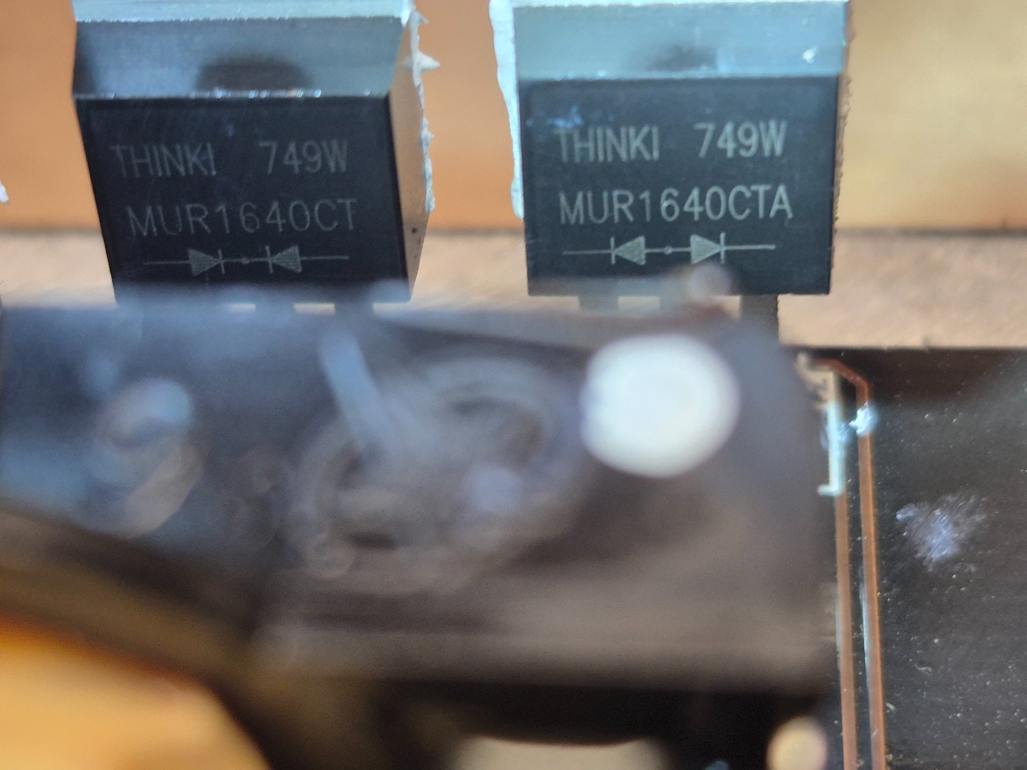

Excuse the quality of the handheld images.
This is what my cheap scope does. The low frequency is 20kHz (10us) The high frequency is 80kHz (2us). 80kHz is just about the lowest frequency that class operate at and you can see that the cheap scope cannot properly display it. The OWON does an acceptable job but the CRT scope gets it right (clean and clear). I know CRT scopes are a luxury nowadays.
What other amp do you have that you have to check the scope with?
