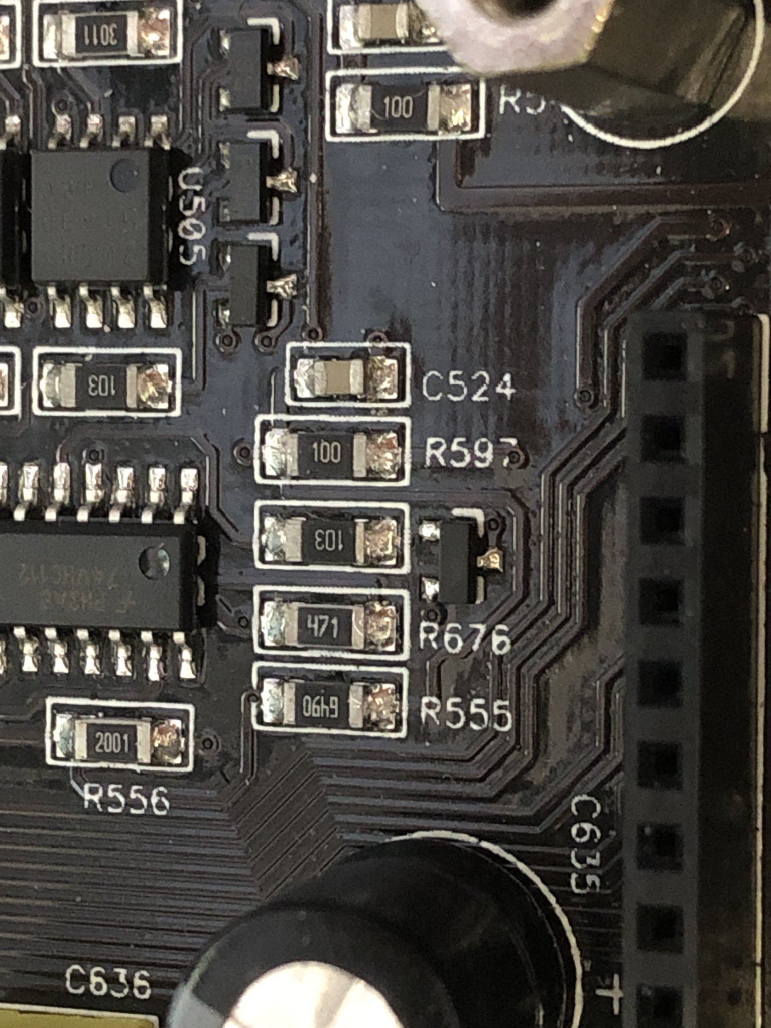

I forgot about the 10 ohm resistor in series with the diode. The 47 ohm is across that series pair of components.

is this a good 47ohm alternative. this one is 1/4w the link above is 1/2w

No. The size typically gets you the right power rating. These are gate drivers and don't dissipate any significant power. A 1/6w would likely work for this application (but use a 1206).
There is virtually no chance that those resistors are defective. I wouldn't explore too much in this amp. It's VERY complex and some of the ICs are static sensitive. There's no point in doing damage where this is none.
Most all SMD resistors will show some signs of damage when they're bad. These do not. Add to that that these are in a part of the circuit where there is VERY little current flowing.
Double-check your meter to see if it's set to auto-ranging. If you hold the metal parts of the probes in your fingers (probes not touching), does it read anything?
It’s late and i have work in the morning. Thank you for the explanation and being patient. I thought the amp was dead cause I wasn’t about to start replacing everything lmao but you made me feel better about this process. I will check tomorrow and proceed. Again thank you
This is the multimeter i have https://data.kleintools.com/sites/a...s/instructions/klein/MM400_1390110ART_WEB.pdf
Try going to manual, to the highest range to see if it will register if you touch the probes.
Do you have a second meter?
