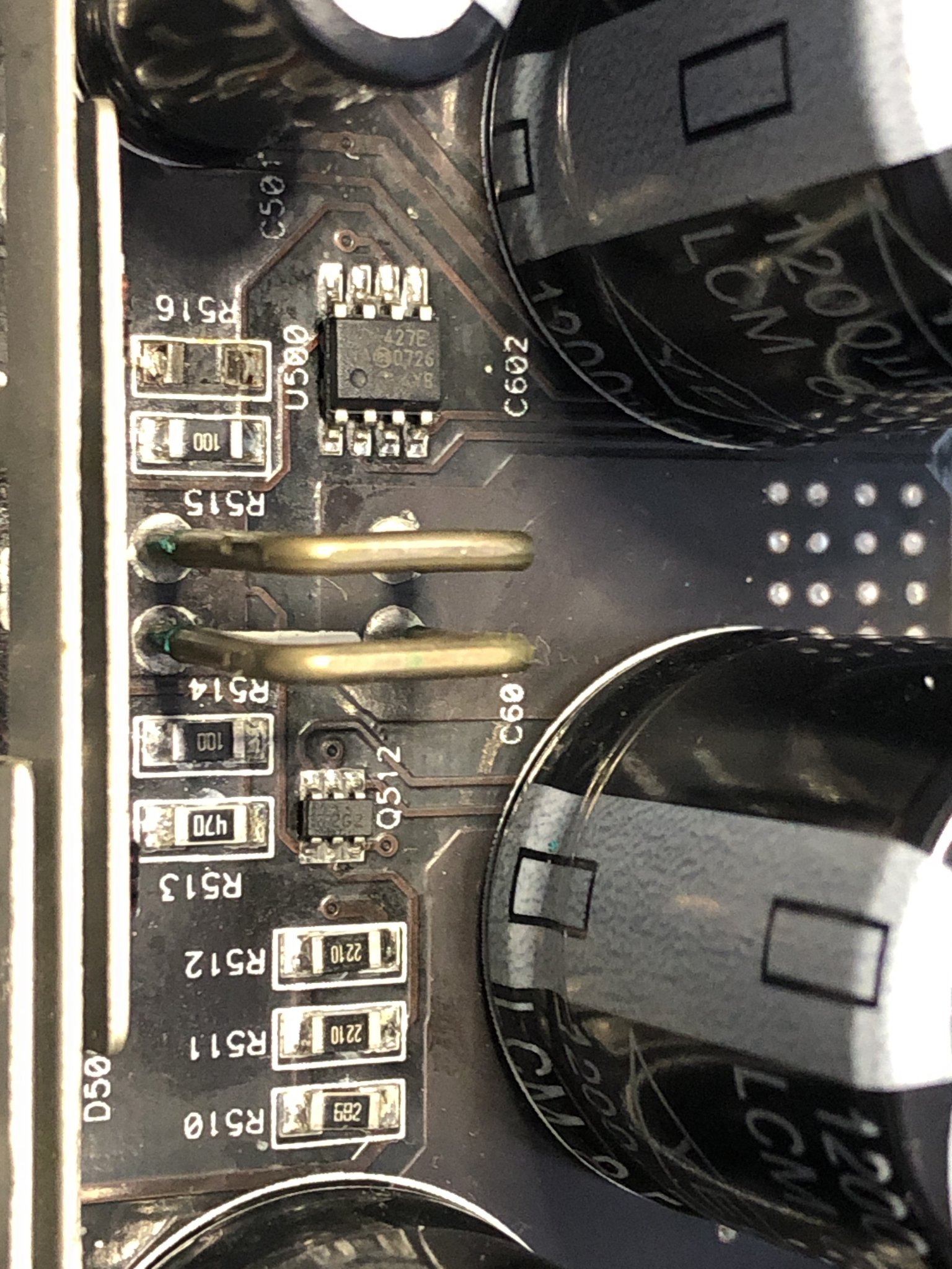

Don't you have any 10 ohm resistors in stock?

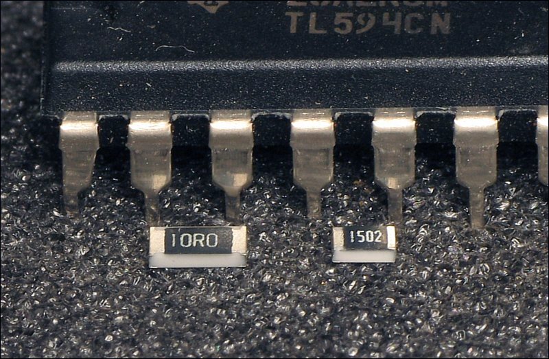

Measure the original and order the same size. I think it will end up being 1/2w. The one you listed was too small.
You don't need to spend a lot of money on one. I bought 3 for $10 shipped and they were OK for basic measurements. The cheapest one you can find will likely be good enough.
The dimensions are given on the site and if not directly, in the datasheet. L and W are all that's needed.

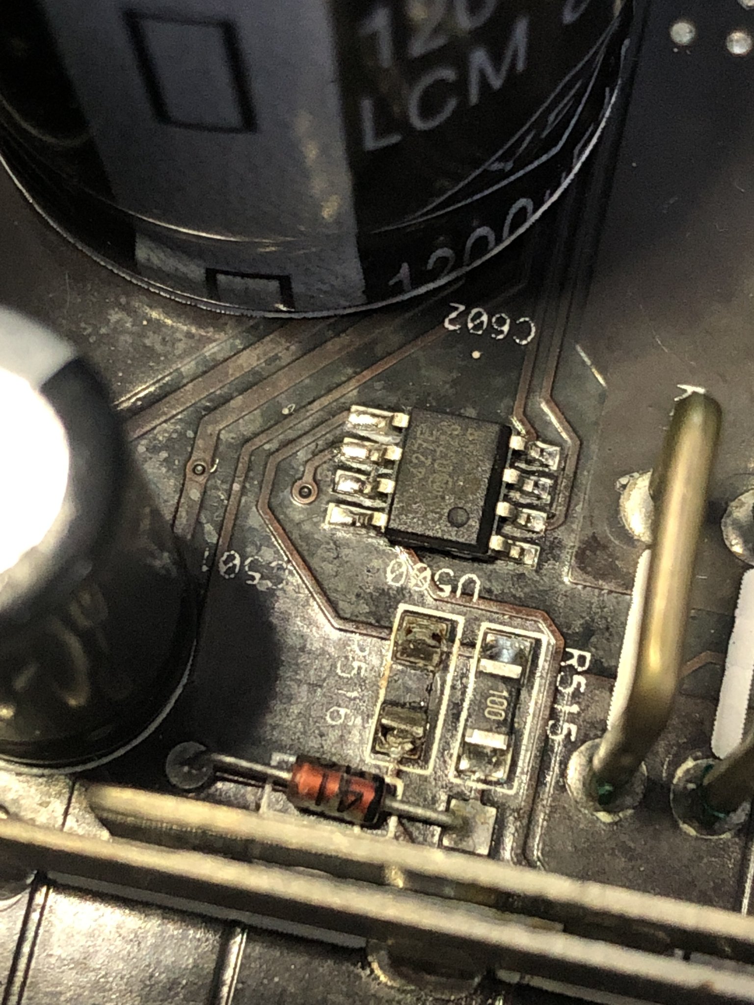

The power rating is OK but it seems a bit large, If you zero'd the caliper and you measured other items to confirm that you're getting accurate readings, it's likely right. Remove the old one from the pads and confirm that the length will fit on its pads. Order extras.
It doesn't need to be 1% tolerance. the original is 5%.
Yes I zeroed out and it’s 5mm length and I confirmed it will fit on the pad

Were any of the outputs shorted?
There are two identical circuits for two of the banks of outputs. You can get the value from there. If you can't, let me know.
