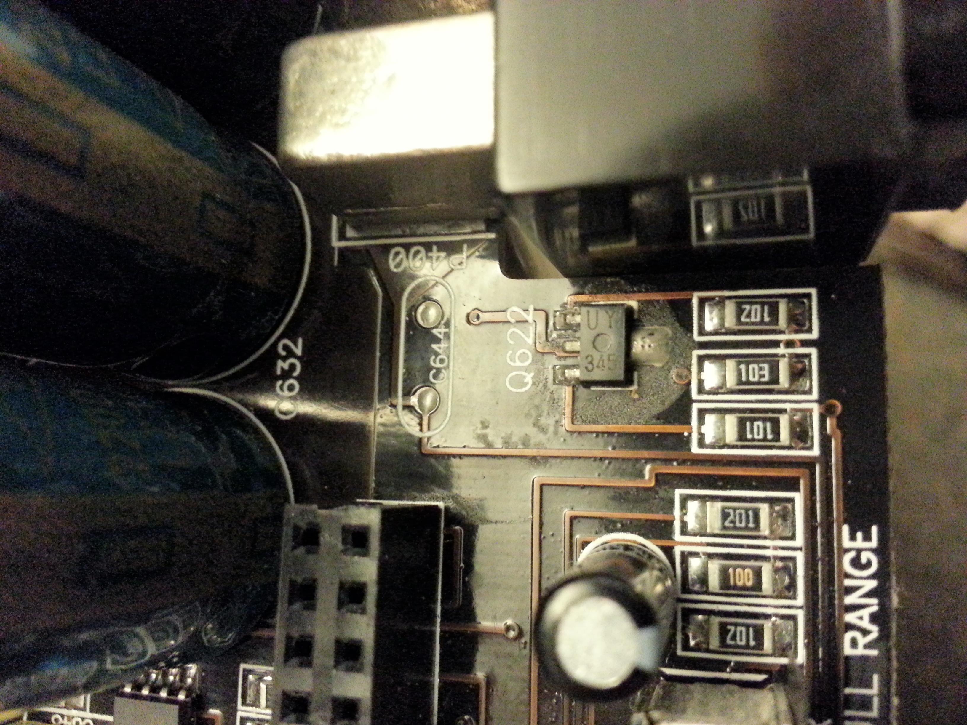

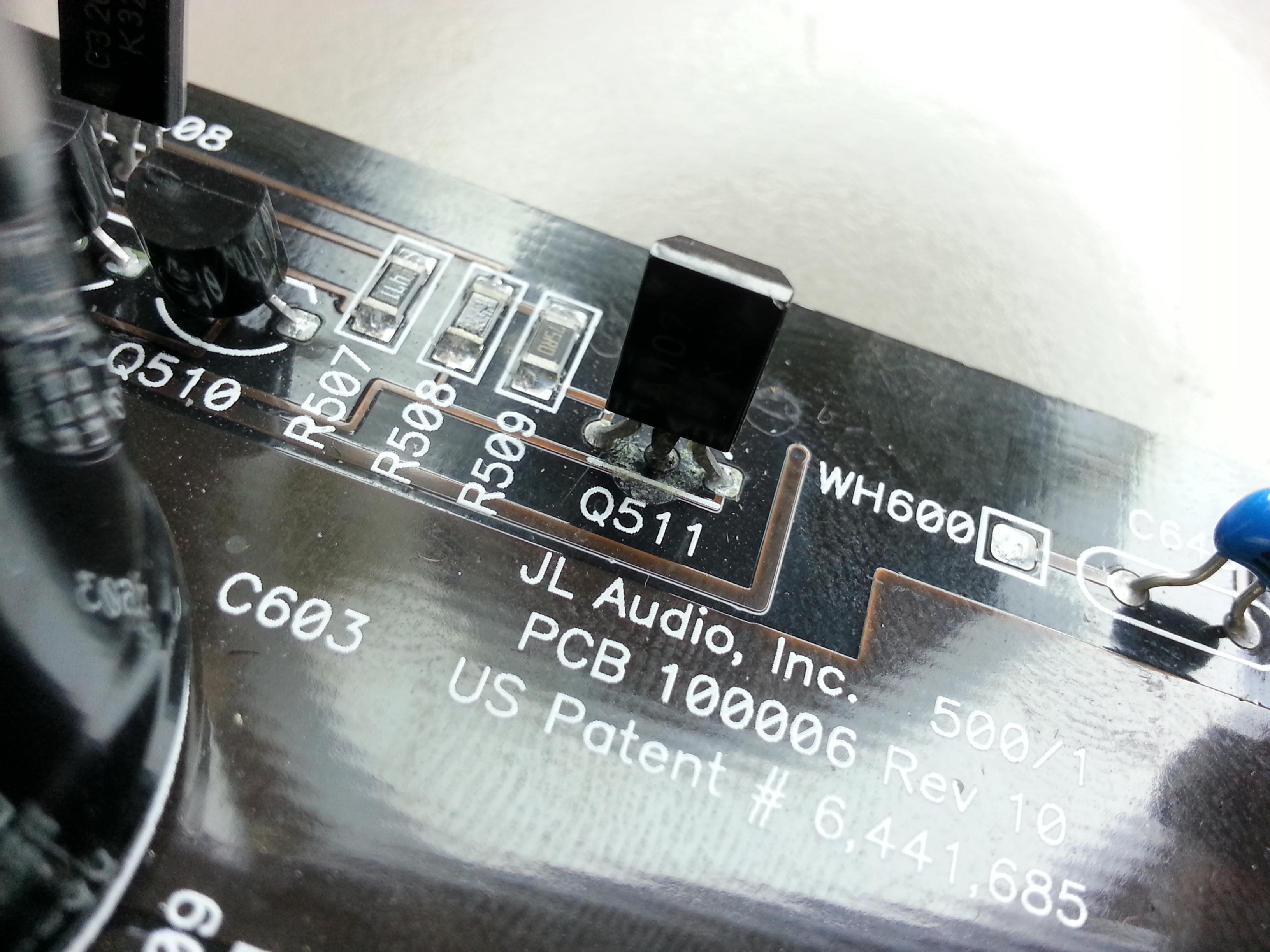

Jl audio 500/1 excessive current draw
The amp has low voltage protection that will shut it down when the voltage drops too low. The problem could simply be that the voltage is dropping. You need to clamp all semiconductors to the heatsink and power it up from a supply capable of delivering more current. Insert a 15 amp AGC/ATO fuse to protect the amp in case there is a problem.
Not sure if these matters or not took two pictures of some transistors that had some discoloration around them. And if you think there isn't much else to do I will go again put it back into the case and see what happens. Thanks again.
