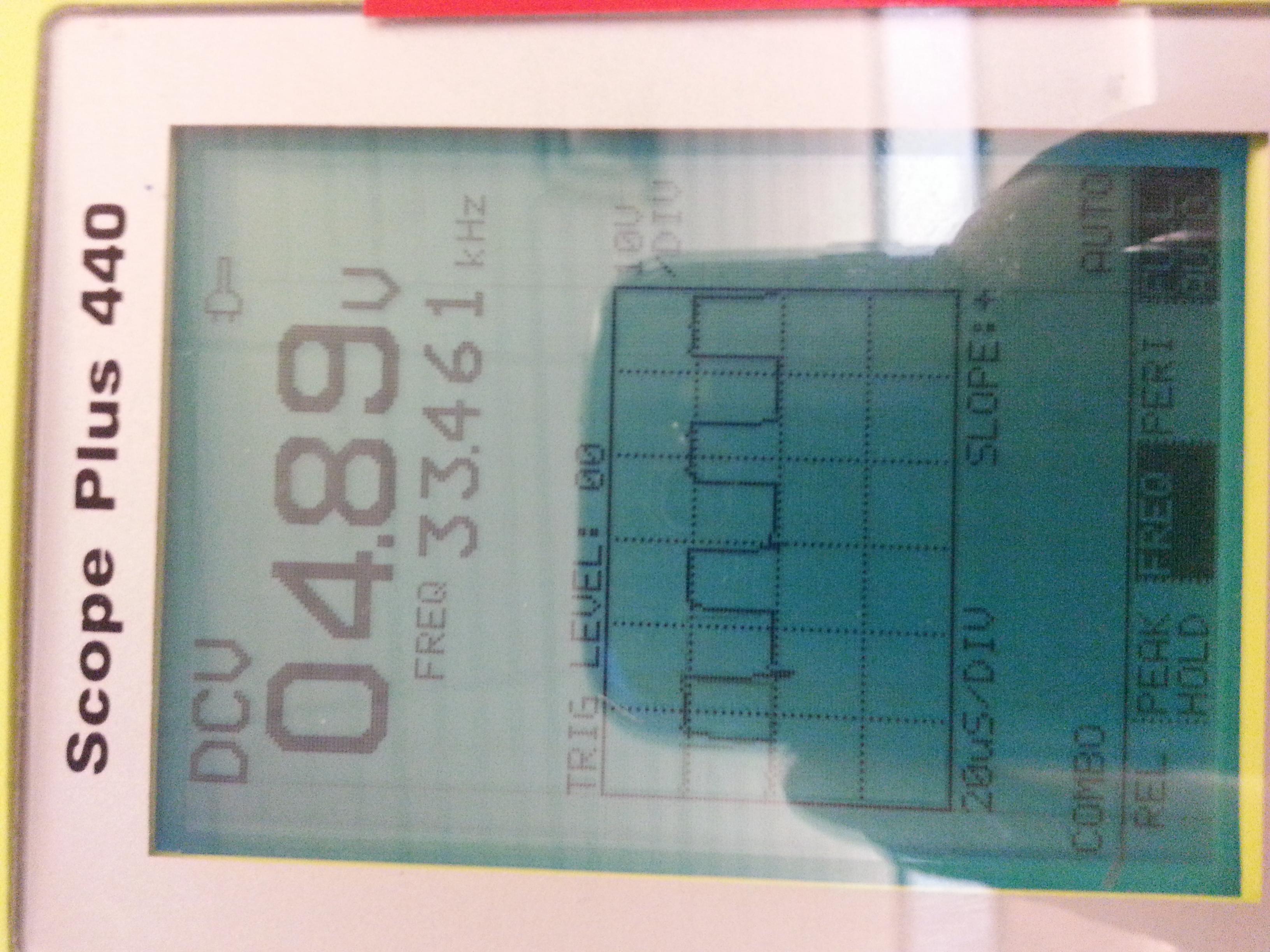

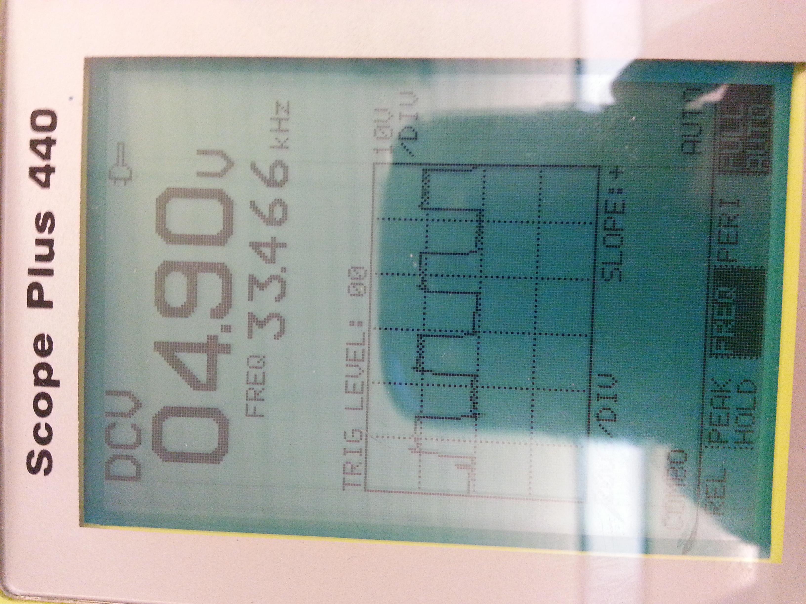

Remove the rectifiers next to the power supply FETs, install the PS FETs and check the drive signal. Do you get a clean square wave?

Big improvement no over heating and light does stay on but blinks once in awhile but could measure voltages those look good. I get my square waves back on the 4 ps transistors. But I am assuming since that is out no power is going to go to the output side since couldn't find anything there. Thanks

Measured all 8 fets in order g-d-s 6.09 v square wave 14.25 square wave and the source was 98.3mv. Are these values correct?

Alright I can do that. I will have to desoder the D600 before since that was the only way I can get any kind of waveform on this board then I will post the pics.
