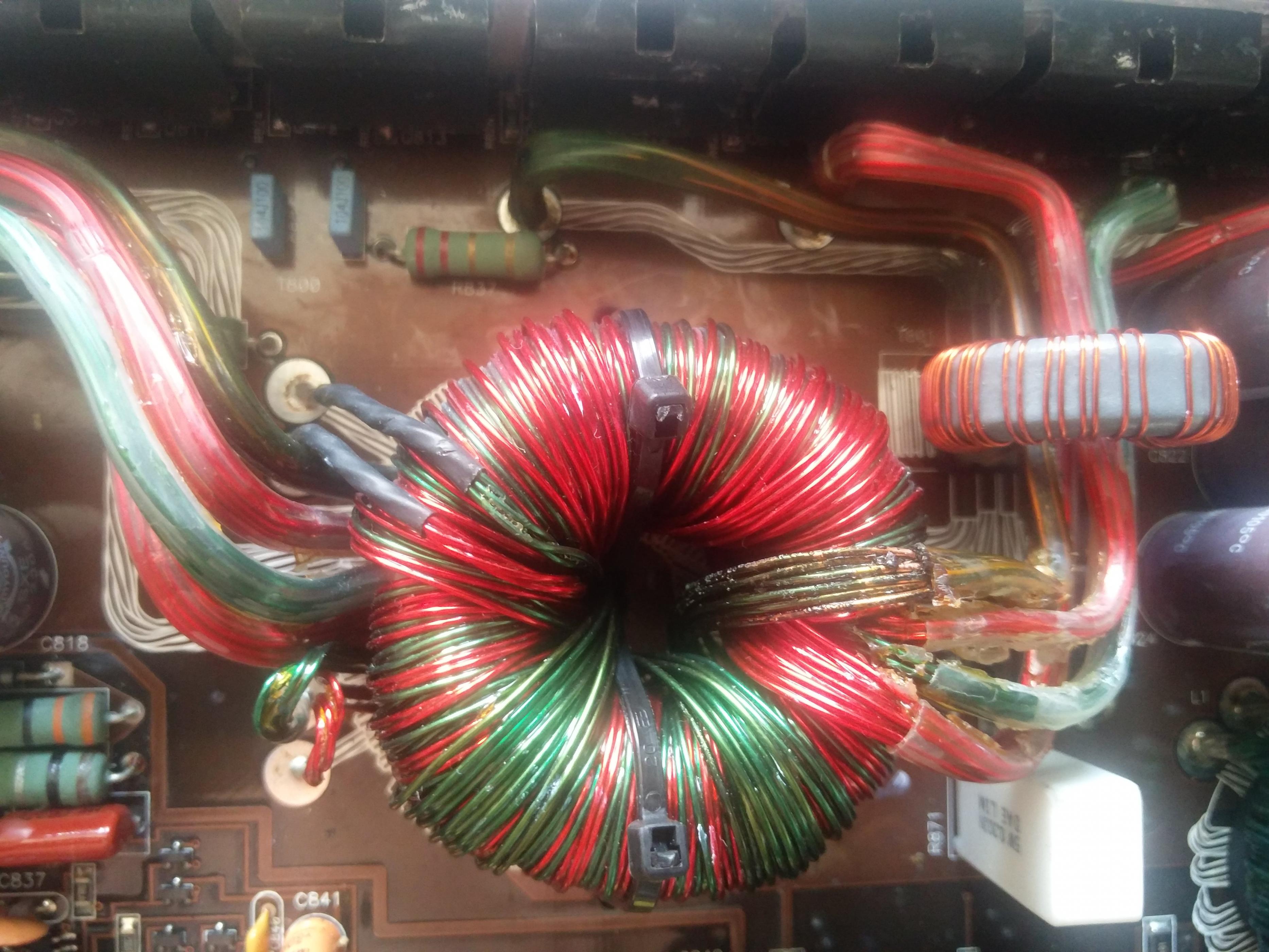

Decided to test my previously repaired but properly working 1000/1 in my Subaru before putting my system into my newest vehicle. Unfortunately, the Subaru only has 8 gauge power and ground wires. I didn't play the bass hard but as I turned the volume up, the amp's green power light turned off and the blue low voltage light came on. By the time I made it to the back to check the amp, it was very hot and the + power wire was so hot the sleeve started to soften. I removed the wires from the amp and it remained very hot for a few minutes until it cooled down.
When the remote lead is powered, the green light comes on and goes out as the blue light turns on. This cycle repeats until the remote wire is removed. I am getting -15v and +13.8v at the op amps and low voltage power supply. There is also regulated 5v as well as +37v on the diodes by the low voltage supply.
None of the PS FETS or outputs are shorted or give readings indicating damage. The rail voltage only gets up to +4v before shutdown occurs and the cycle repeats. During this testing, the amp's current draw is so high that the red+ power wire moves as the amp attempts to turn on. This amp has IRF3709Z with 22ohm resistors in the power supply that were working well for a few months

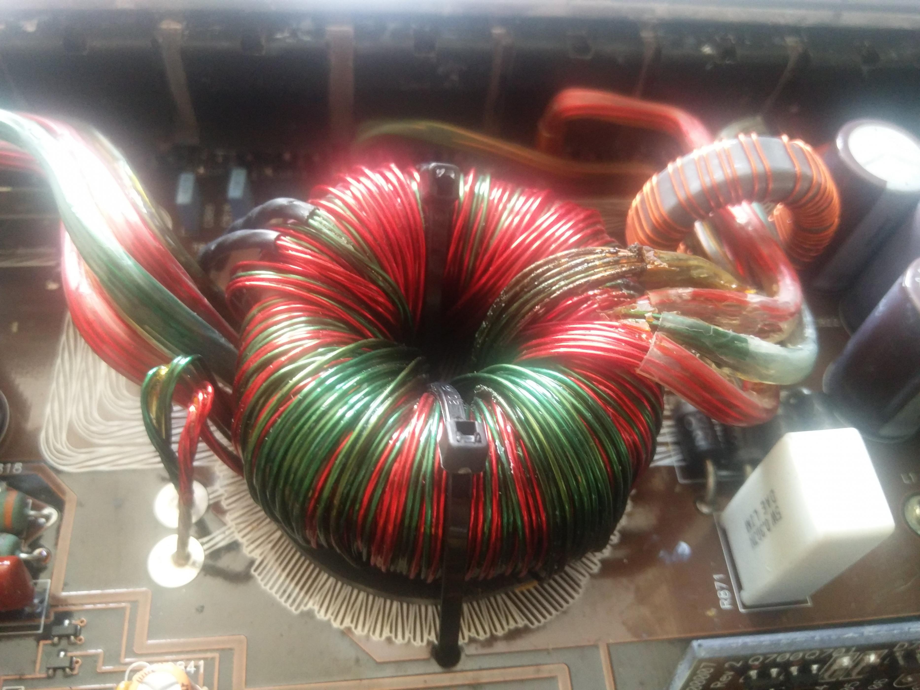

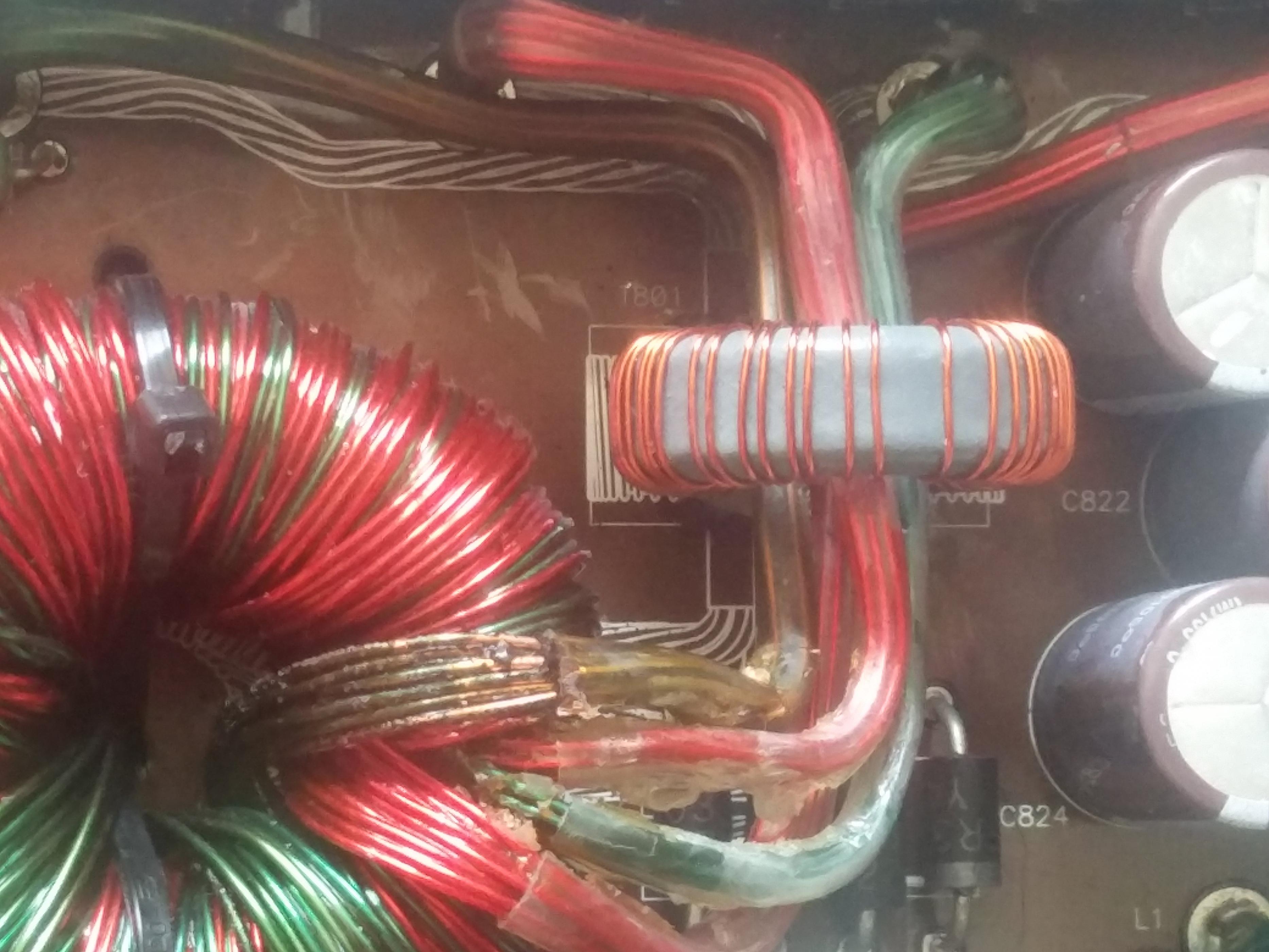

I am uncertain if the toroid is damaged as the rubber coating had somewhat melted during this incident. I am posting some pics.

Just scanned the list of amplifiers that JL Audio will repair, and the 1000/1v1 is not on the list. Also, I do not possess the original sales receipt. Looks like I will either have to attempt the transformer repair or sell the amp for parts if it is unrepairable...Can't believe the amplifier self-destructed/was destroyed so easily...

Just discovered Q504 shorted on all 3 legs. I don't recall any shorted outputs when after the incident occurred but I may have been flustered and did something incorrectly.

The mismatched readings on 506 and 507 caused me to investigate further and I discovered that the gate of these two had Ground on them. I traced the gate circuit back to U502, a TC4420E IC mounted just in front of the output driver board. This IC has pins 4, 6, 7 and 8 shorted together. I assume no further testing can be done until this part is replaced.
