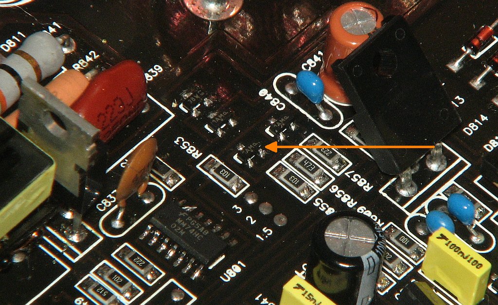

Post the DC voltage on the pins of the 10 pin connector.

Nothing there seems to be causing the problem.
Look at the signal on those two small driver transistors near the FET for the small transformer. Do you have a good drive signal there?

Did you check the drive signal on the driver transistors?
I see no drive pulses on the drivers no pulse on the tab of the get also do not have regulated voltages still
