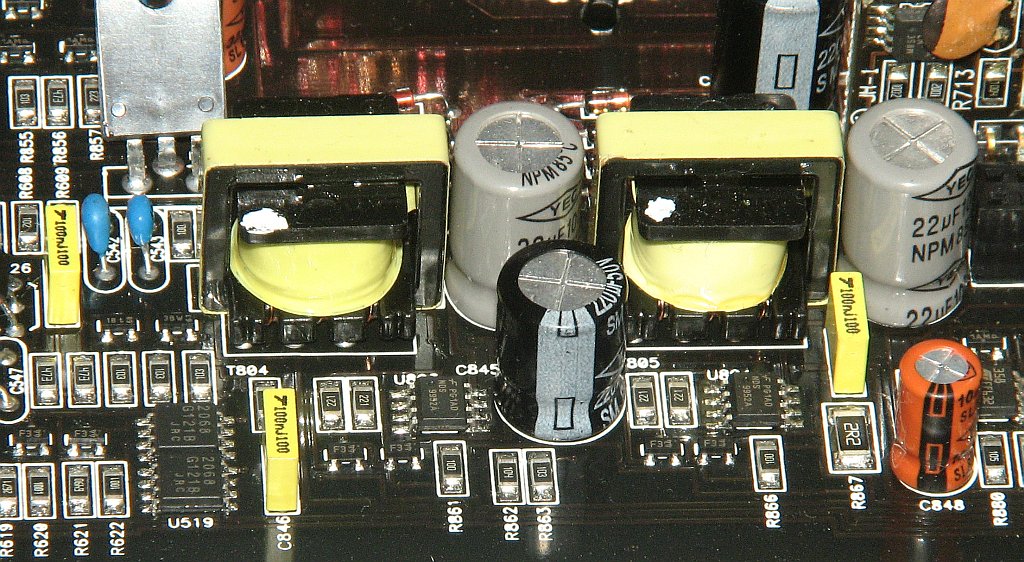

I believe U804 is defective.. LM358
I know theese are avaible is there any good subs i can stick in the amp for testing or not?
Ill order a few of thoose and replace them..
Also is there a good replacement for the IRF3307's or do you know where i can get them?
Not sure if whats in the amp is orginal or not but the part number on theese power supply fets in the amp now say IRF3707
Board is rev3
Board is rev3

They appear to have been replaced at some point in time..
I found 1 of them with a broken leg on it the leg was broke at the body of it ..
So i wanna replace it So was wondering since 1 of them had a broken leg should i replace all of them or how many do i have to replace ??
Also wondering if i should stay with the 3707's or switch them out since the 3707's are non stockd from the places i usually order from..

Mouser and Digi-Key have the IRF3707Z which should be a good replacement.
The newer version (1200/1) uses the IRF3709Z. The drive circuits appear to be similar. I would expect them to be suitable subs but I've never tried them as a sub.

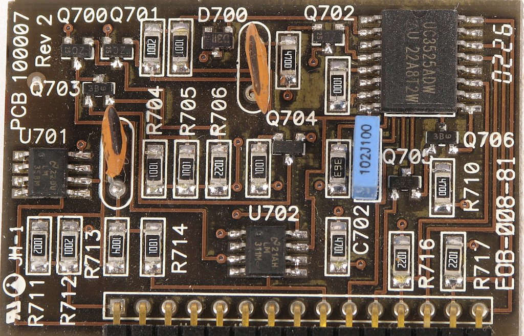

Perry,
Do you have a high res pic of the power supply driverboard??

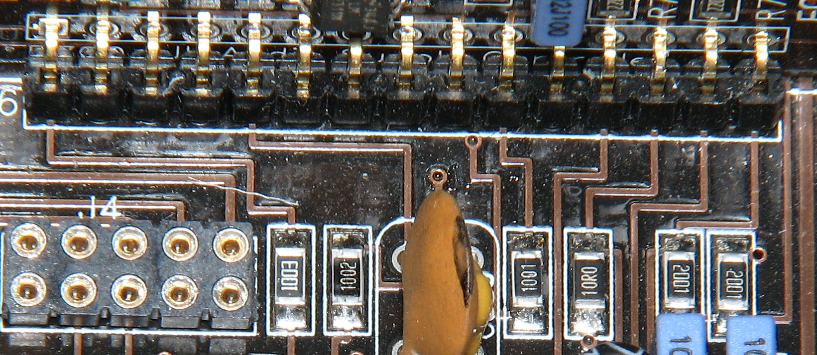

Aslo a high res pic of the resistors that sit directly in fron of the driverboard??
2 resistors in front of the driverboard are burnt..
The blue cap on the driverboard appears to have been touched with a soldering iron and it melted i wanna replace it but dont know the value..

Before you replace all of the power supply FETs, I'd suggest installing the drive ICs to make sure that the driver transformers are not defective.
Once i install the drive IC'S how do i tell if the transformers are defective or not??
Do i just check the drive signal on the gate pads?
Checking the signal and also seeing if the IC operates at a significantly higher temperature than the other one.
