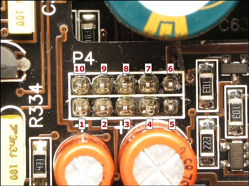

1:0
2:-4.57
3:12.32
4:11.19
5:0
6:13.11
7:0.26
8:0
9:12.78
10:0
R309 and R231 on this board got so hot they unsolderd themselfs from the board

Double-check the boards to make sure that the headers are not misaligned.
