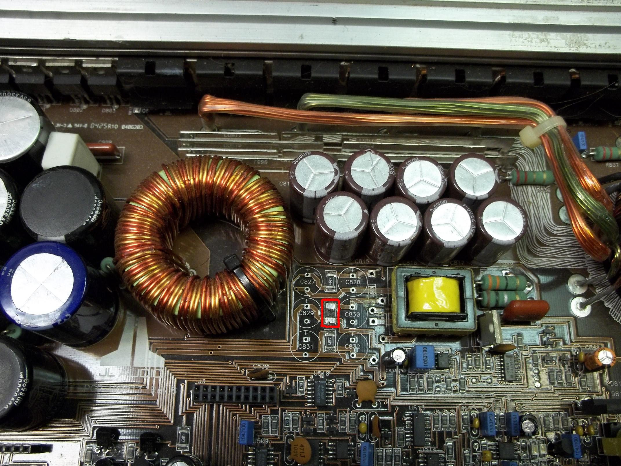

Got 1 of theese in for repair. Its missing some parts. Wondering if someone knows what parts go in the following locations and have any part numbers?
D81:
D810:
D809:
D808:
C831:
C829:
C827:
C832:
C830:
C828:
Then between the caps there are Resistors I believe they are 1210 package there are a total of 3 1 is missing and the other 2 are out of tolorance.
Heres a pic:

D811 is an SR106
The other 3 diodes are SFR104s.
The center resistor is 2.2 ohms
The caps are 220@63

They should work. I don't have a part number for the resistor.
The 647-UPM1J221MHD may be a better choice (confirm that they'll fit before ordering). Low impedance caps are typically a better choice for switching power supplies. Again, the ones you listed would probably OK.

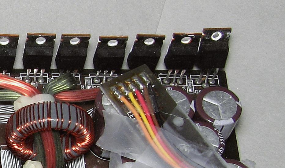

Ok thanks next question is on the led board (power light protections ect) there are 5 wires that solder to it THe yellow and orange wires are still attached.
the other locations are 1,2,3 and i have a red,brown and black wire do you know what order they go in?
See attached.
When working on the JL amps, I tape the boards to the top of the capacitors (the LEDs drop between the caps). This keeps them out of the way and prevents them from shorting out to the main board when working on the amp. If you look closely, you can also see that Goop has been applied to the wires to prevent stressing the wires at the point where the insulation stops. This prevents them from breaking.
