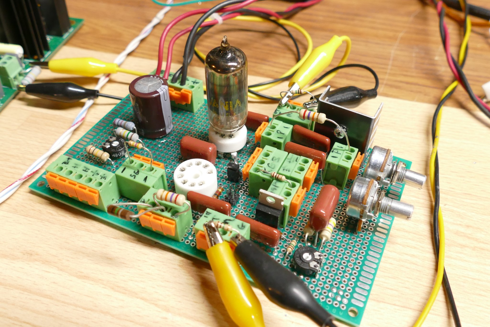

My brilliant idea was to rip one in half lengthwise along the existing groove, so I could put a pair of tube sockets in the middle and mount all of it to a small piece of PC board stock.
Hey, not so bad - just needed to successfully get that board in half. Down the groove where the DIP ICs sit across, right? I bet with a reciprocating blade and a nice score down that sticky back stuff you could get it cut clean.
Yes, I wound up clamping a jig saw in my old Black and Decker Workmate with its blade pointing up and zipping right through a second better quality Amazon sourced board. The fine tooth blade didn't even mess up the sticky stuff. The whole idea wound up in the trash anyway, which led me to the design I have now. it's more old school breadboard style with easily replaceable parts. The two tube sockets are wired in parallel so I can test 7 pin and 9 pin tubes in it.
Member Windcrest77 found these neat little spring loaded connectors for quick changes of small parts, or even minor circuit rewiring. Info is in post #77 of this thread:
https://www.diyaudio.com/community/...obby-the-way-i-always-wanted-to-do-it.410333/
