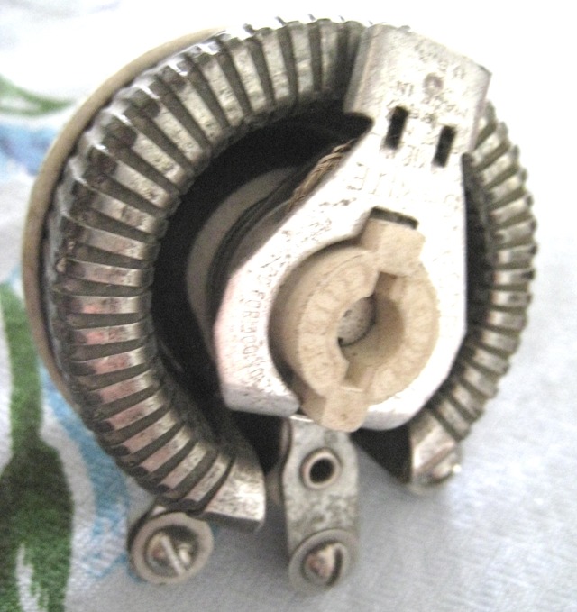

I have a gang of 3, 25 Ohm pots I pulled from some home theater passive surround box I snagged at the thrift store. I've wired all of them in parallel to make an ~8 Ohm resistive load, then connect the speaker to the wiper. Turned toward the ground side, it beats listening to my failing experiments with the speaker connected straight to the amps output. I'm going to have to find a place for that to mount permanently in my cabinet, along with a switch to disable the loading and let the speaker instead have 0 - 8 Ohms in series. It'll be great to simply reach under the bench and turn it down to a tolerable SPL, with the amp still running full blast and "properly" loaded.
Done!

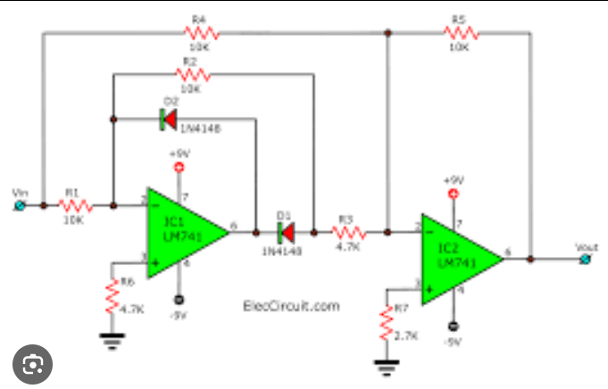

Last night, I put together a simple V-D power supply running off the 6.3V grounded center tap winding. Plan is to build a side chain of op-amp based signal derivation circuitry to drive the Vactrol. It's going to be my old, college daze op-amp full wave rectifier, where I graft a second order state space filter onto where the "stock" 1st order op-amp filter sits. This offers a few advantages -
Since the output of this is just a DC control signal, maybe 300 uA at the most, intended to drive the Vactrol or other LED based resistor, it's completely out of the path of the guitar signal's all-tube amplification. A true side chain, as long as I tap its input signal in an unperturbing way. Probably through a 1M resistor...

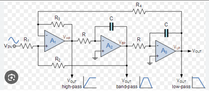

- You can get a faster response, by setting the filter frequency and feedback just right; in the "critically damped" region.
- You can get a Tremolo by setting the feedback such that the 2nd order filter oscillates continuously without input.
- You can trigger decaying oscillations with your guitar playing, operating it in the "underdamped" region.
- You can use the LP output for an envelope with a LF warble on top, or the BP output for just a "triggered" warble.

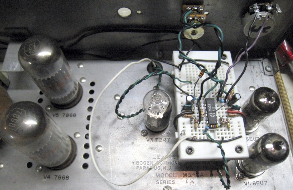

I got my solderless protoboard and mounted it using the standoff it came with between the tubes;
All the circuit does is take one of two output signals from the first tube - the LTP phase splitter - and full wave rectify it, while filtering the resulting envelope second order, then drive the Vactrol. The white wire is the Vactrol output I brought up so I dont have to turn the chassis over every time I want to look at the actively attenuated audio signal.
I made an offset circuit using an LED slightly illuminated from the (-) supply to approximate the drop across the Vactrol LED. So I can get current through it from a ground referenced positive going control voltage. The Vactrol LED cathode is connected to the cathode of the lit LED - a node about -1.7 V below ground. I certainly have space to do it in a better way, but, works for now!
The effect is definitely compressor like, with a bit of tremolo added on top if you like. I've listened to the amp swell back and forth between single ended and P-P so many times; so glad I have that power soak resistor on the speaker. It's a nice subtle effect, especially when the tremolo swells are well into the subsonic and match the rhythm of chord changes.
The controls are Tremolo frequency and the filter "Q"; still working on the range of each. Changing Q allows the circuit to operate between an ordinary compressor type effect to having decaying swells added on, to having a constant tremolo effect. Tremolo from SE to P-P, that is. I'll work on getting some scope captures posted next, as I develop the controls range. And my hands, playing electric guitar.

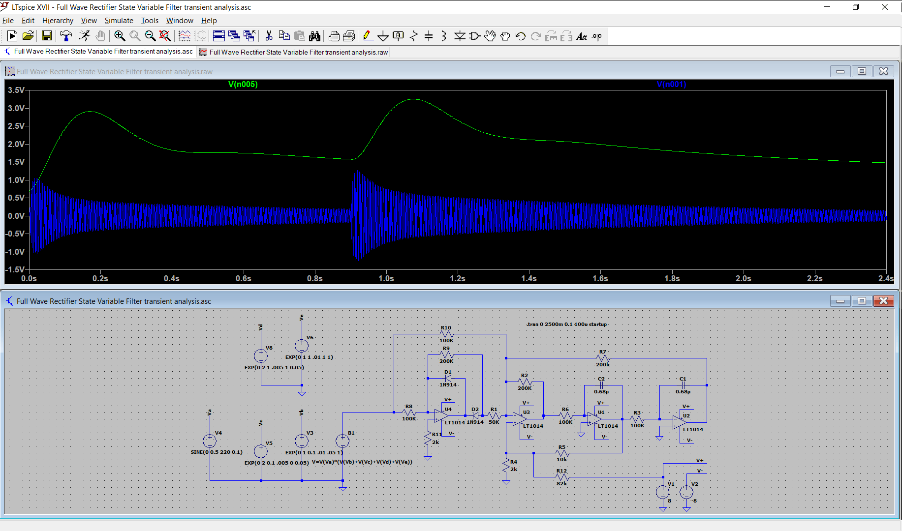

Simulation of the graft of the above two circuits, showing the LP output in response to my simulated guitar pluck waveform. Added a little offset to get the Vactrol diode past its forward drop. Positive going voltage clamps the Vactrol's resistor output shut.
You can get a faster response by reducing R6 and R3. You can get cyclic behavior by increasing R5, the "damping" resistor. I first built this when I was in college, controlling a VCF, to get a wah-oo-wah-oo-eeeaaoooww, sound. It remains to be seen if I can get anything musical out of this, squashing one side of the drive to a P-P to get SE and back.
I find when I play, I naturally ride my "phrasing" on a time constant if I can sense one. This has happened with reverb/echo times and compressor time constants. (also happens over the rate which I can close the fingers of my left hand, which is not instantaneous these days) It may take a little time to see if I "like it" in a similar way.
I've attached the LTSpice asc file, for anyone who want to play with the second order envelope filter control voltage generator. Drop a reply, let me know what you think. A third integrator, that flips the inflection after the hump?

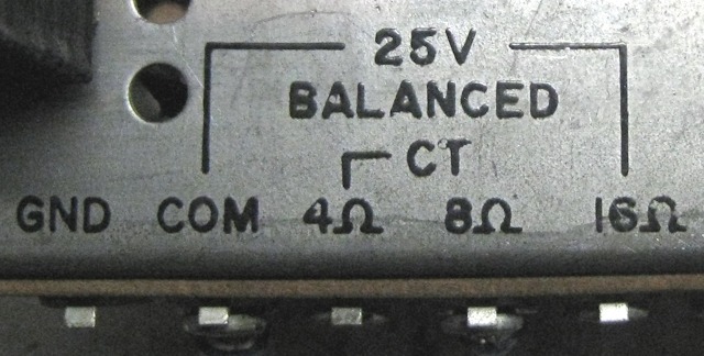

I did some "cleanup", since I had made the voltage doubler +/- supply for the op-amps, I fed the current sink I'm using in the LTP from the -V of that, instead of a whole second independent AC powered -5V source, which I've now removed from the amplifier.
Observing -
I thought of chassis grounding the "CT" instead of "COM", which would give me +/- about ground for a differential feedback source. So I implemented a feedback from the OPT secondary through a 22K to my driver tube's cathode 1.8K resistors;
The amp seems to play just fine with this in place; 50/50 shot at getting the right phase going to the right driver section. So, you CAN do differential feedback from a 0-4-8-16 secondary winding OPT. Obviously the key to it is having the 16 Ohm tap in place, though I bet you could use the 8 tap and just attenuate the 0-4 winding output to match.

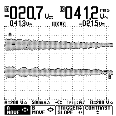

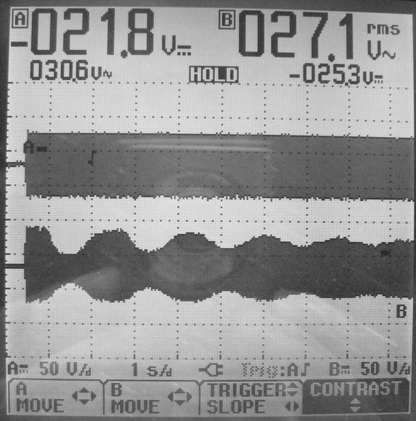

Scope shot of the two differential signal coming to my power tube's input, one of which has the Vactrol squashing its level.
(Apologies for the crappy shot; I'll be going to photographing the scope screen instead of a stupid long file transfer and rendering process)
Open E on the electric guitar. You can hear the effect. It's like a triggered tremolo. You easily can play on top of the volume swell rate.
I know I need to do a better job on gain and offset control for the drive to the Vactrol's internal LED. That'll be 4 parameters, with only 3 holes in the panel; Modulation Frequency, Q, Offset and Modulation Level... The 300 ms delay before the volume starts squashing need to be looked at as well. All Fun!
Using the camera; step input from the function generator this time.
I'll never get the reflection of my hands/camera out from the (^%&* mirror-flat shiny-screen surface...

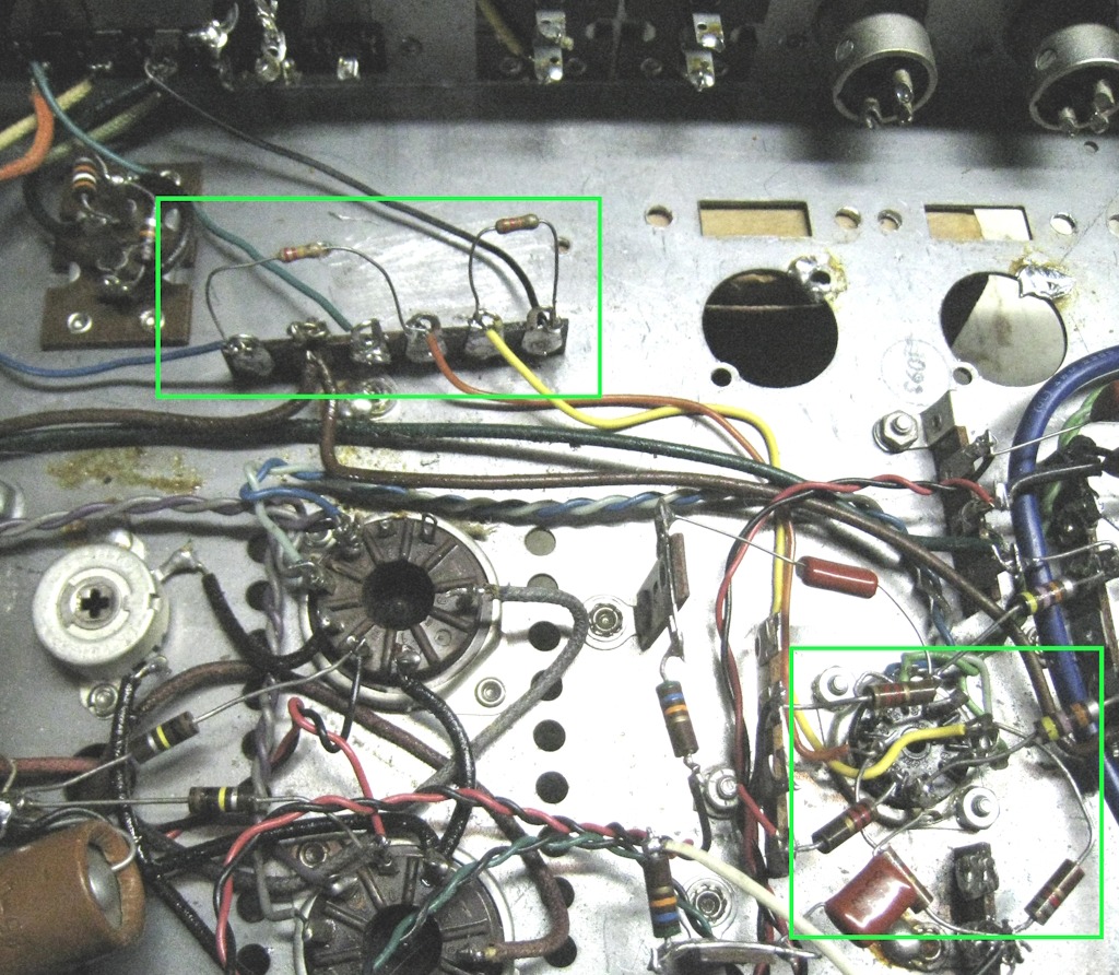

I moved the Vactrol 5C3 pair to the input phase splitter LTP, where it now connects across the "pre" volume control inputs to ground.
I also made up a circuit card with the full wave bridge, a 3uf, 220V cap and a 150 k bleed resistor. The Vactrols dont need much current at all to effect the signal level going into the dual gang pre volume. With the signal level I'm getting out of the 70V secondary winding, a 3-5 Meg series resistor will light the LEDs enough to effect the level.
This is called a feedback design, as the output level controls the gain reduction at the input. Previously, I had implemented a feed-forward design, as the input level controlled the gain reduction at the output tubes. At this point in time, I dont know which is a "better" topology, given there's issues with each that obscure and even field comparison.
What I see looks like a triggered instability that decays into nirwana,Using the camera; step input from the function generator this time.
like the pulse response of a resonant circuit with a certain Q-factor.
Furthermore this is an amplitude modulation.
Very likely some supply voltage is involved (poor decoupling).
