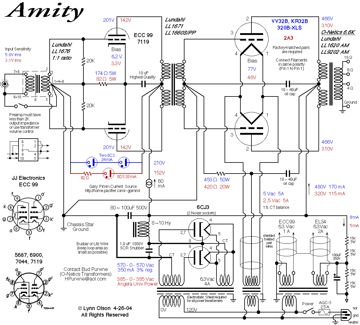

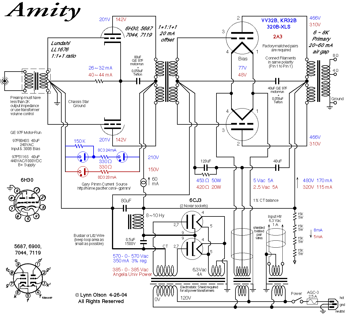

JJ 2A3-40 for Lynn Olson Amity
I just received a circuit diagram of Amity and both from the same date.
Both Lundahl LL9202AM and LL1620AM are adequate for Amity application. But I wonder which one is better for the application.
My friend says both Lundahl transformer can be made with air gap.
Any thoughts??
