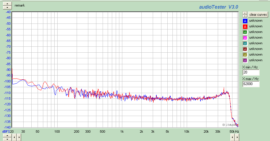

You are saying noise in the PC (to be precise on the PSU) is HF?So you have actually measured it?
Your measurement shows a level of around -105dB for LF noise (frequency is hard to tell), You can work out what SNR and hence resolution this gives.
With that, I'll bow out until someone wants to have an honest discussion.
Oh come on, you post a measurement result, deliberately shown in a non-standard way to obscure low frequency noise. I told you what that noise level is. If you don't like it, ask your money back.

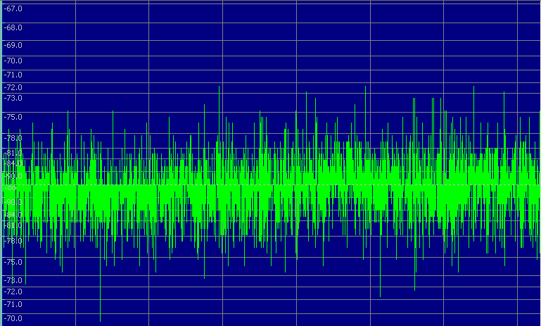

AKAIK, that is the way the software displays it. It can just do other units, not other scales. For comparison - below you will find my built-in Realtek soundcard on my desktop computer. The mixer is set for line in, full on. I scaled both the same for a reasonable comparison.

Not sure what you mean there, but to me the misleading part of the spectrum analysis is the low noise floor. Yes, it's that low at any given point, but overall it's about -77dBFS on my card. See waveform below.
Pano: Noise floor and signal to noise are very different animals. Same with resolution. When we mix them up, it tends to obscure the basic points. -105dB unweighted signal to noise is quite acceptable in audio gear, far better than most audiophile gear manages. Resolution is quite a bit better than that. The highest noise component is a 120Hz spike (which may originate externally, don't know, don't care) at -120dBFS. PCI cards apparently do not have to be as noisy as people worry about.
Your cheap soundcard's S/N is probably working at the edge of audibility- if it were a high end phono preamp, that number would be impressive!

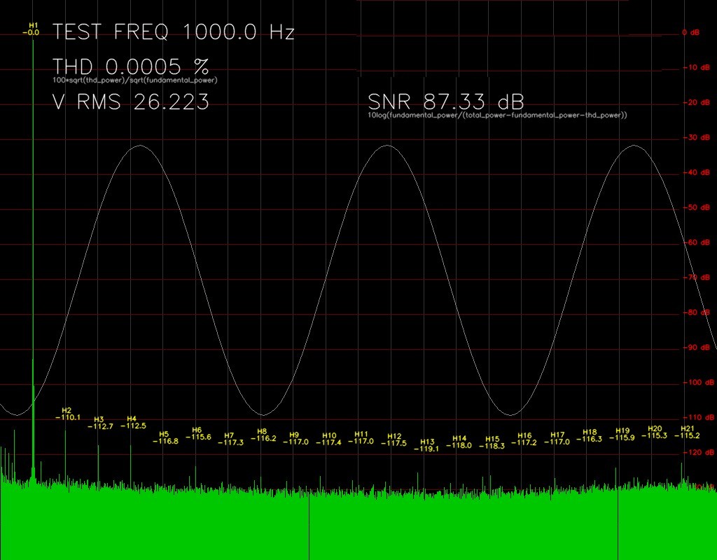

I did a test on my M Audio 2496 sound card a while ago. I was intending to measure a power amplifier's performance but also did a loopback test with a 16 bit 44.1kHz 1kHz sine wave. I read somewhere that distortion is usually lower with sound cards at reduced output amplitude and I certainly found that 50% gave me significantly lower distortion, although it must have reduced my signal to noise ratio, too.
Homebrew software, so not presenting the plot in the 'official' manner I expect, but I believe the displayed figures are correct. Based on a large FFT averaged many times (I can't say how large and how many at the moment!) and a simple raised cosine window. Using 'several' bins on either side of each harmonic to accumulate the harmonic energy. Using everything minus the THD components to calculate the SNR relative to the fundamental.
The loopback cable wasn't cotton covered silver I'm afraid, so no doubt a heavy performance penalty there.
(Forget the VRMS figure - it was for the power amplifier output after an attenuator not used for this test)
