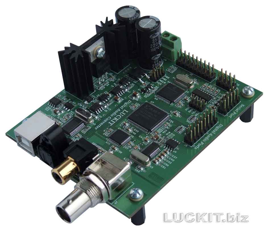

   Hello,
 this is my test board which I made last year. It uses SRC4392 as S/PDIF receiver and jitter cleaner, the Master Clocks being provided by the on-board PLL1708. I know that it needs some customization to improve sound quality at its outputs this is why I would be happy if you could give me some advice or share your impressions with me.
 Best regards,
  Lucifix
