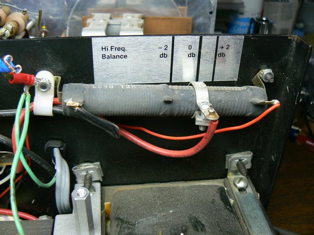

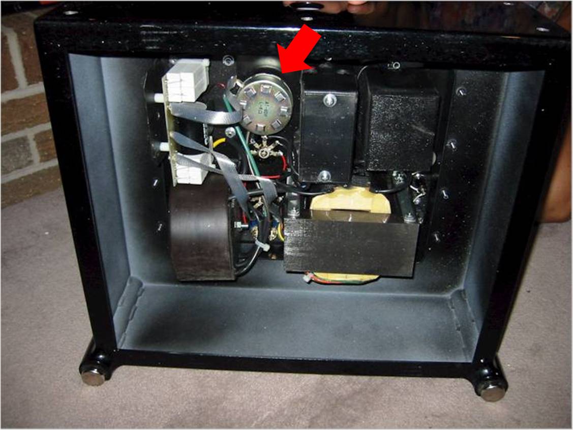

Later Acoustat interface units used adustable power resistors like that shown in Attachment 1. A German ESL manufacturer, Capaciti, who posts on this forum from time to time provides binding posts on the back of the interface box of their Element 160 where you can attach the damping resistor of your choice. See Attachment 2. I believe Sound Lab still uses potentiometers in their ESL interfaces to adjust the high frequency response. See Attachment 3.
thanks for those shots!, Love the first one, is that washer looking thing on the pot the wiper?

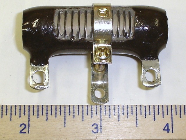

The washer is an adjustable center tape that is clamped in position. Attached is a close up pic of a similar adjustable power resistor.

For DIY purposes feel free to use an EQ to compensate for the roll off if you desire, especially if you will already be using one to flatten the falling low frequency response due to dipole roll off and possibly for crossover as well. However, it is still good practice to put at least 1 ohm of resistance in series with the primary of your step-up transformers to protect the amplifier from trying to drive a short if the transformer core saturates.

BOLSERST in post 28 of yours image one, the acustats pot, how hard is it to get to, to adjust it? Do you repair as hobby/passion, or professional? I enjoy fixing vintage audio stuff. Thanks again for taking the time to post those shots. Be well.
The Acoustat damping resistor is easy to adjust as it is at the top of the interface box.
Simply loosen the screw holding the moveable clamp, slide it left of right depending if you want to boost or cut the top couple octaves, then tighten the screw.
