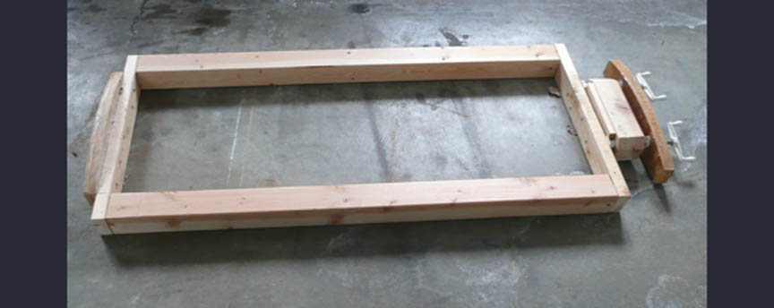

Mark I will take some photos and post. I followed Sanders "plans" for the form to attach the spacers and impart the curve to the stators. However, for the stretcher part, I did not follow his method, but rather built a large stretcher frame with ends that had the same radius as my panels and used veneer screws to move one of the ends to tension the diaphram. It is important to only stretch lengthwise, and just provide enough tension on the sides to remove wrinkles.

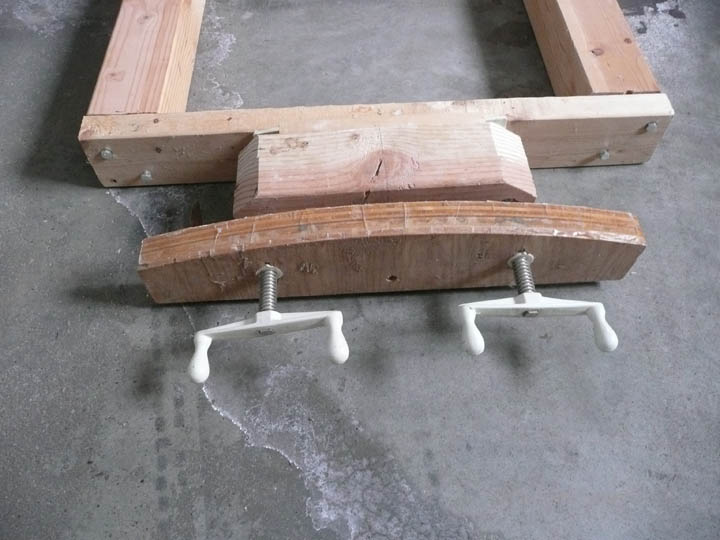

I have attached three photos (or at least tried) showing my stretcher, detail around the use of the veneer screws, and stretcher with the "table top" as Sanders calls it. The stretcher is about 50% larger than the stator panels. Curved diaphragms, which are only stretched lengthwise, develop and "hour glass" shape. To minimize this effect, only the center portion of the diaphragm is used. In my case, I used perforated steel that was 40" long, but from end to end my stretcher is nearly 72". I use carpet tape to attach the membrane to the ends of the stretcher, then using the screws in "reverse direction" stretch the membrane over the "table top" about 1.5%. Using very slight pressure, I pull the membrane to the sides with tape to remove any large wrinkles. Once the membrane looks smooth, I lay the outside stator on top of the membrane (which has double sided tape over the spacers) to attach the stator to the diaphragm. Hope this helps, jerry

Thanks everyone for your very kind comments. Yes I am using 6 micron mylar film. I forgot to mention that my stators are 12" wide, but the stretcher will hold 19" wide film, again to minimize impact of the hour glass effect. I am still constructing the speakers, so do not have any final photos. I have one panel completed (and will use your suggestions for mounting Charlie). At present, I am working mostly on the cabinets for the woofers - it will be a hybrid system. I live in the US-Midwest where temperatures are freezing - so I will either need to wait until it warms, or bring the stretcher inside. Following suggestions of others here, the tape adheres best under warm conditions. I will post pictures as I complete them. I have been a member of this forum for nearly 5 years, and have really appreciated the suggestions and ideas that members have shared. Hopefully I am getting to a point where I can give something in return. Jerry
