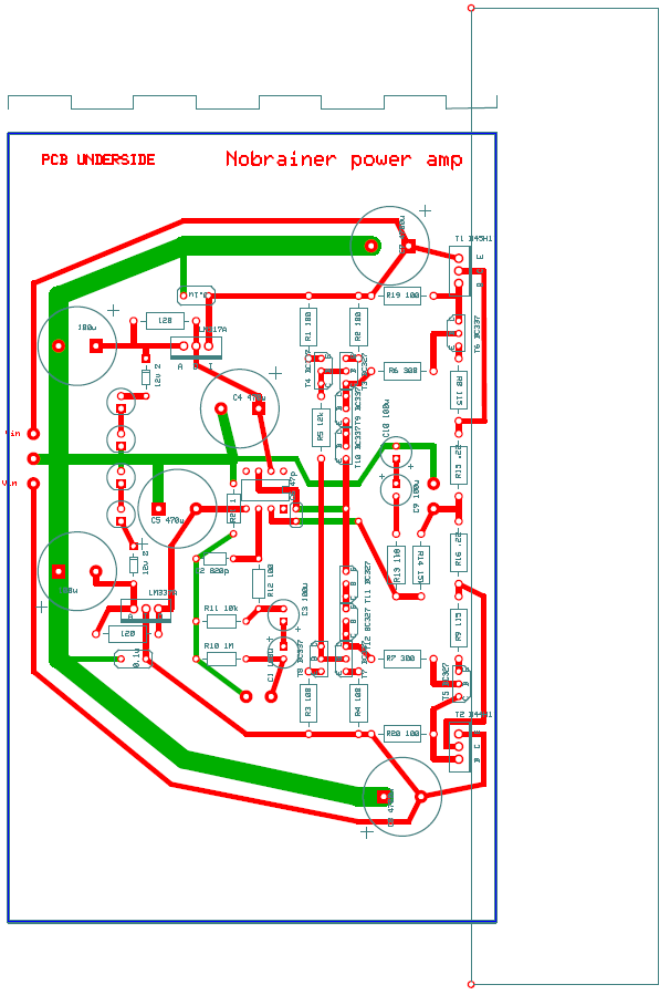

Here you have my latest layout.... Please disregard the previous ones that might have errors in the output stage connections.
I would just appreciate your comments on the placement of the parts and particularly on the GND layout and smoothing caps.
I will off course study the pinouts carefully before implementation.
Does this design ever work in class AB ?

At first glance i would do the PSU and ground traces quite a bit thicker.
Well, where does Class B stop and Class AB start ?
The only " hard " Class B HiFi Amp i know is the current dumper in the Quad 405 ( and siblings ). There is absolute no bias i think. Even the small bias i use in the Szikley output stage of the Nobrainer amp i consider as Class AB. Curiously when you read Self a Szikley has minimum distortion at very low bias. He shows that graphically as the waveform in transit from the NPP to PNP output transistor. When you " over bias " a Szikley, the distortion goes up. Unfortunately he does not show an FFT spectrum so it well can be that mostly second rises when you go from say 15mA to 125mA of my prototype. That can sound " warmer " or " better " although THD as such goes up.

The output stage of the Nobrainer is different. It is a CFB pair or Szikley.
This variety is best covered in Douglas Self´s book " Audio Power Amplifier Design ".
