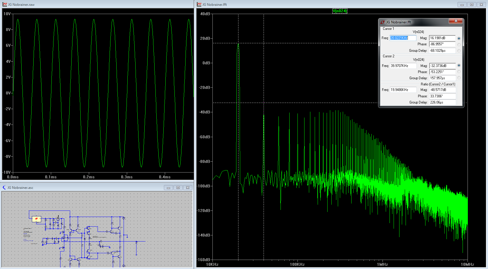

This is the circuit from #288, bias 10mA to 1.2A 🙂 as you can see (until 1.2A is set) there is not much difference in the FFT for the set idle current. This is all at 1Vin and 20Khz giving 5.5Watt out (very modest power setting). The picture shows the 2nd harmonic (and it is huge IMO).

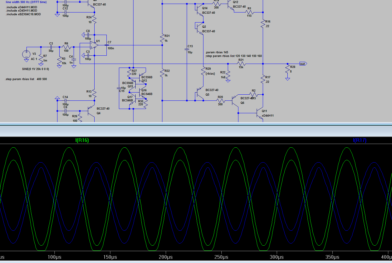

With resistors ranging from 100 to 150 ohm I get idle around 500mA but strangely the current is not the same on both emitter resistors r16 and r17

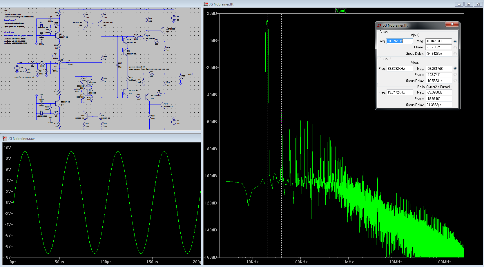

Keep the resistors around the bias generator (and the capacitor) it makes for a nice symmetrical drive. I made some changes to the PSU's and added a CCS to feed the mirrors, the 20K 5.5W FFT looks better 70dB now. I also added new D45 and D44 models. idle set to 100mA. More work to be done... 🙂 can you see it?

Be warned 🙂 the PSU is 35+35V = 70V 😀 the BC546/556 are 65V this is borderline. Drop the PSU to 25+25V the amount of power will be the same (and I think) it also makes no difference on the FFT.
P.s. I just checked, 25+25V is fine, the bias resistor should be 150 Ohm.
